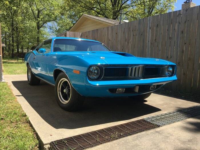

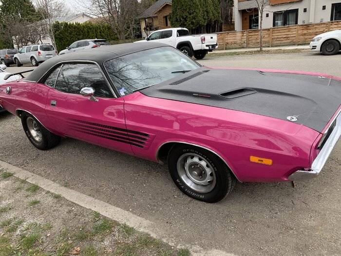

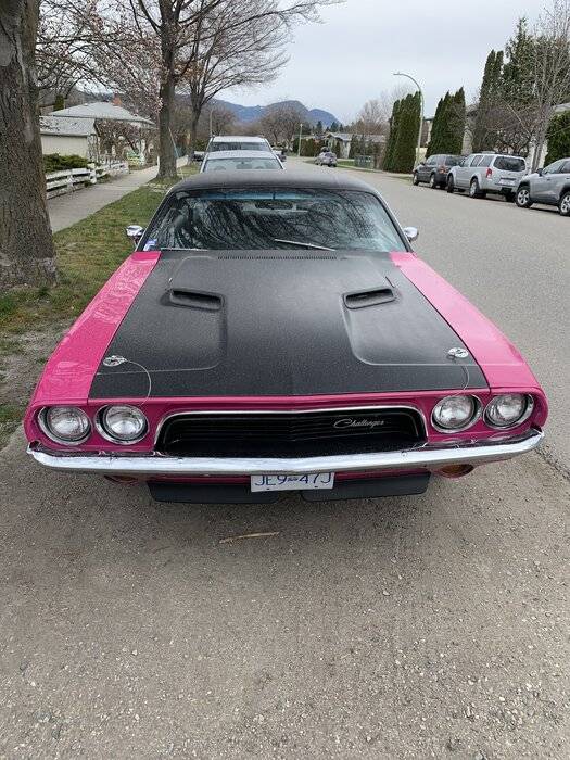

here is the car 74 rallye 360/4 speed...slowly going back to factory , rally red, white top and interior

I have seen the pics on the site. Super nice ride!

Being a 74 it’s not the most popular choice of years, but the body is super clean and being a 360/4 speed from factory was a cool to find.
looking forward to getting the 4 speed back in!

Yes sir! That’s a keeper no doubt. Those are/will continue to be valuable cuz they didn’t produce that many.
