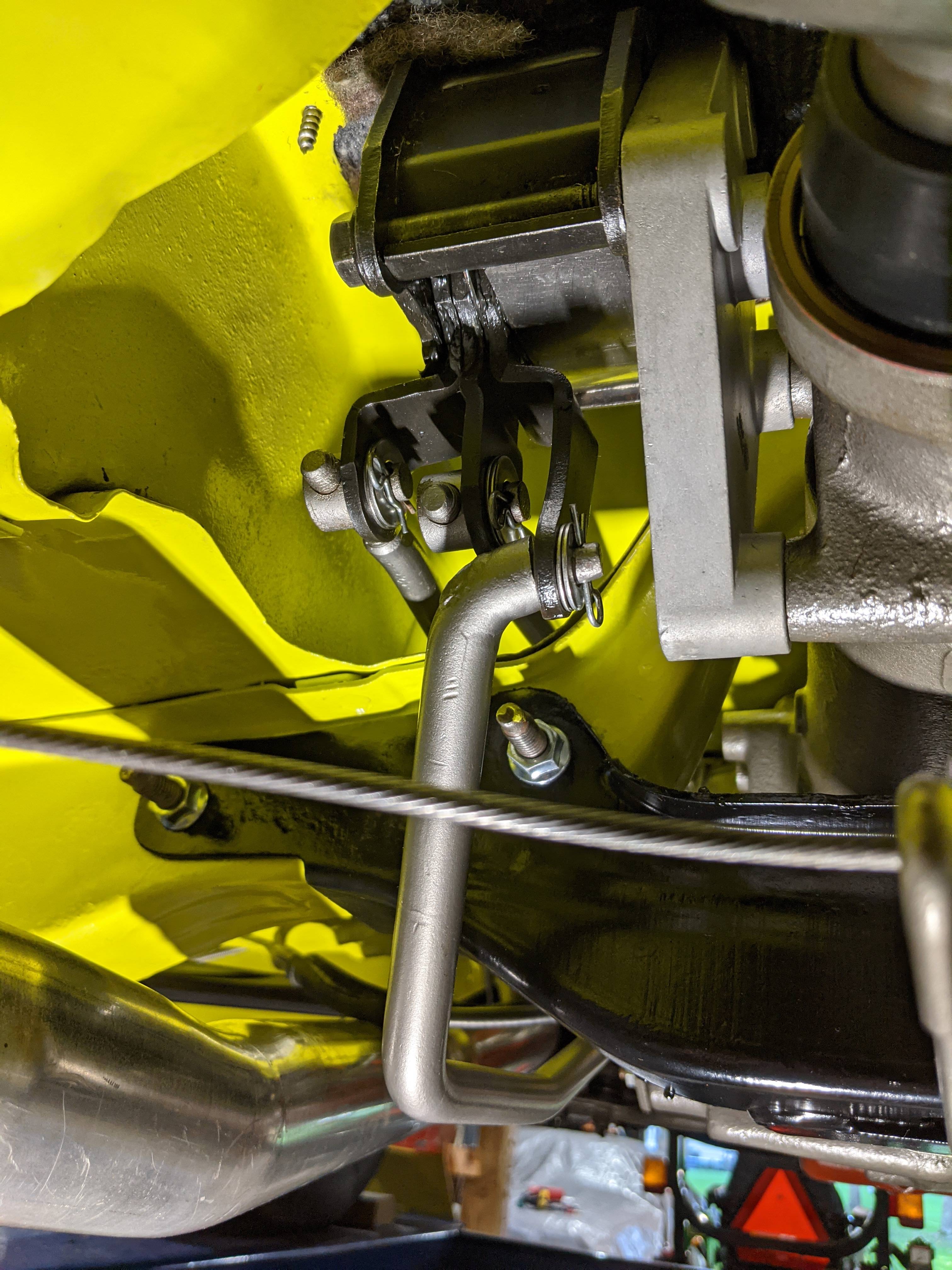

I have a 1973 Challenger that was converted from a 340 automatic to a 383 4 speed. Looking online I find there are two sets of rods available based on model year. The engine was cast in '67. The trans was cast in '69, and has the tailshaft with dual mounting points. It has a Hurst shifter. The current reverse rod looks more like the 1970-1972 pictured below. BUT - it is also hangs down so far as to be the lowest point under the car and is so sloppy that it can swing side to side enough to hit the exhaust system.

Ive had a few 4spd E bodies over the years and I have never noticed any differences in the rods, however that absolutely doesn't mean there isn't any. That said, the 4spd rod sets I think would work either way and I think the "70-72" set is to allow for the Hemi 4spd which has a fatter case.
Chryco Psycho
4,893
2,515
Panama
I see no reason why either would not work , the park brake cable system & Routing changed in 71 possibly part of the reason for the J shaped reverse rod , all of the levers on the trans should point up from the pivot . I don't recall the reverse rod hanging that low .
All 833 cases are the same size but the brgs & internals differ , the trans used a ball detent in 70 & levers in 71 up as well as the 70 TA / AAR .
The chassis didn't change either in the 5 years .
Brewers may have a clearer explanation for the design change .

Reply from Brewers: Either shifter rod set will work on the E body, the only exception for the LRS-BE kit is that using an “H” pipe in the exhaust it can hit, and requires the earlier Rev rod in the LRS-E kit.
