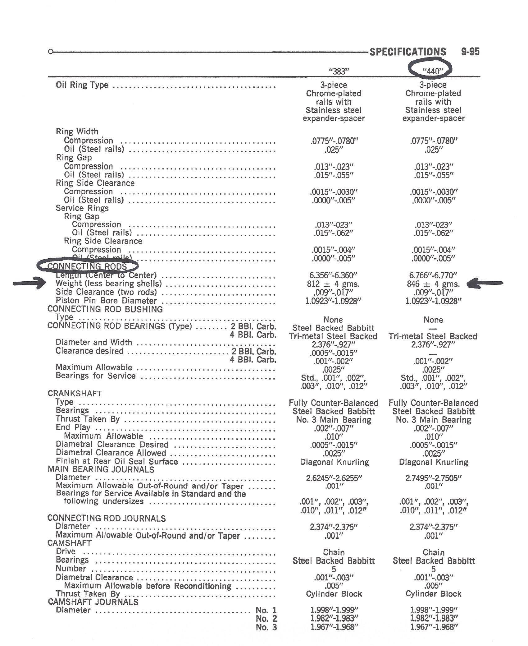

the rod weight was kinda an afterthought when I was contemplating piecing together the bottom end and was wondering how some of the aftermarket rods compared to factory rods.
