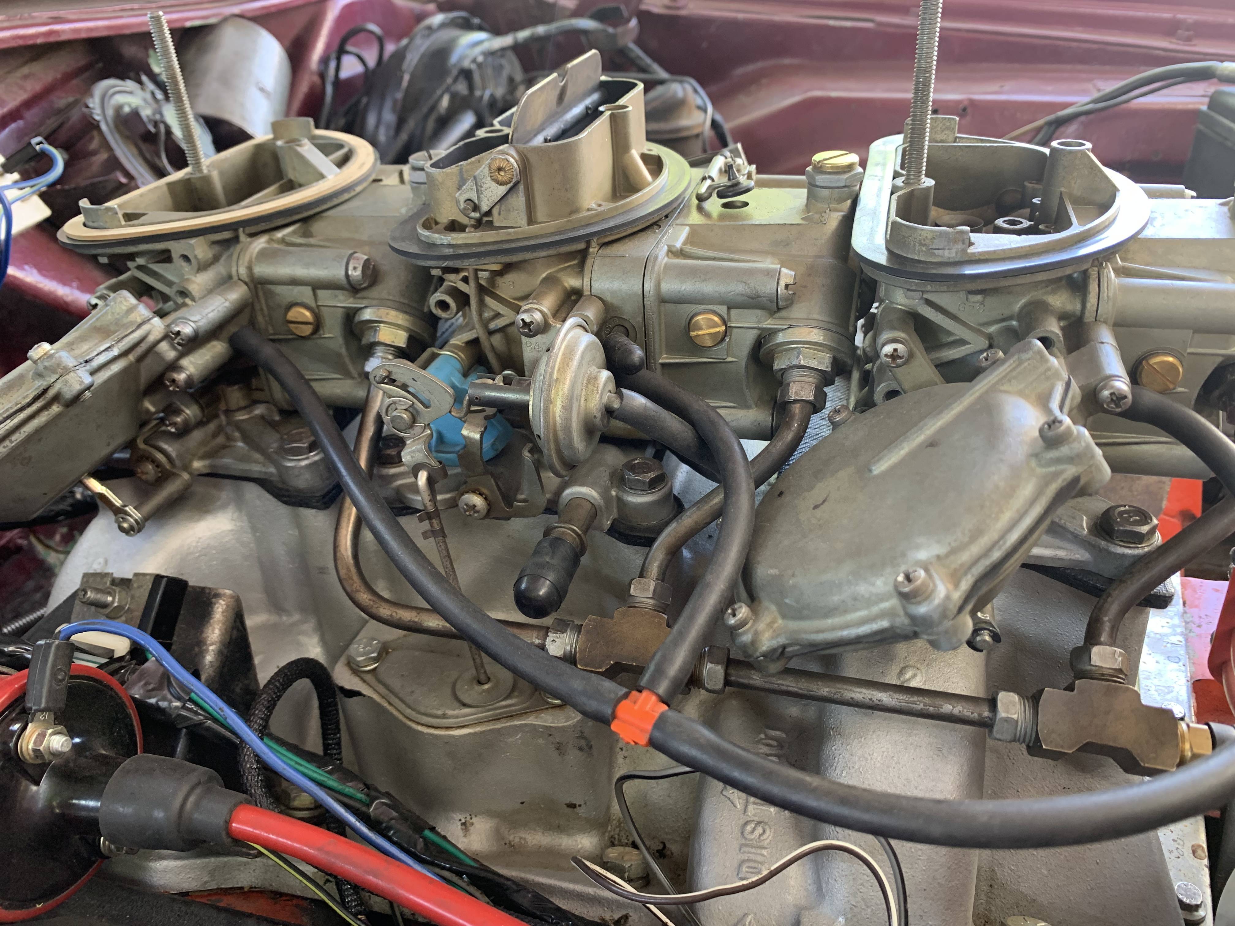

Apologies if this has been covered already, I tried the search function with little success. I have a '74 Barracuda with a 440-6 barrel and I'm looking for info regarding the fuel return and vapor lines. I'm pretty sure I've got the return line figured out -- I'm going to buy the Carquest fuel filter p/n 86041 -- but what about the vapor line? I think I understand the vapor line is mounted to a three nipple breather, but then where does it go?

Ahh, thanks a bunch! I had forgotten that some center carbs had the vent and some don’t. Mine are from 1969, so the center does not have the vent. I think that answers my question.
