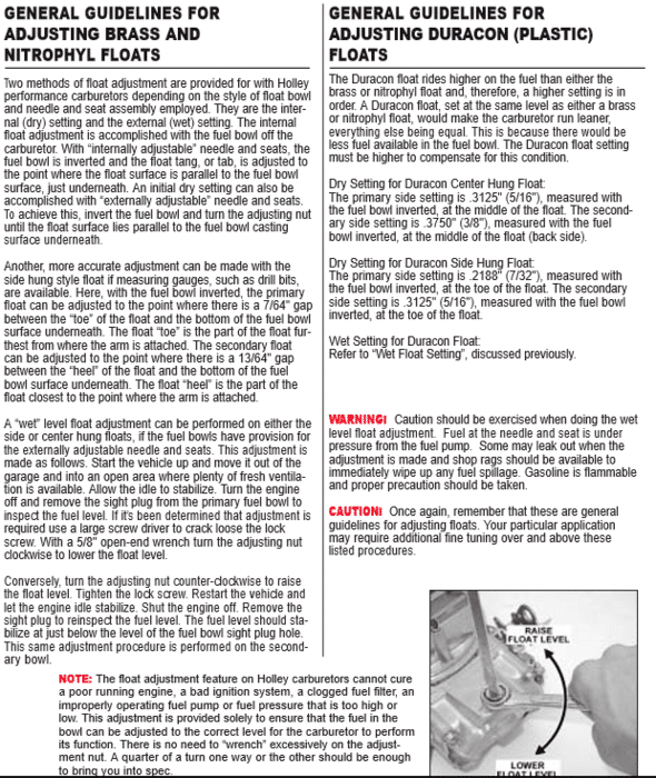

How can I check the floats, needle/seats?...….
The center brass float is easy. Shake it. If you hear fuel sloshing around you'll know. The nitrophyl is a bit harder. Try lowering the bowl level below the sight plug and see if stops dribbling out or it continues.
They don't break the bank to replace...……...
1969-71 16R-451A NITROPHYL HOLLEY 2300 FLOAT SET MOPAR SIX PACK END CARBS 2PC | eBay
A post from a "different" car site.....
"I worked at Holley for 4-1/2 years in the Pro-Stock carb department.
Holley has all 3 float materials you describe, brass, which I always use, Nitryphyl, which will eventually staurate and sink, and plastic. The differences are always described as bouyancy issues for different specific grabities of street fuels, but I have never had a bad brass float in a Holley, have had issues with saturation/sinking with the Nitrophyl, and just plain uncontrollable float valve problems with the plastic ones.
I use the brass ones, exclusively. I even change the ones in my Q-jets to brass every time I get a new one to rebuild/modify/use. "
But to be fair, others say they never had an issue.

When you play with those carbs swap the rear with the front and see if the front plugs foul. You rebuilt the center, did you rebuild the end carbs too?
The dribbling I said to look for is not from the nozzle (that's only for the accelerator pump system) but from the boosters on all 3 carbs.
Have you tried removing all 3 sight plugs and start the car and watch the fuel level? Don't do this without rags under each.
