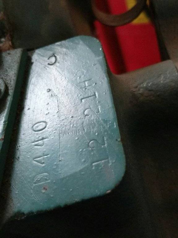

An engine cast in May would have come out of the same model year that it was cast in. Go straight for the machined pad in front of the intake. Below is a pic of my '68 440 HP. Notice the D440, the D is for '68, an E would stand for '69, F for '70 and so on. Also notice the HP after the 12 21, A 6 pack engine will also have an HP stamped on there somewhere. The other thing to look for on the block is another small rectangular machined pad just above the pan rail on the passenger side under the engine mount where the vin from the car it came out of will be stamped. If a full 13 digit vin is there(some are and some are just partial) look for a V in the vin which is the 6 pack engine code for a 1970. If it's a '69 six pack look for an M instead of the V.

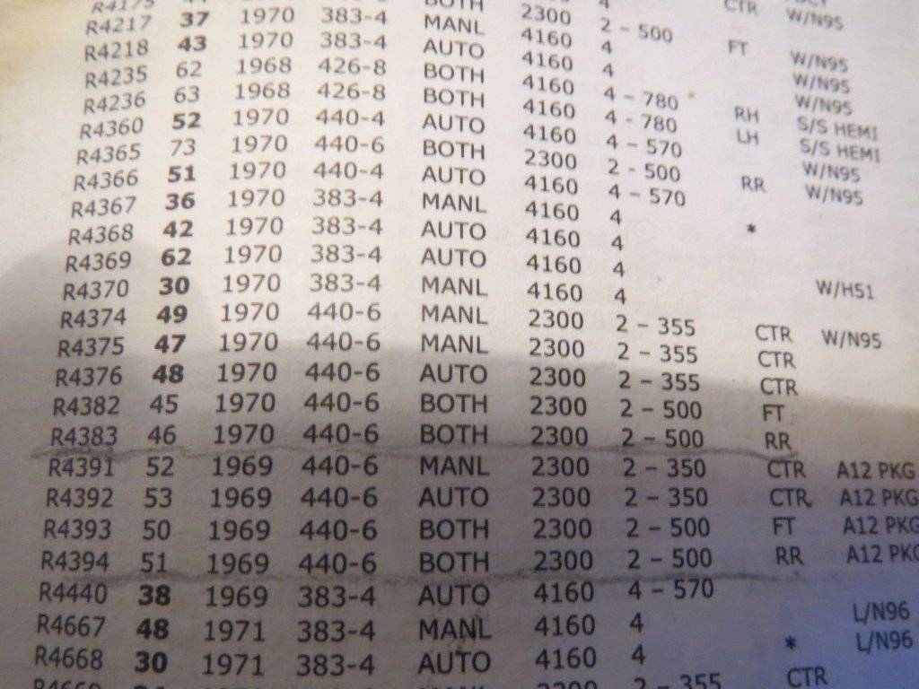

Here are some numbers to look for on the carbs and the date codes are 4 digit with the first 3 numbers being day of the year and the fourth being the last number of the year, for example a carb dated December 31st of '69 will have a date code of 3659. As far as a value? You don't need a real six pack engine for your V code car I'm assuming so it wouldn't be smart to pay a premium for such a unit if it is expensive. The six pack rods are beefier which also means that they are heavier and that's not necessarily needed for a street car and there are really no other differences between a 4 bbl and a 6 bbl accept the carbs, intake and dampener. If it's a standard bore (previously in-Rebuilt) that's a plus. Put it this way, there's a '67 440 HP engine that's .030 over(previously rebuilt with 25K on it) and some later heads for sale locally for $700 and although tempted I'm not running out to get it.
