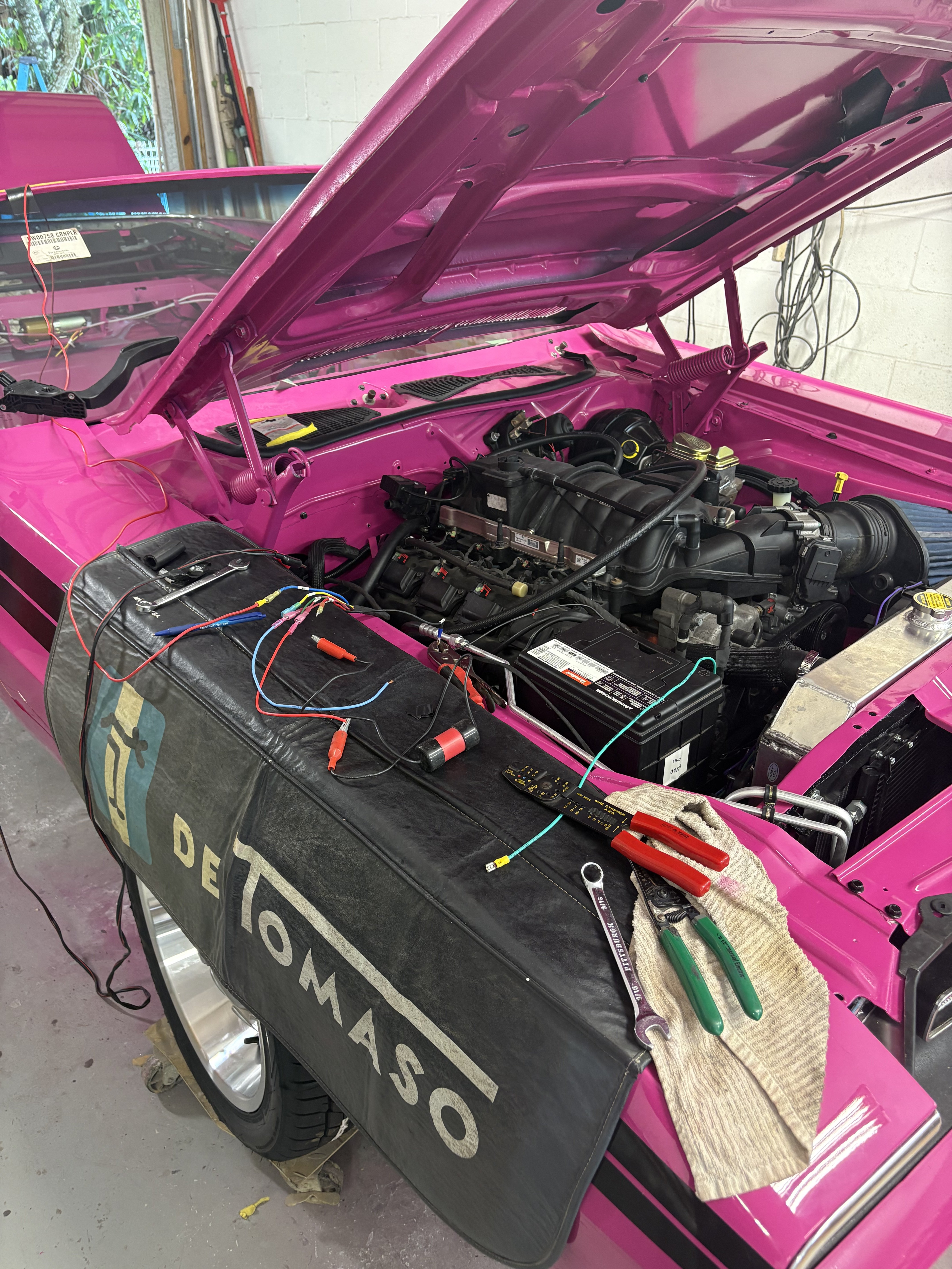

I have a 2020 6.4 w/ 8hp70, Sublime quick start set up with stock engine harness. I connect the battery power to engine harness, grounds are all connected, I connect ignition to power, then connect key on which cycles the throttle body and fuel pump primes system, all good to this point
Then I go to hit start button, engine cranks, fires and runs for about 4 seconds and dies. I thought it might be gas pedal calibration but pedal seems to work in the 4 seconds or so that the engine starts.

Yep, I called Blake from Sublime technologies, he walked me through the wiring, which was connected correctly. Only like 5 wires needed to get it running so I’m glad I didn’t screw that up.
He a gave me a quick troubleshooting check list,…..number one answer,,,,,,fuel pressure! He also said to check crank sensor, air mass sensor and because its still on open headers, add some exhaust to it so it doesn’t throw off O2 sensors.
In my infinite wisdom I decided to mount the fuel pressure regulator under the car by the fuel tank, figuring it would be out of the way and very short run for the return line.
Problem is you cannot read the pressure gauge when the car is trying to start. I cranked it in so it has 55 psi static, now the car runs about 10 to 15 seconds. I’m going to brake out my remote start so I can do what everyone else in the free world does and watch the gauge and adjust while running. Might even relocate it to the engine bay after all.

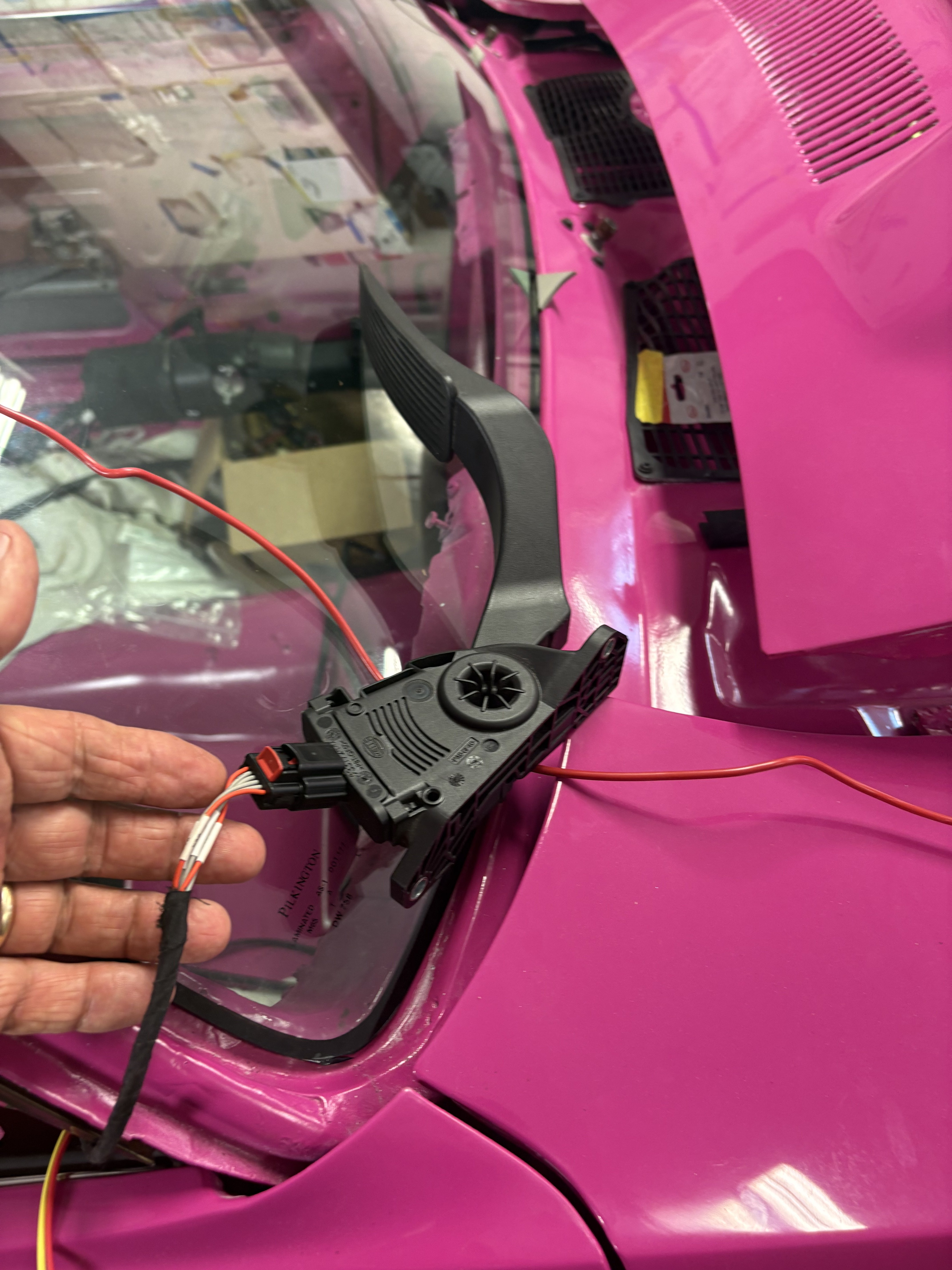

I know on my 6.4 it wont run until the throttle body & pedal is calibrated starts on first prime fuel then stop's
