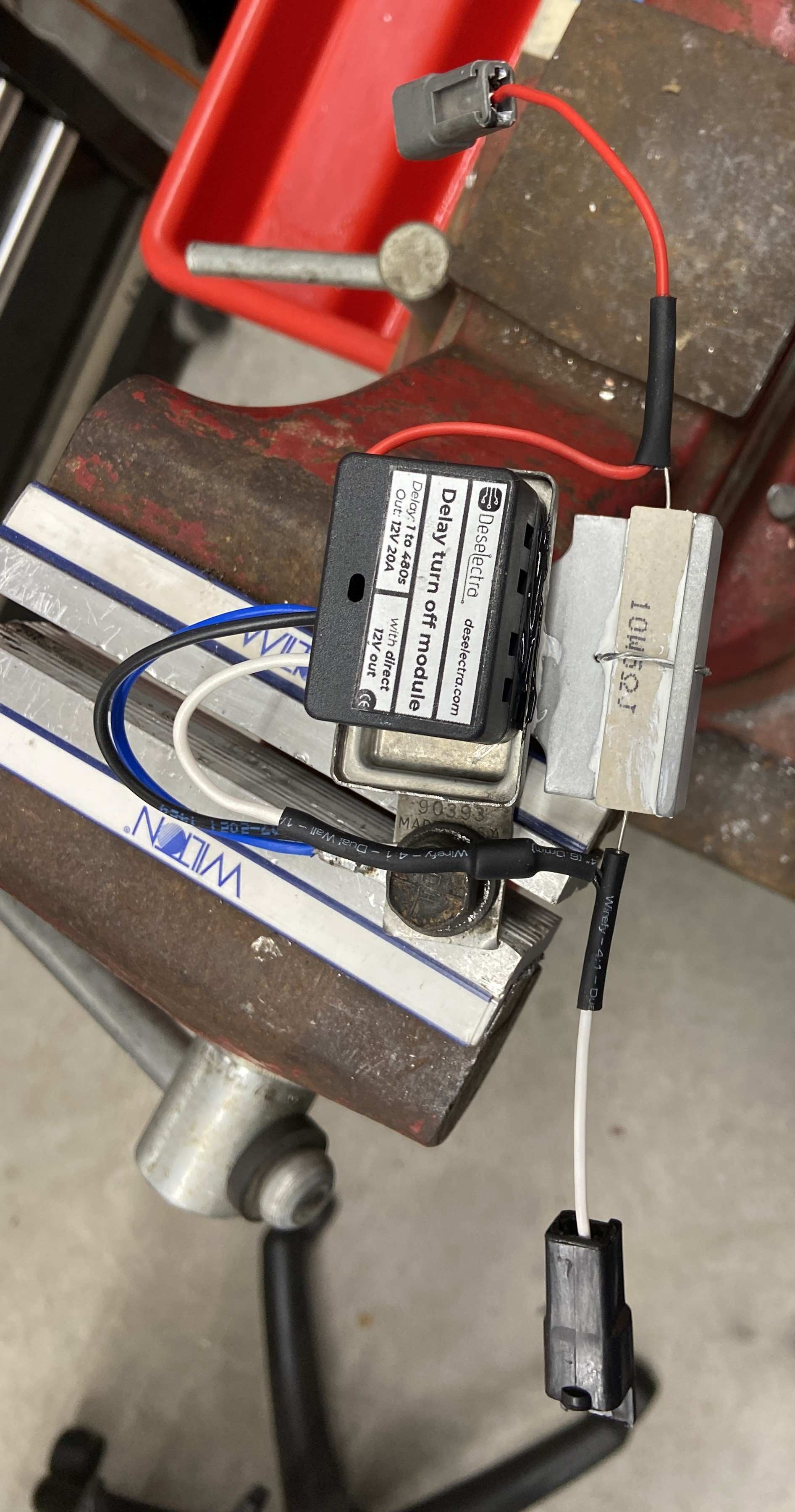

You video was invaluable. I made one for my 6 barrel set up and it worked great. I modified your set up slightly by not using the relay to keep from back feeding into the timer circuit.
I found an 20A timer circuit with case and added a diode in series with the choke feed to stop from back feeding. Then I put the 10ohm 10W ceramic resistor in parallel with the ignition source and choke feed. Without your info I could not have done this. Thank you again.

Update. Here is a picture of the 6 barrel electric choke timer circuit that I made. I changed the 10ohm resistor to a 5ohm resistor to get just over 1A once the timer circuit turns off. So far so good.IMG_8952.jpg
