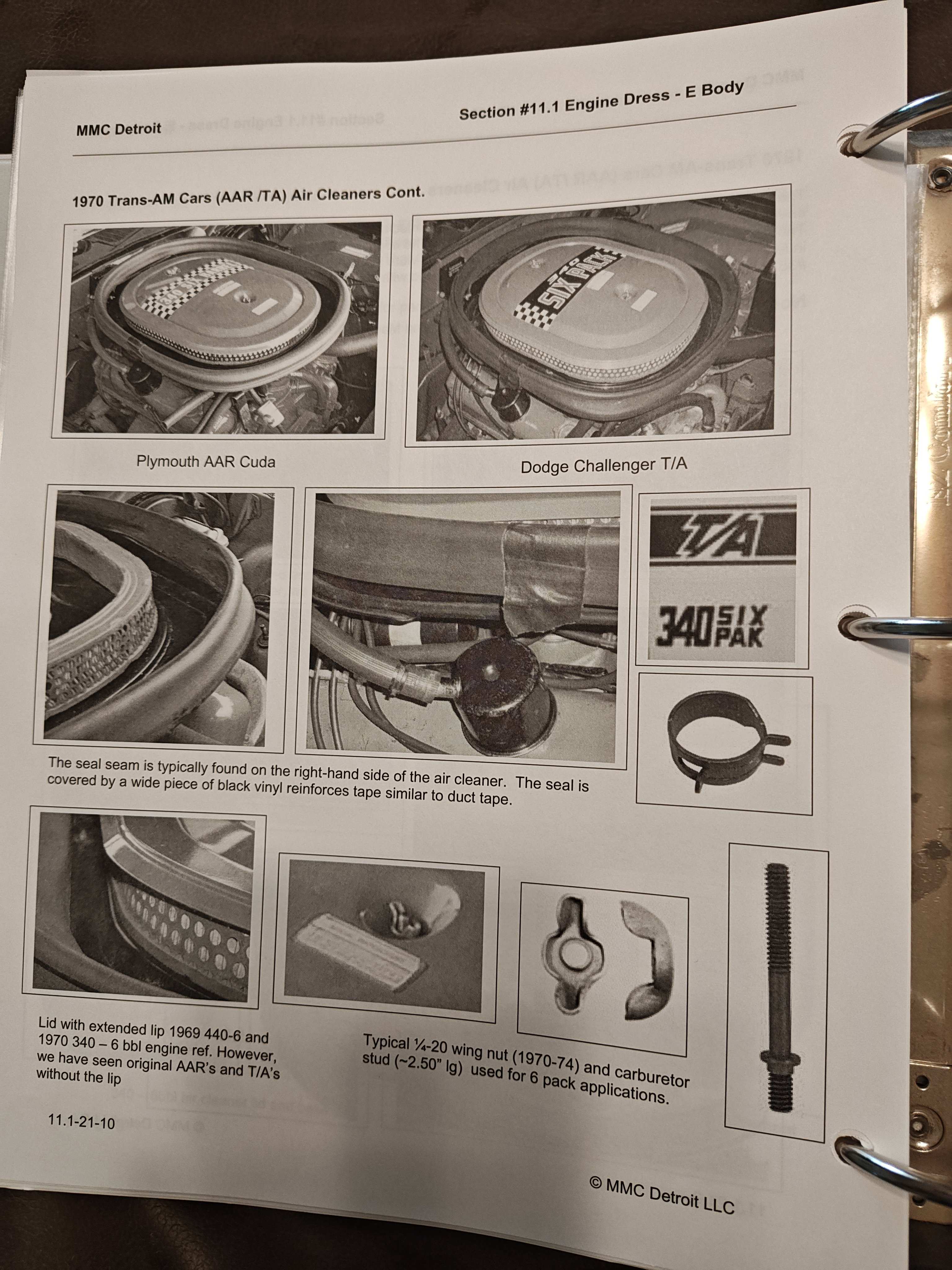

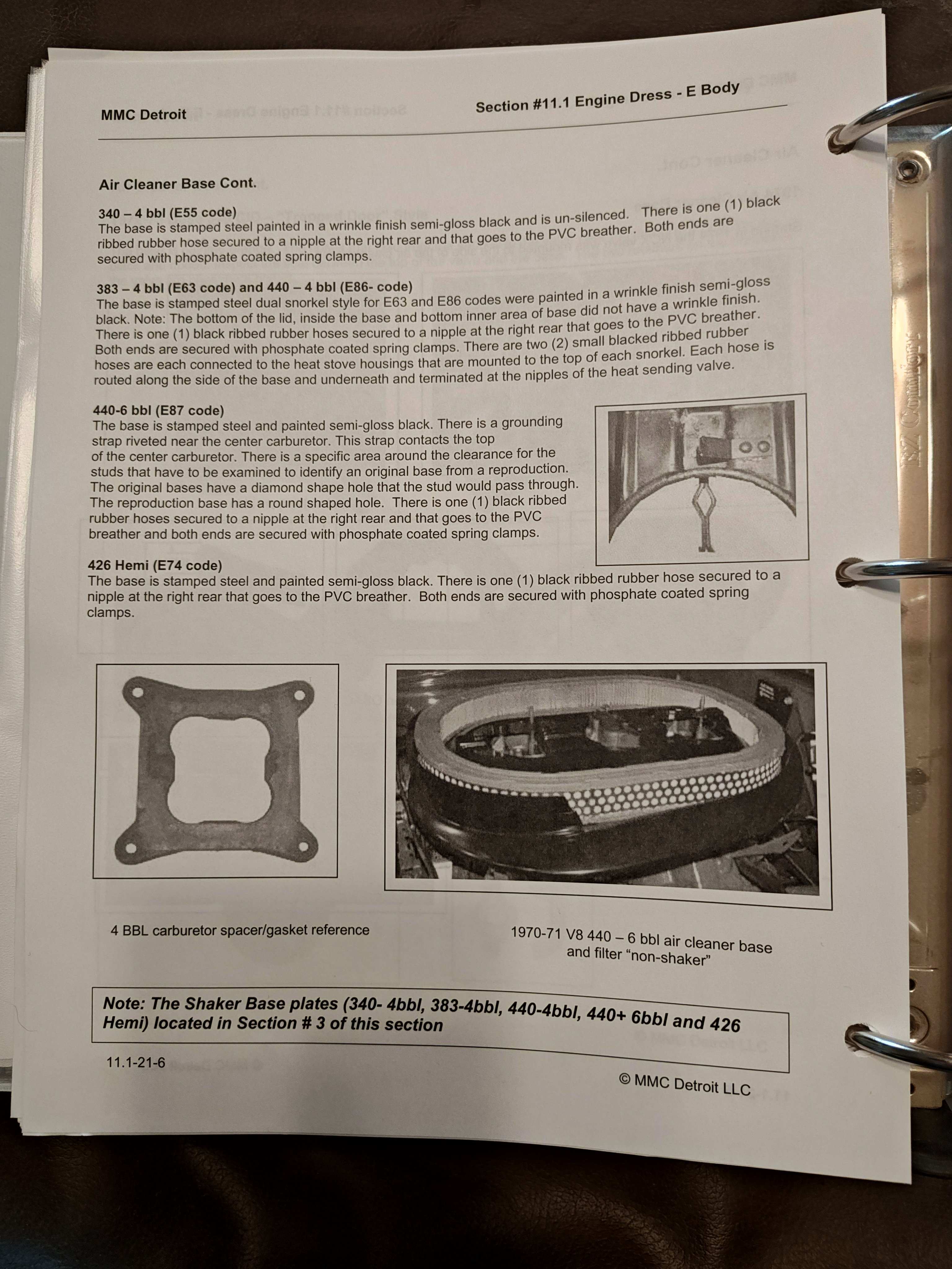

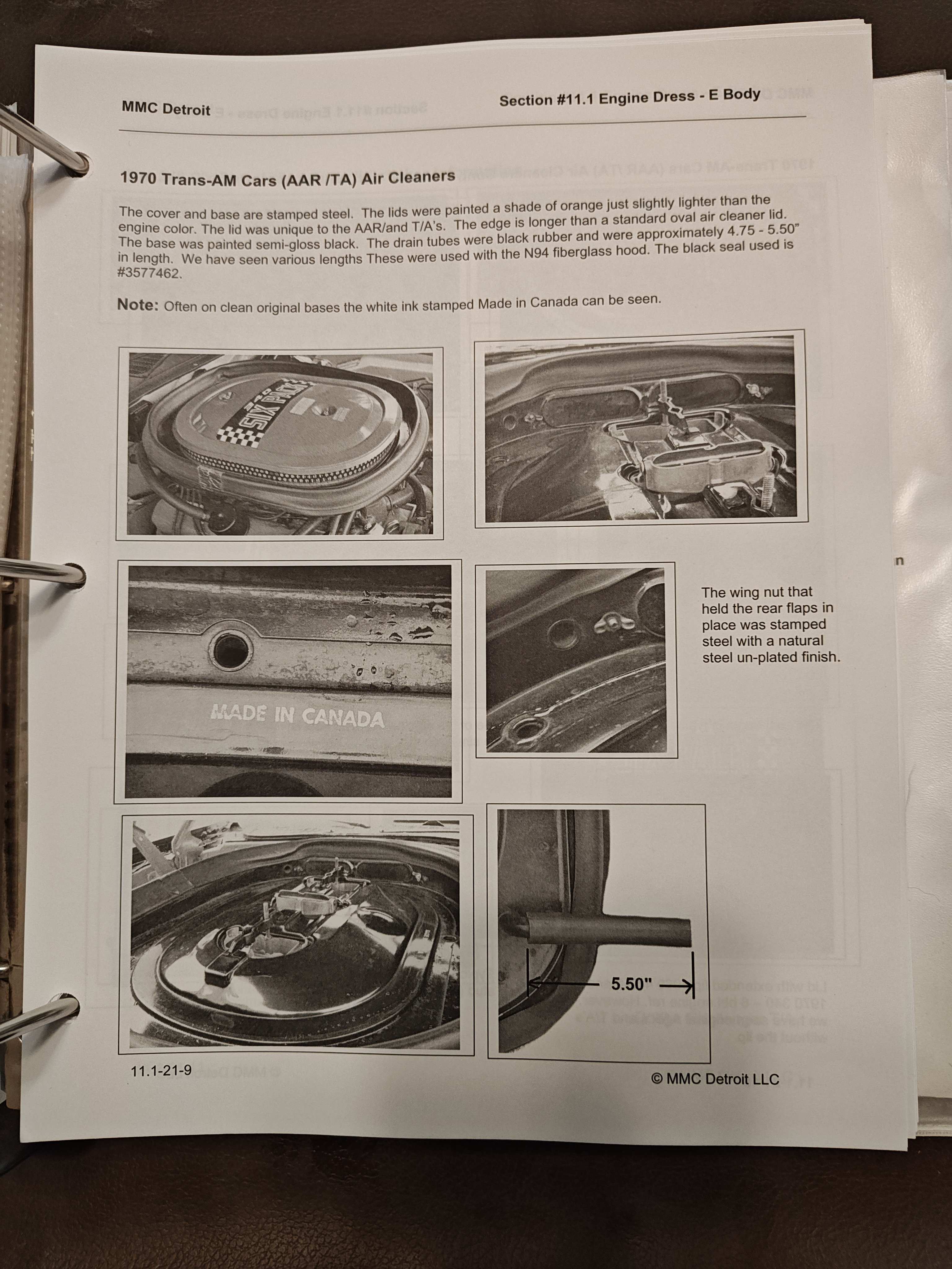

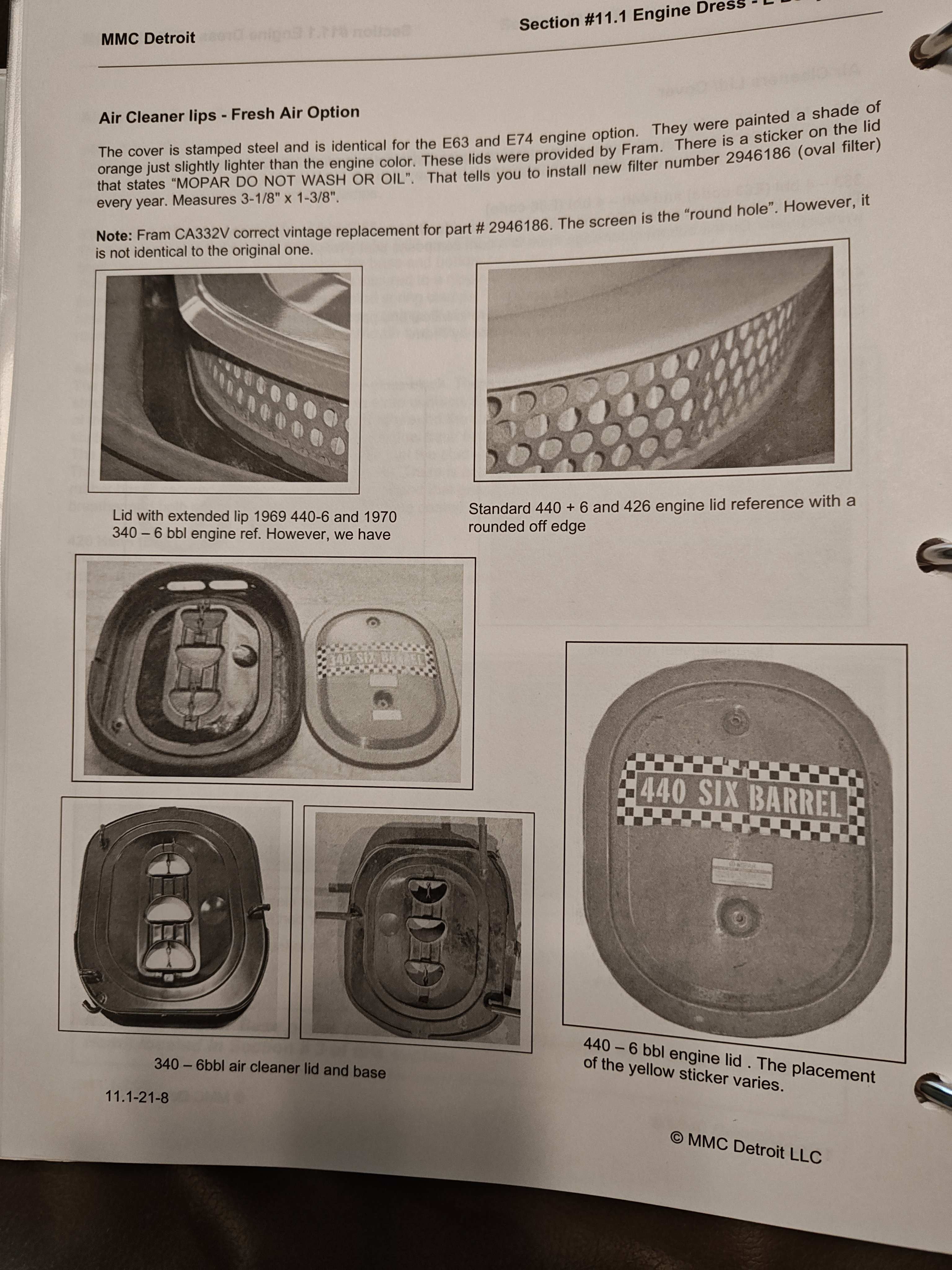

Any will fit the carbs as the spacing is the same but there were different designs - the 340 / TA base was unique to fit the fiberglass hood , 440 with ralley or Cuda hood had a blocking plate around the front of the air cleaner bases , the 69 1/2 440 was a different base to seal to that hood & the shaker hood used a different base also .

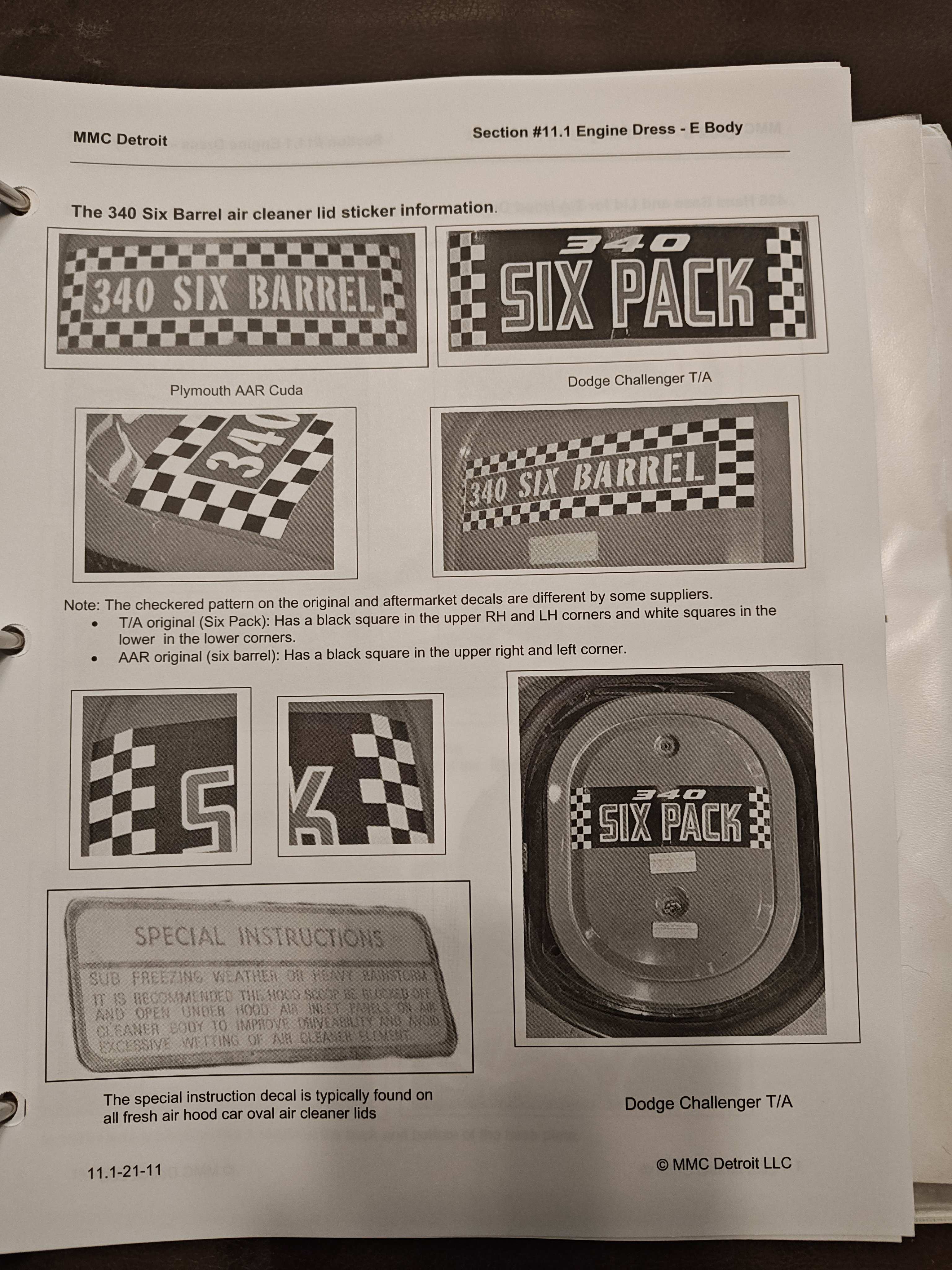

See photos below for more reading enjoyment on 6 pack air cleaners.
As mentioned above. I have a couple 440 Sixpack set ups, a 383 (short deck) Sixpack and a 340 Sixpack set up. All will take the same carbs, spacing is all the same and the aircleaner assemblies are all interchangeable. However, there are several different designs of aircleaner assemblies.
