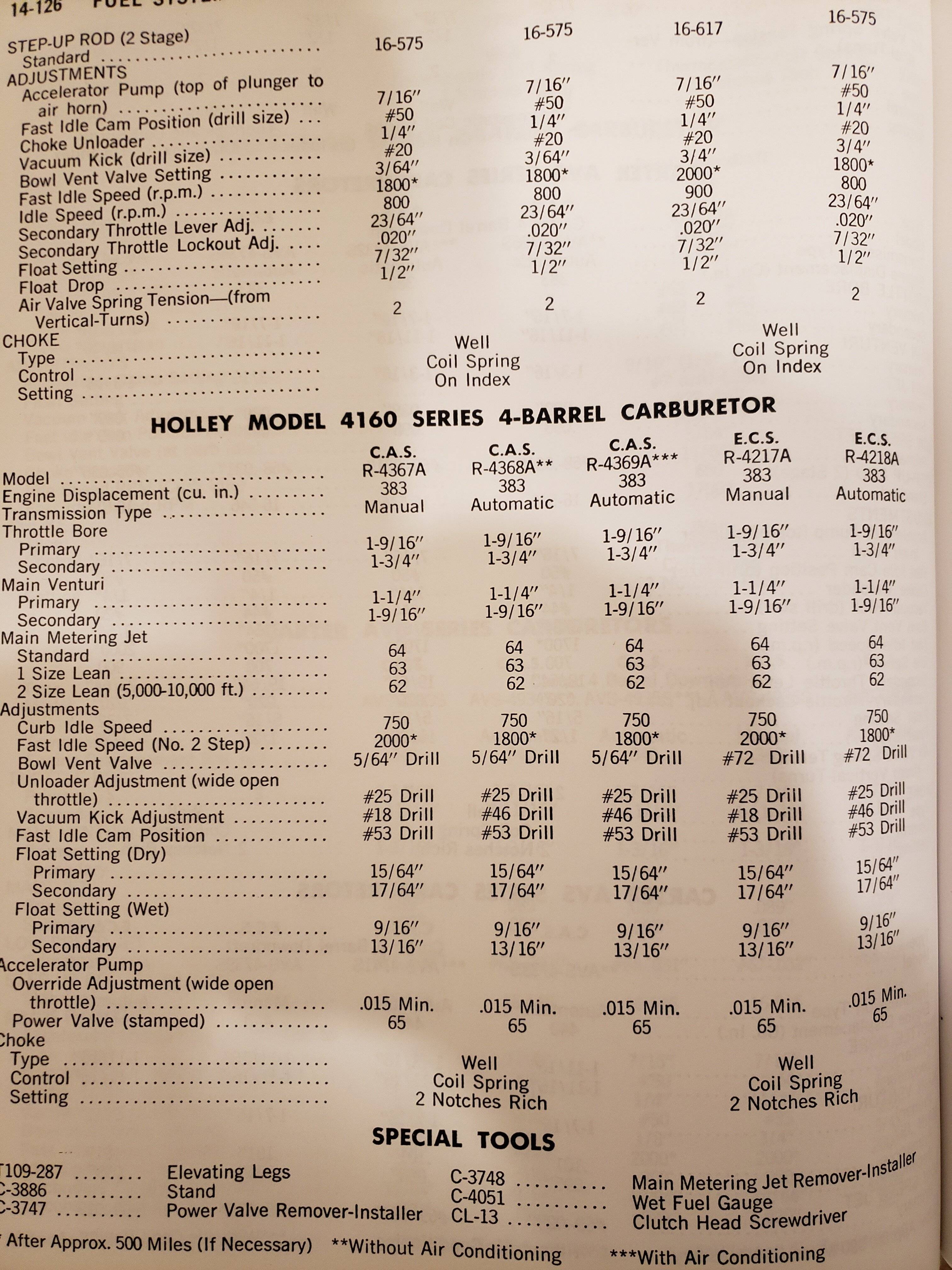

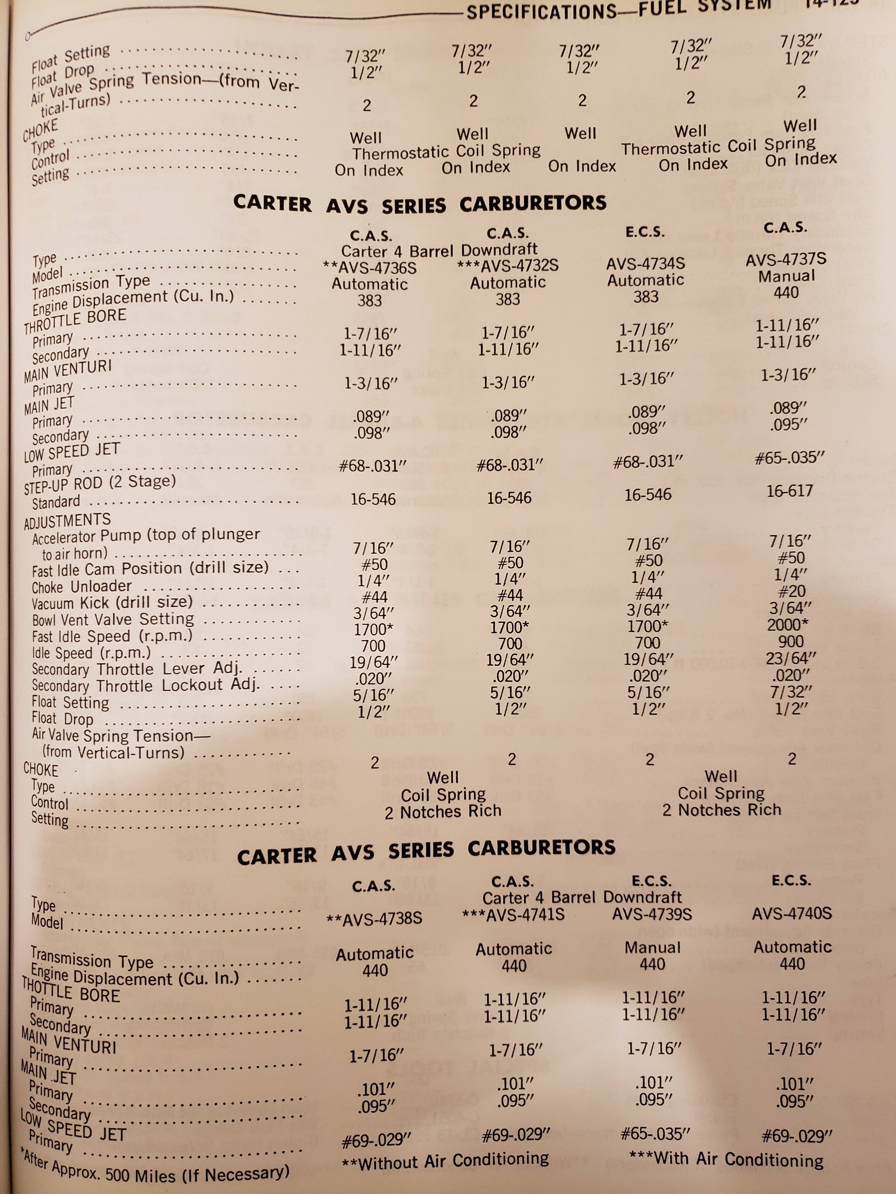

2 pages from the 70 DODGE Challenger Dart FSM were/are confusing me, Holley or Carter......Why?

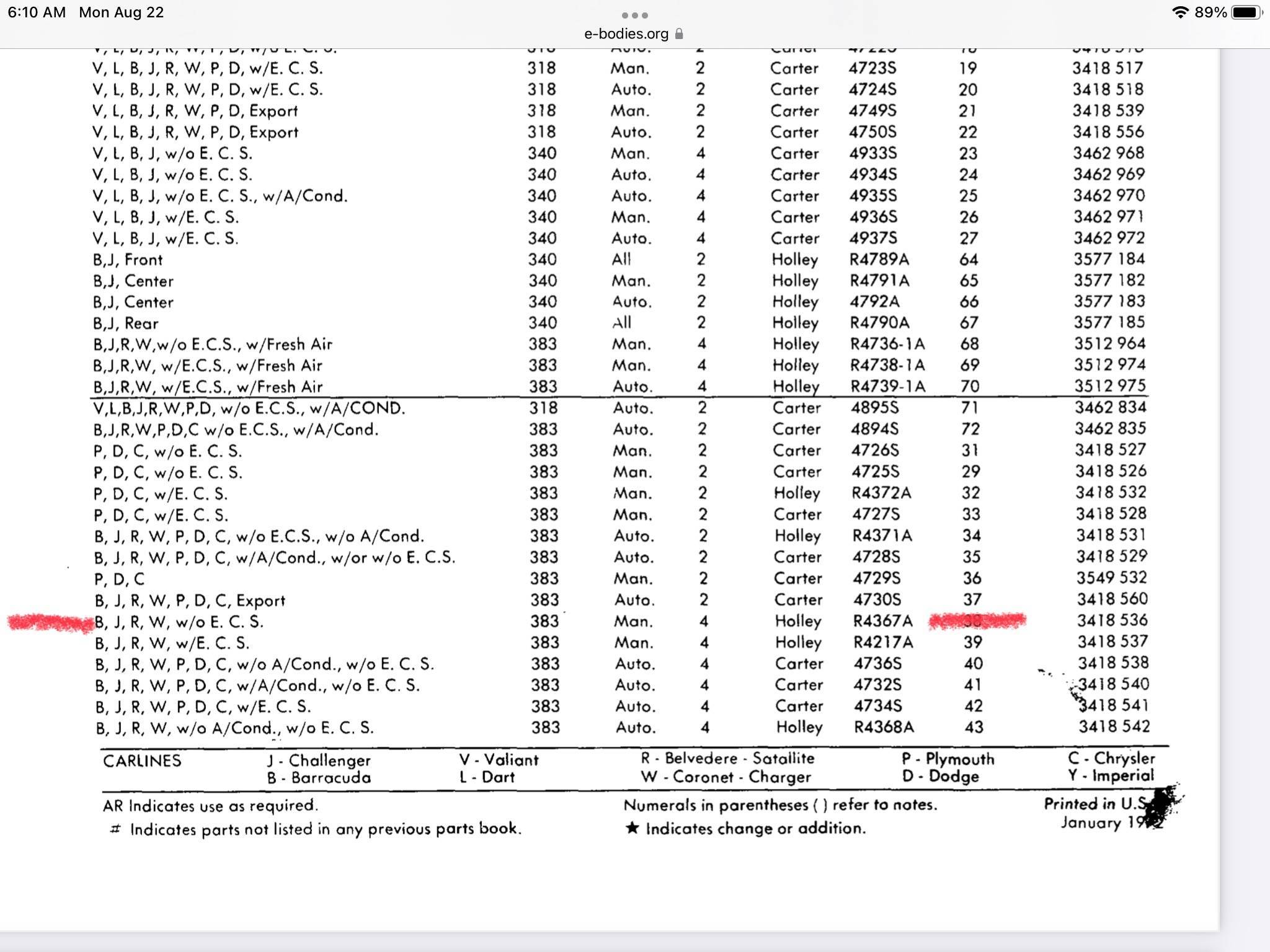

383RT posted a shot of carb listings in a thread in the 'fuel & air' forum which likewise confirms both brands were used.

Sons have grow'd up & have there own lives and they still have excellent memories, me not so much. I was thinkin' that the 62 would be the last 2 digits of the part number. The parts book page that 383RT posted in another trhread that I reposted on this tread is what was throwing me off.
