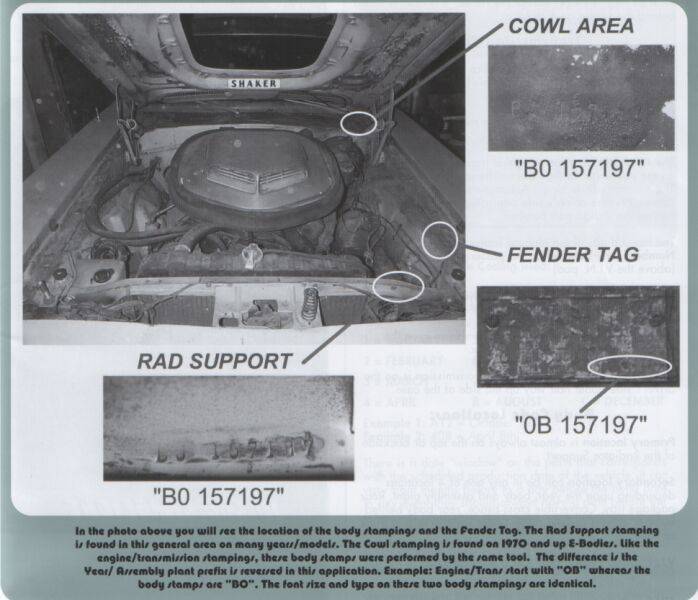

A rallye package did consist of the dual scoop hood and rallye guages. It was first offered in 1972. The R/T package in 1970 came with the same parts. Your VIN has to be JS23 to be a R/T. You have a JH23 car. It did not come with the hood or guages it has now unless the VIN has been changed. Follow this picture and see if all the numbers match.
