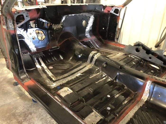

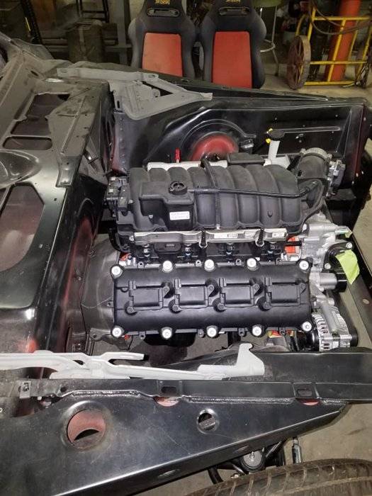

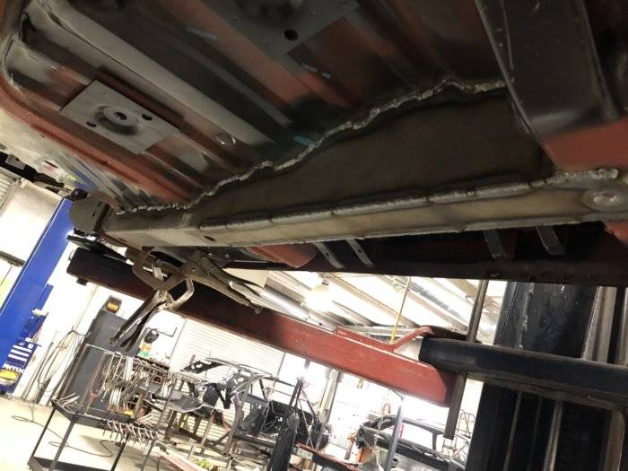

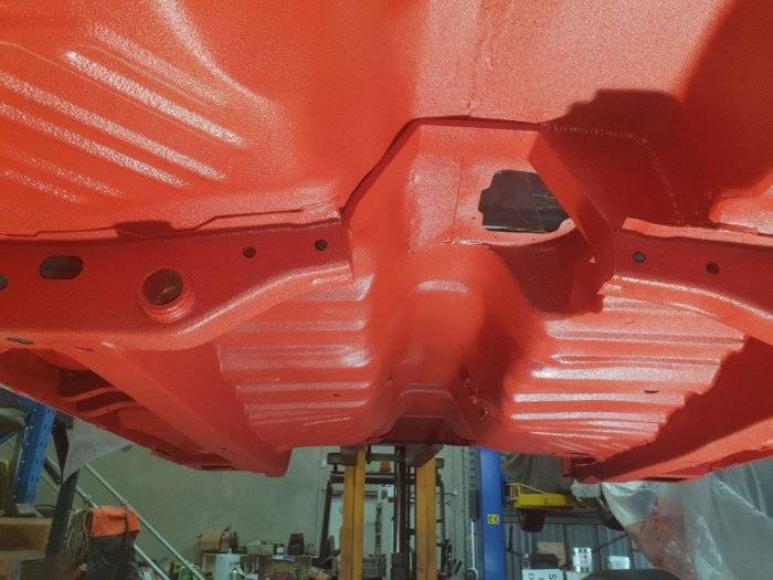

I just put the 426 gen 3 hemi in my 70, I went with RMS front suspension, and US car tool mini tubs and frame stiffening . If your going to do it, do it right the first time,Im looking to go for it and put the 426 Hemi Hellephant in my 70 Challenger. What other frame stiffening or body mods do you all suggest to accept all this new power, already have the frame stiffeners installed. Thanks

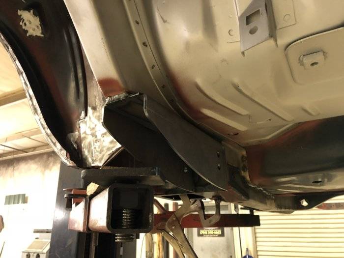

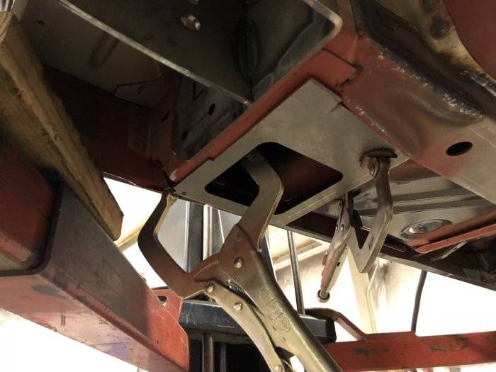

First if all, welcome to the forum. Please be sure to show us pictures of your car! Since you have sub frame connectors, the other options are torque boxes, radiator core support and inner front fender braces. All the parts can be bought at US Car Tools, or XV Racing Products LLC. I prefer the XV front fender braces, and dealing with them if you have a problem, but XV does not make toque boxes. You also might want to talk to XV since they make a complete front and rear suspension to help handling all that power.

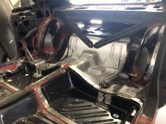

The "V" behind the rear seat needs to be tied to the package tray and then to the floor in the corners. There is a lot of flex in that part of the car that gets overlooked by most.
