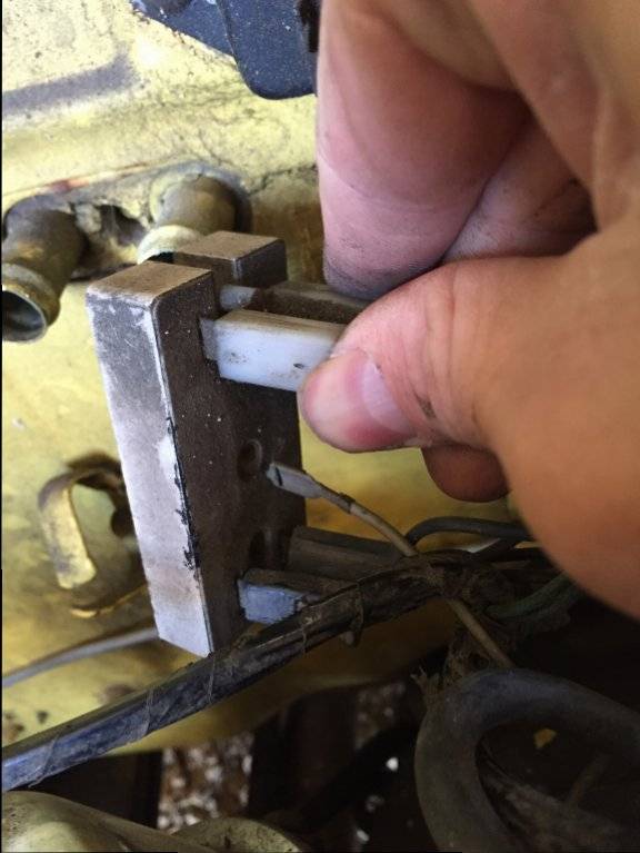

Went to get the car running over the weekend, went to start it up and smelled something burning and smoke. It was obvious it was electrical. I didnt even start the car, with the key on this box was getting hot. no idea what it is. Any ideas? Car ran fine when parked. dont know what happened

That's your ballast resistor. Did you see smoke? Was the smell inside or under the hood?

Start by inspecting all the connections on the bulkhead connector located on the firewall above where the steering column passes through. Did the car start?
Btw, I try to never leave key in the run position unless it's running.

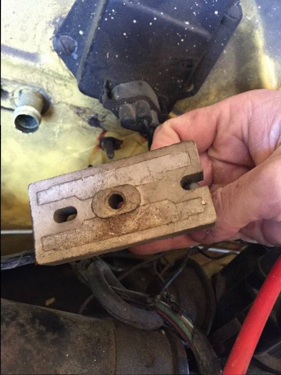

So need advice. I got a new ballast resistor. Plugged it in and turned on the key and right away the new one started heating up and got hot

Start by checking how much voltage you're getting before and after and if it's too much start backtracking.
