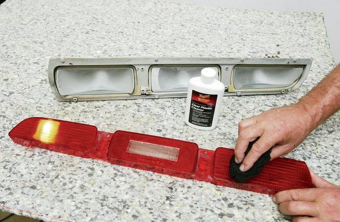

Are yours cracked or missing pieces? The originals could be polished. Not sure if that is an option for you. Can't believe the prices the originals are going for!
Article from Hot Rod mag. I was going to try this on mine. Hope it helps.
Meguiar's Clear Plastic Cleaner applied by hand was enough to bring a bright red gloss to our original lenses. If the lenses are heavily oxidized, we have had success with the same product and machine buffing.

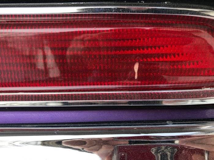

Here is what I'm dealing with. from 5ft away it looks like bird poop, it's actually marred. I'm not sure what caused it. but if there's a way to hide it...i'm all for that, rather than spend $200 + for lenses
