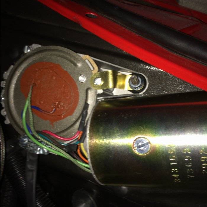

Yes you will need a 3-speed switch for a 3-speed motor. The pivots and pivot connecting link are the same for a 2 or 3-speed. The drive link and the crank with pin on the motor are different from 2 to 3-speed. All you need to do is pull the motor (which BTW is an incorrect 73 motor) post some pics of the crank with pin and connectors to your linkage on your motor and show a pic of where the drive link connects to the motor and we will be able to tell you what pieces you have so you won't have to pull all the linkage out

I'd like to add to this question if you don't mind. I got my 2 speed wipers to work on my '70 Challenger today. They don't park themselves when I turn the wipers off but I can easily turn them off in the park position myself. Is that normal or should they park themselves?
Also, should they park on the glass or on the stops that are on the stainless trim?
Seems weird that they would always be wiping across the stainless trim but they do look nicer parked lower like that.

The picture you posted is a three speed wiper motor and it is correct for your ‘70 Challenger. If everything currently works, then you really shouldn’t need to change out anything other than install the 3 speed switch.
aussiemark
Nov 29, 2014
1,218
330
Perth Western Australia
It is not correct it is a 1973 wiper motor it could have a smaller shaft unless it had the 5/16 shaft installed when it was rebuilt the correct wiper motor for a 1970 Challenger is part # 3431077 with the 5/16 shaft and the lever arm to connect it to the linkage is part # 2822289
