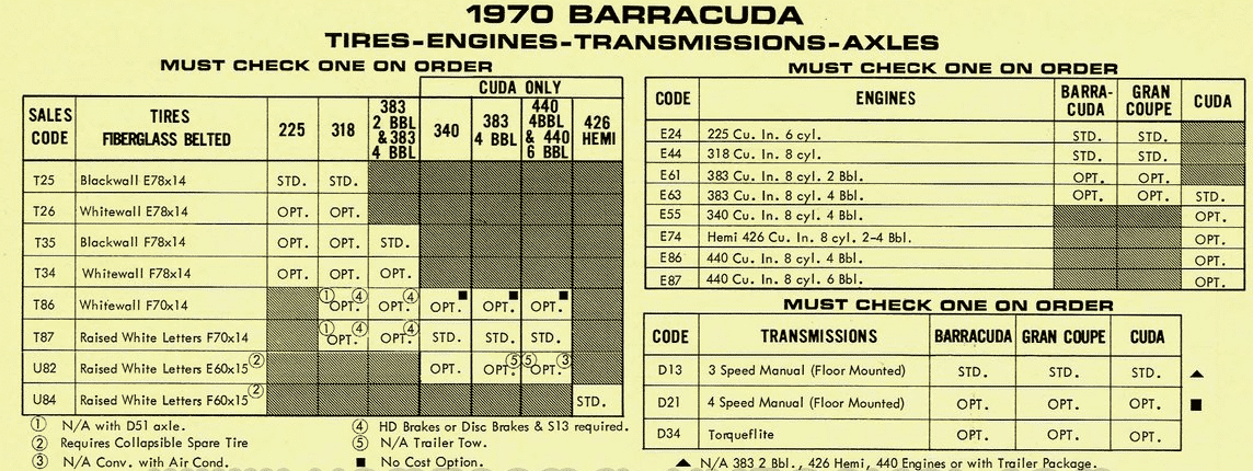

Dealer brochures and early pricing guides showed the 15" Rallye wheel with E60x15" Rallye wheels as standard on Cuda 340 models but that was not correct.

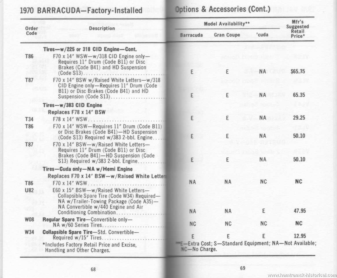

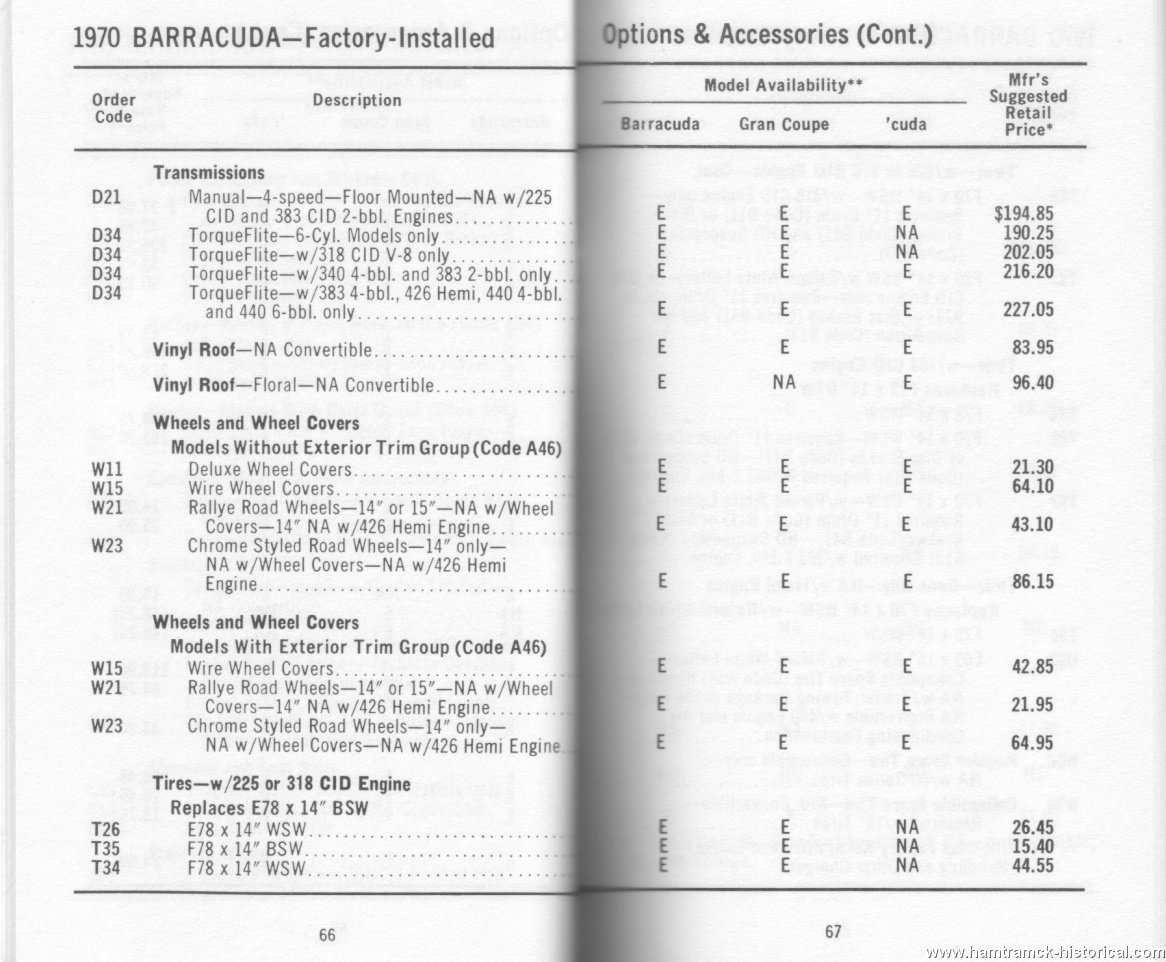

The problem starts when the early printing of brochures, pricing guides, data books, etc. put out information for the initial introduction of that year's model. Later, they see a need for a cost-reduction or customer demand leads to option changes. Memos go out to the dealerships informing the salesmen of what changed and you end up with items the customer wants not being standard any longer or unavailable. You also end up with some of the desirable options being offered on the base models. One example would be the Cuda performance hood (two scoops) being offered later on the base Barracuda (BH) sans the engine callout emblems on the scoops.
Most of the time the change is good for the customer. In the case of the 15" wheels as standard on the Cuda performance models, penny-pinchers robbed the more common Cuda 340 of this desirable wheel combo but did offer it as an extra cost option. Original pricing was not bad at MSRP of $21.95 to get the 15" wheels but the tires added $47.95 more. A modest amount.
