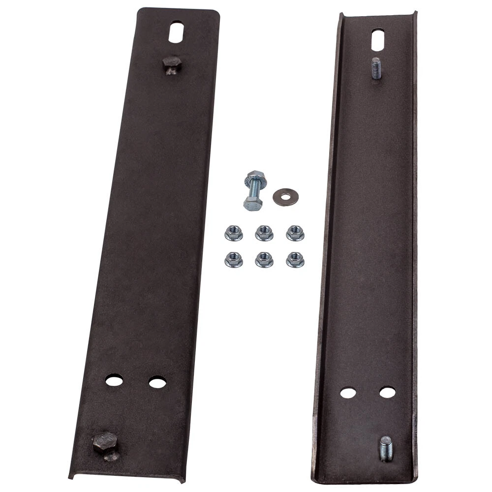

they make them. somewhere out there. I used a set from a swap meet back in the 2010s to move the seat track rearward by 3 inches. But once you see what they look like, they look easy to fabricate.
The ones I used added about 1/2-inch to the height of the seat, which isn't ideal, since taller people (in the torso) are the ones likely wanting the leg room.
They are long brackets (one for each side) that bolt into the original holes in the floor board, while providing a bolt point for the seat track a few inches further back.
I seem to recall seeing another type, in the last few years (was it Year-One?), that is a smaller bracket, four (4) in total, one for each bolt point, doing pretty much the same thing.

I found some universal ones for my 64 Polara. Ihey seem simple but were a turd to install but they made a great difference.
