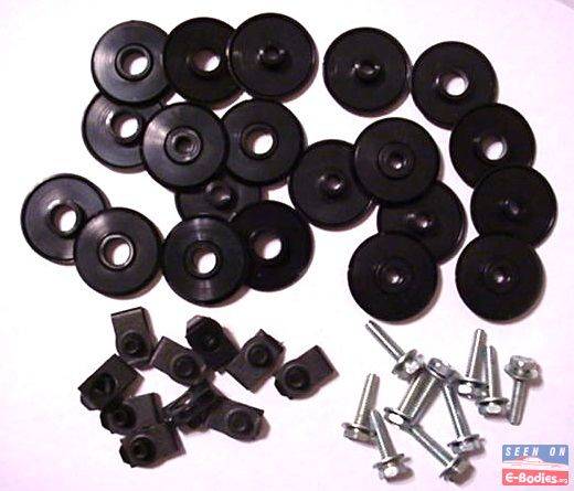

I have the 2 pages from the FSM that show how it mounts, but they are not great. A few pictures of how the spacers go in and anything else that you guys might have would be appreciated.

These

Okay, now I know what you're referring too!
Those are basically just washers and they go on all the screws that go into holes that are bigger that the holes sized the same as the screws. If I remember right, they are used on all but the one or two screws located in the very center of the grill.

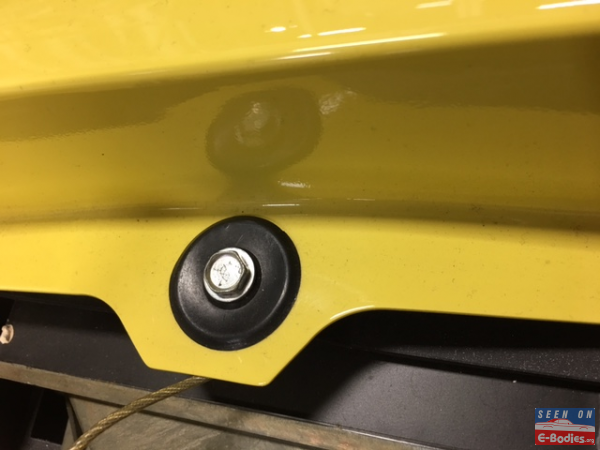

Are you able to get a picture of how the U nuts are mounted and anything else?

If you're talking about the u nuts on the grill itself I can do that. I'm heading out to Arizona for my grandson's graduation party this weekend but I'll try to do that when I get back the first of the week.
