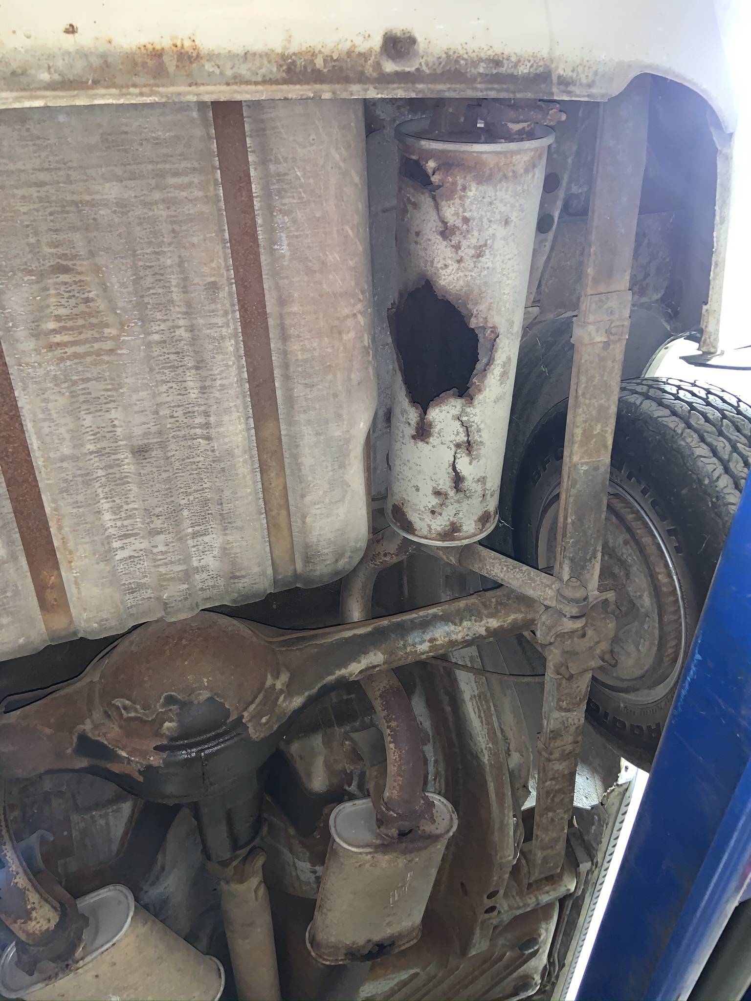

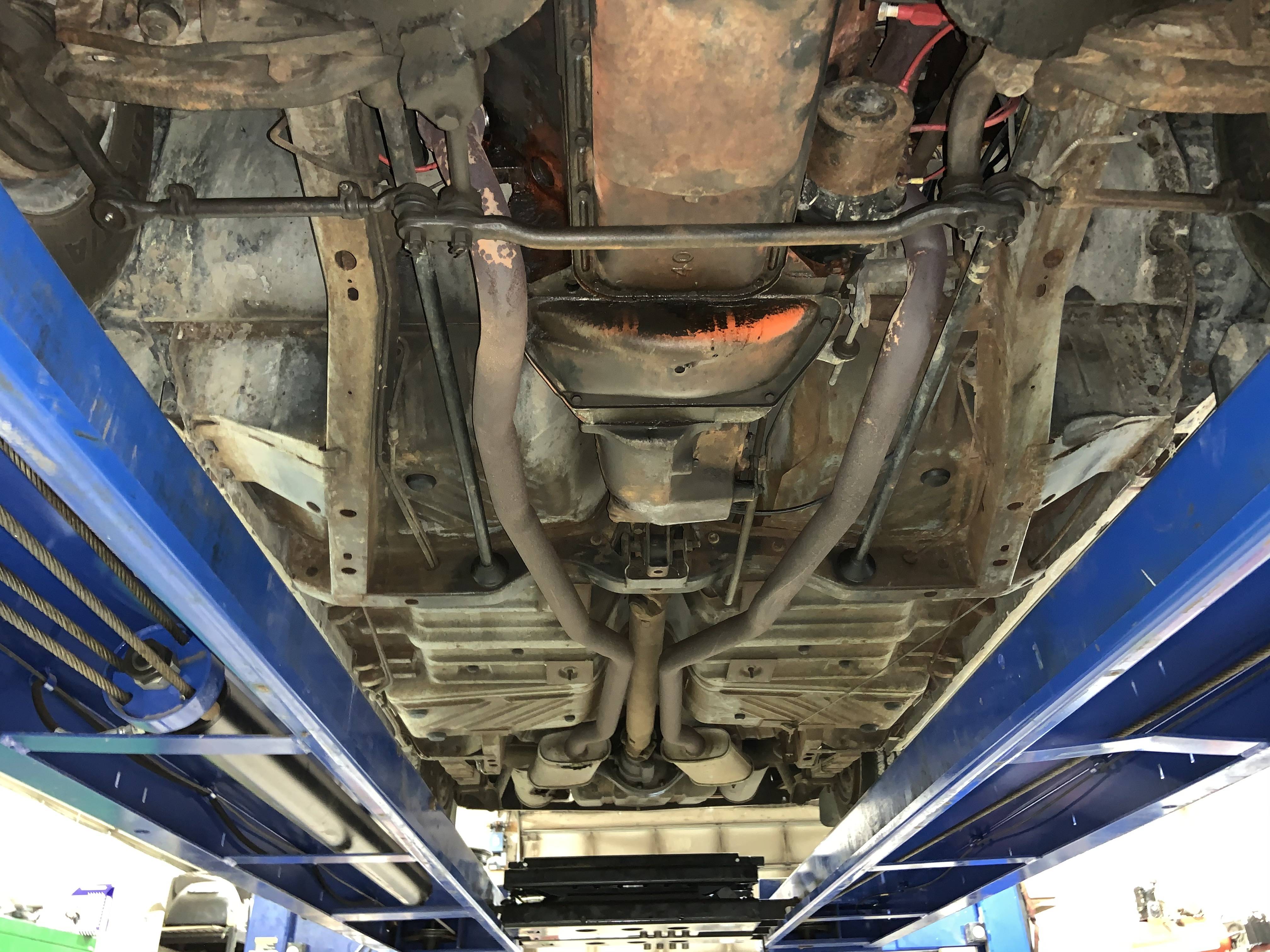

Here are pictures of my exhaust that needs replacing, would you leave the original piping and just change the rear section, the resonator and muffler have the Chrysler numbers on them.
The rear diff needs to be resealed to clean it up and I’ll rebearing it at the same time, is there anything I should look for while it’s out? Any tricks to keep the teeth timed?
I can stumble through the diff rebuild but If there’s any alberta Canada Chrysler guys on the forum that could direct me to a good mechanic that can do a professional job on the differential let me know Thanks

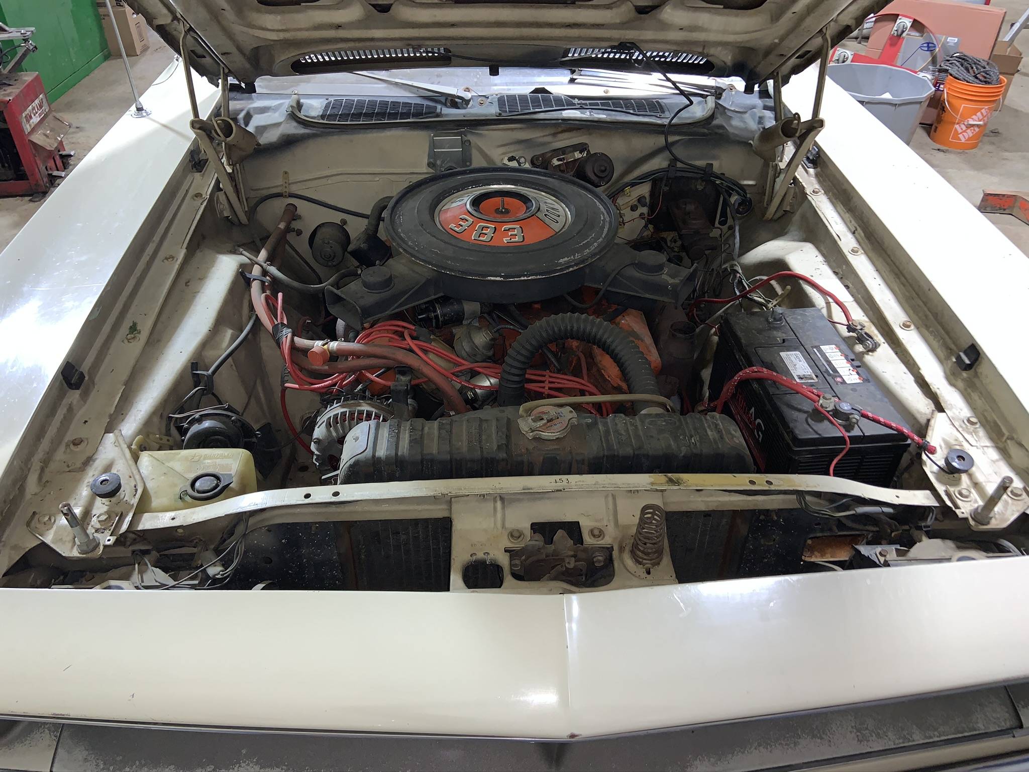

Lots of things in the engine bay are not what you would see on a survivor car. Replace the heater hoses, radiator hoses, radiator cap and overflow hose, plug wires, and battery cables with correct ones. Needs a battery hold down bracket.

Yes I need to track this stuff down. Thanks for pointing all that out I’m sure there’s more of that. It didn’t become my brother’s until the late 70s so I don’t know it’s history and need to get this stuff back to original,so it’s good that you point it all out as I would consider some of this as original.
Where is a good site to get plugs wires and wire holders, rad hoses and cap
Thanks for the help

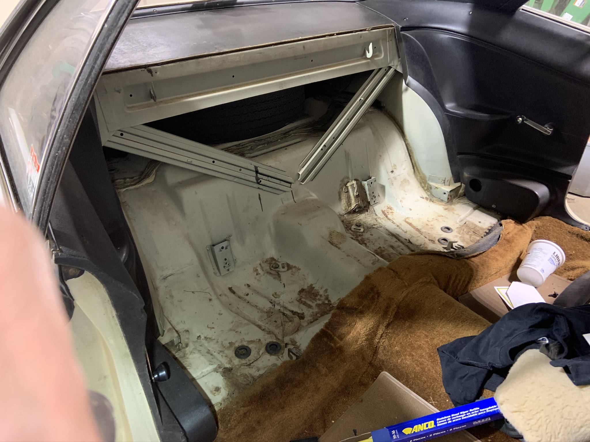

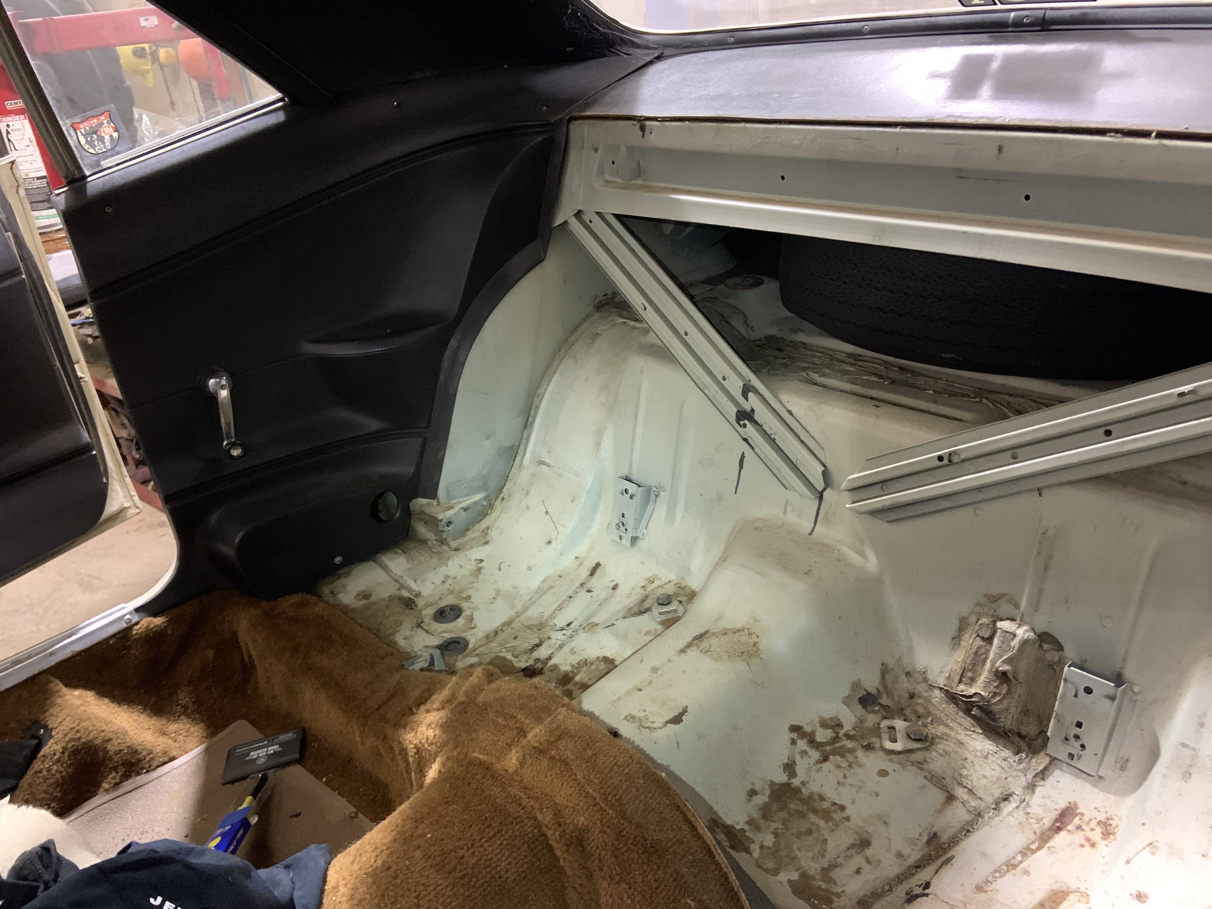

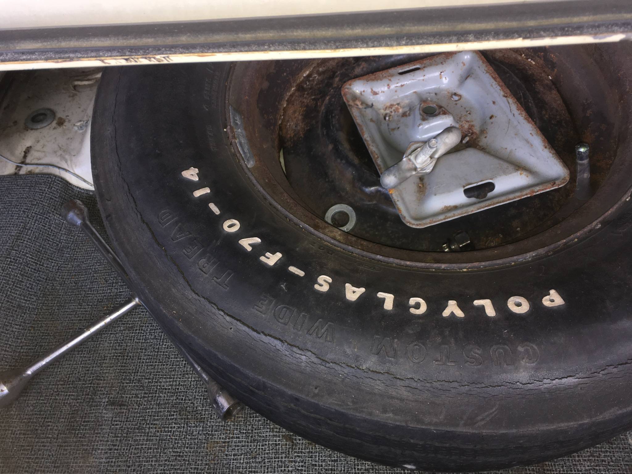

Here’s some trunk and rear seat pictures that Cuda Hunter asked for, I’ll get more pictures at a later date, the fender tag was removed and misplaced and is currently and most likely lost😣

If you're concerned about getting a fender tag, Backeast reproduces them. Since your car is pretty original you might want to take pictures of the options that are on the car. Contact Backeast and tell them your situation on the mostly original car but the fender tag is missing/misplaced. They might reproduce a tag for you with your pictures as proof of options and the car's originality. I've heard that some people have tried to add options that didn't come on their car from the factory so they could get those options put on the reproduced tag. A lot of changes and added options can happen to a car over 50+ years. Backeast can advise you. You've got a really nice mostly original 'Cuda!

I'd fix the exhaust and drive it without fixing anything else. Definitely leave the paint and body alone. IMO the less it is messed with or "corrected", the better. But I'm sure opinions will vary. If you want to put a bunch of miles on or start playing around, get another car that is less original if you don't want to affect resale. It's your car though, do as you see fit. Tunnel ram would look cool sticking out of the hood...
