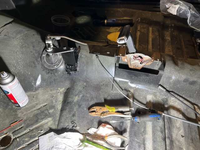

Good progress this weekend. 727 is IN. Slaptick linkage connected. I am ready to move on to radiator and coolant. The Wieand manifold has a 2.5" opening for the Thermostat. Anyone have a recommendation? Stock Thermos fall in.... No bueno.

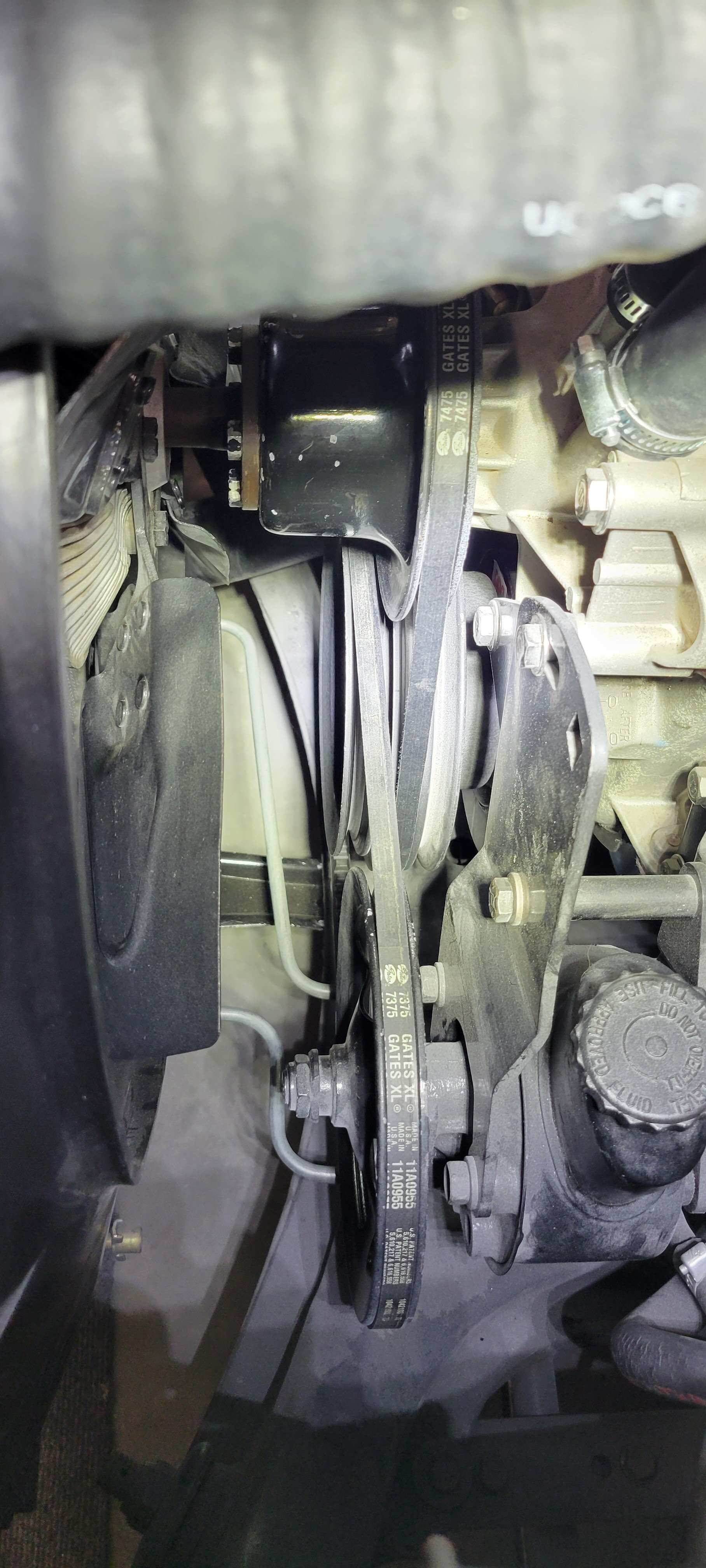

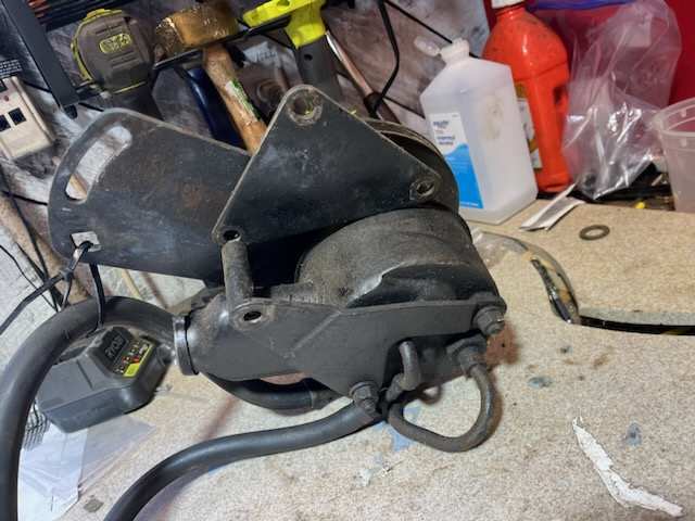

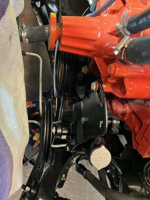

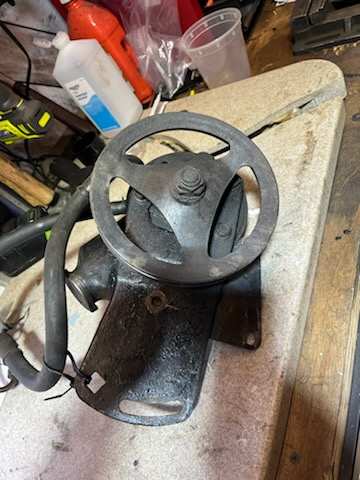

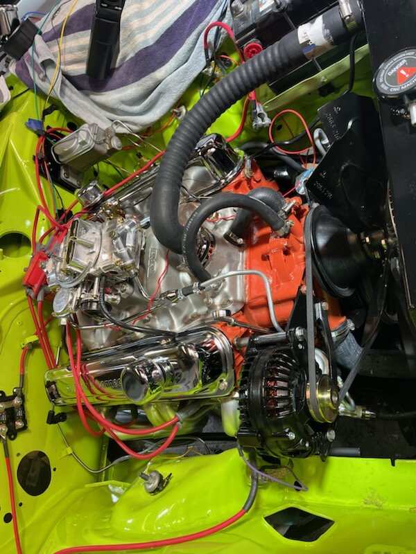

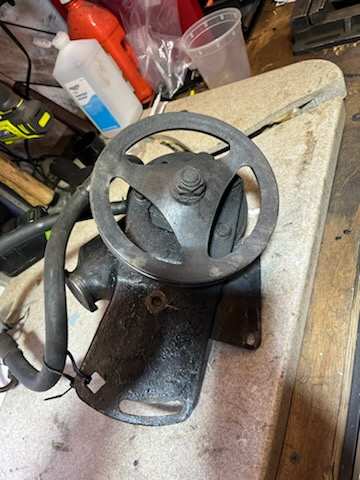

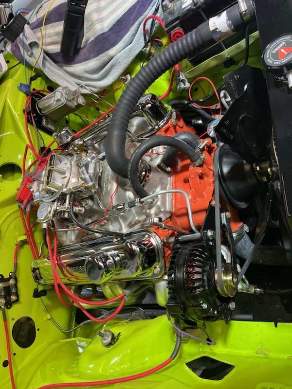

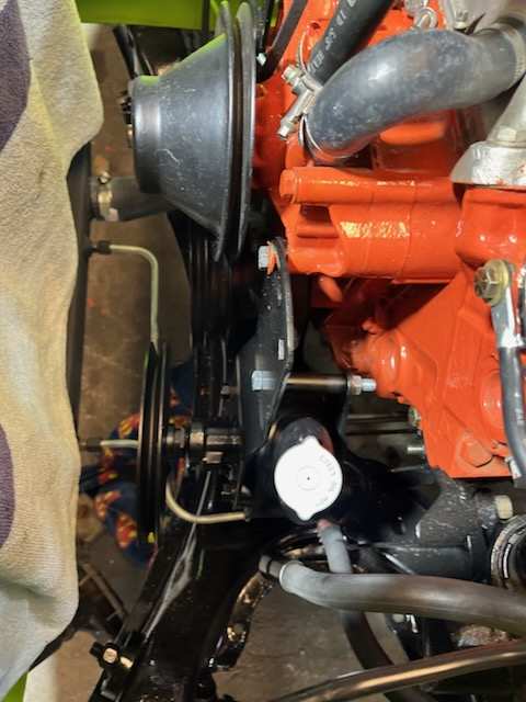

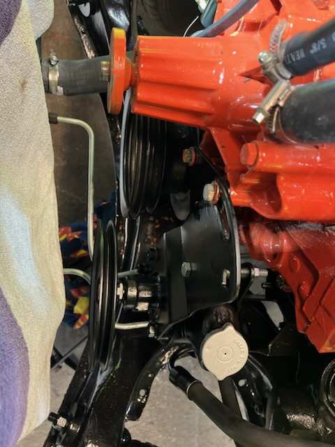

Ok latest update. Radiator in. Had to get different hoses as the aftermarket outlets were in a different spot than stock but I wanted the beefy radiator to cool the hopped up 340. Finally got the right alternator brackets. Then I clean up the power steering pump and install it. Original car was a 318. My PS pulley is like 2.5" forward of the crank pulley. What am I missing??? See pics.

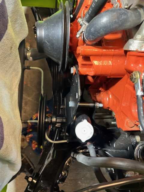

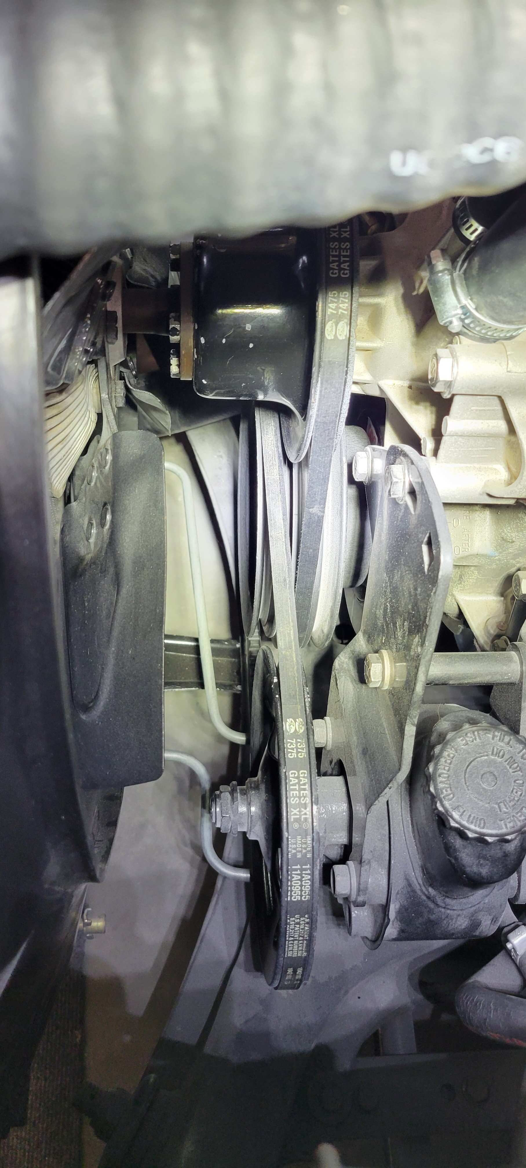

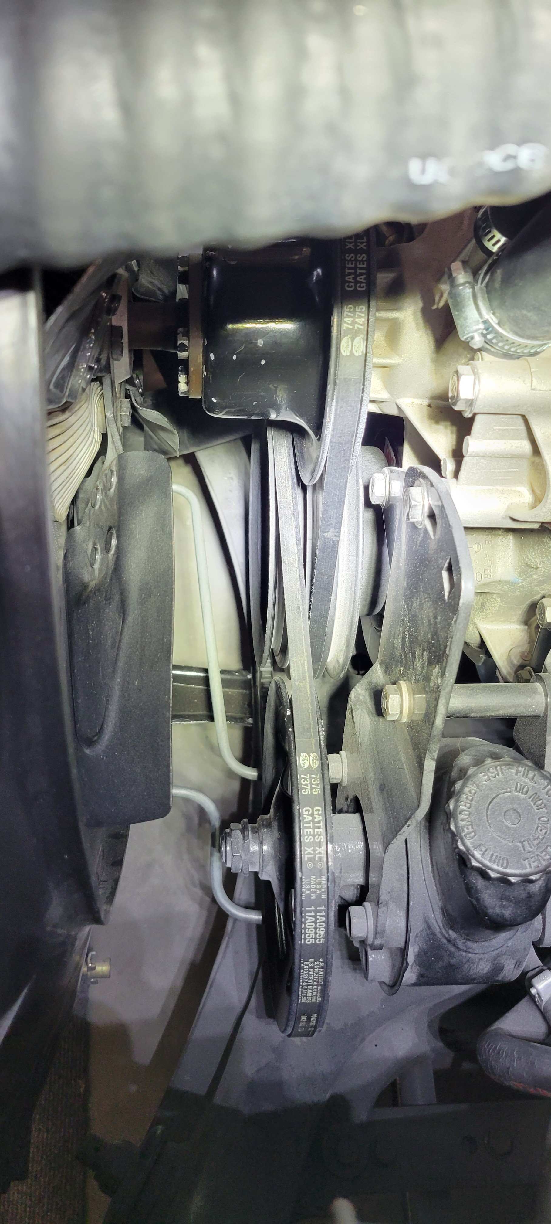

Here is the alignment on mine. Obviously if the other pulleys align, you gotta have the incorrect pulley location on the PS pump via an incorrect pump or wrong PS shaft?

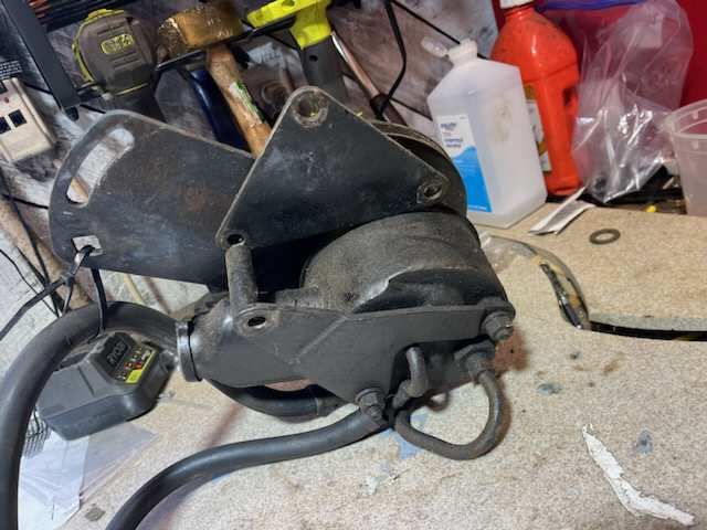

Thanks....the aluminum water pump is more forward...so the PS pump needs to be closer to the back...I found there are 2 pumps for the year...one is like what you show...there is another that is back a few inches.....thanks again for your input!

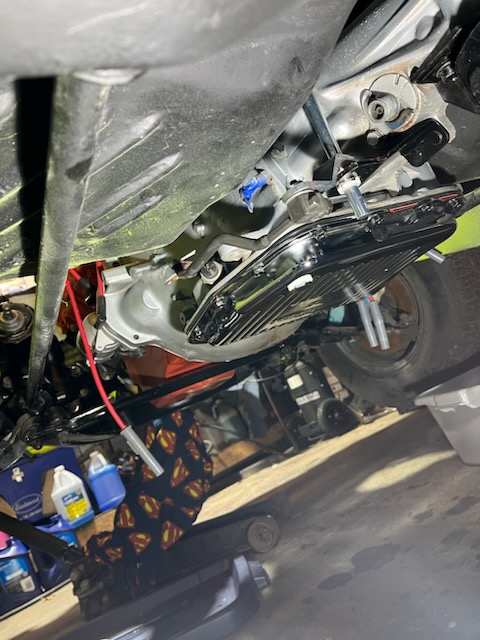

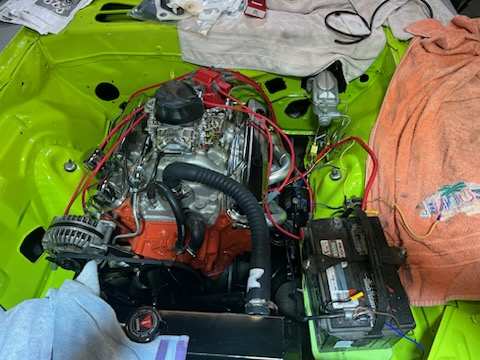

OK here is an update. PS Pump IN - had to buy new one that fit. Had to replace alternator to a SINGLE wire as the American Wire Kit does not work with the stock MOPAR set up. I have an HEI set up anyway. Got 14+V while running. Primed the 727....overfilled it a bit. It told me so by leaking out of the Speedo spot. And for good measure the first Neutral Safety Switch I tried was bad out of the box. Last battle - Driveshaft. Car came with a 904 and the old shaft is too long. I am having one built with the right yolk. I will be able to do a driveway burnout in a week! TJ
If you put a alternator gauge on this please share. I am getting ready to put the same harness in my car. I bought the alternator and have been wondering what to use to monitor state of charge.
Put you a digital voltage limiter as well to protect your gauges.
I saw a few articles....there is a diagram out there......also send a note to the tech suppport peeps they are REALLY good about getting back to you....they actually gve me instructions on how to bench test my dash to check the gauges....
Forgot to mention got the motor purring at 12 Deg

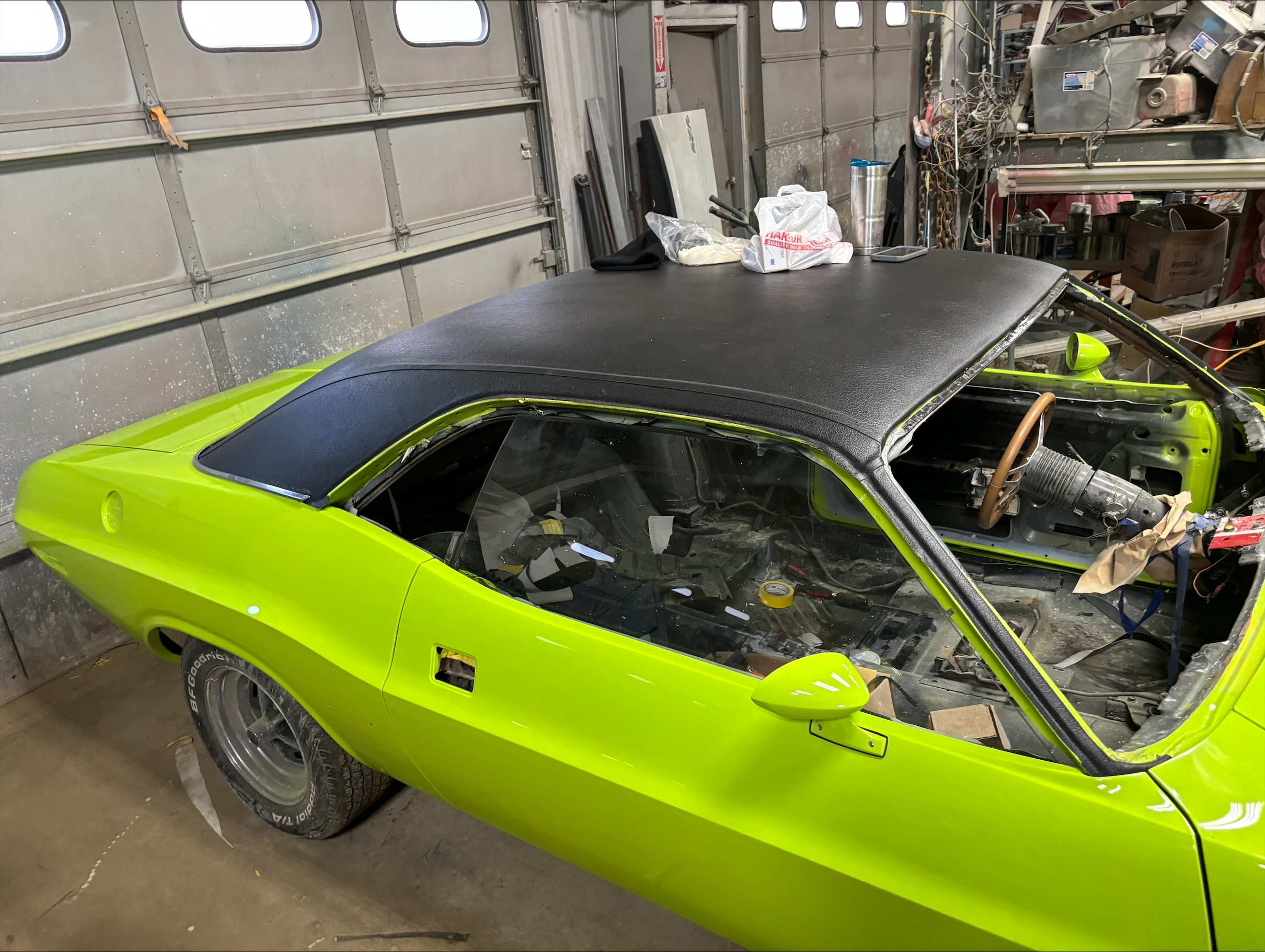

Todd Jackson
Nov 5, 2019
161
77

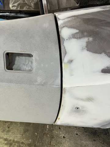

Updates - lots of finish work on body. Tranny in. Had to have driveshaft MADE because the 904 was too long with the old 318. Exhaust in from front to back....
