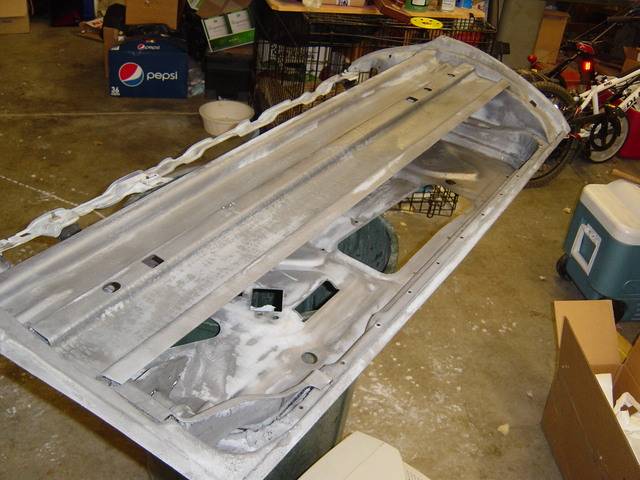

I also had a rusty door shell that I tried sandblasting without success. I was able to electrolytically derust it in a plastic trash can, one half at a time. Look at the bottom corner, there was heavy rust that the blaster couldn’t get to...
The process is simple and dirt cheap. All you need is a battery charger, a piece of re-bar or scrap iron, and some Soda ash which is sold at Home Depot in the swimming pool section to raise ph.
Look up “electrolytic rust removal instructables”
This process can be used on tools, nut & bolts, brackets, etc. but not springs. It makes them brittle.
