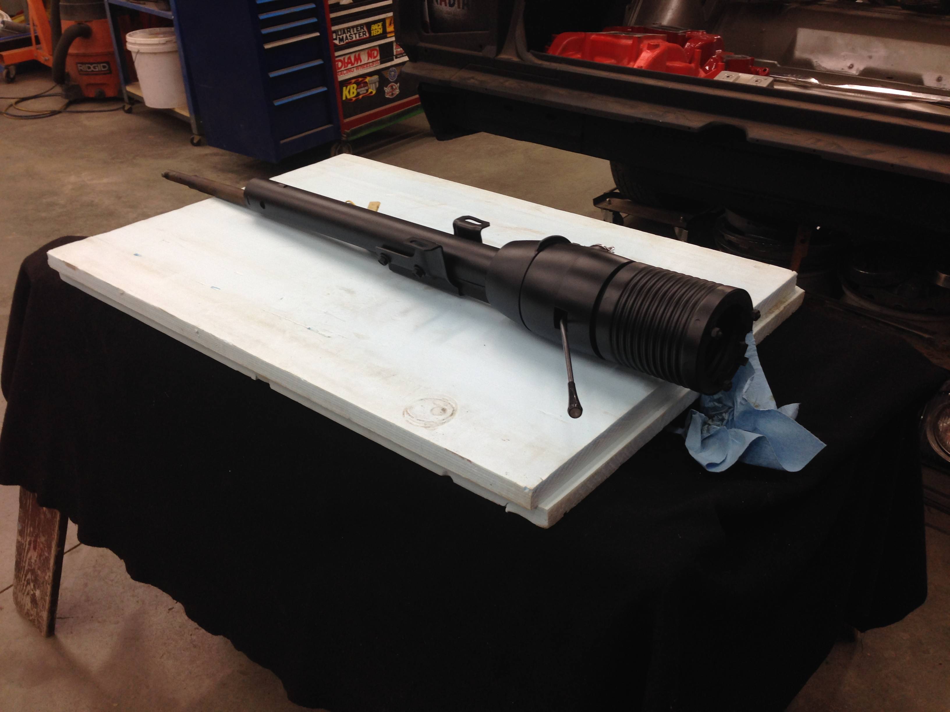

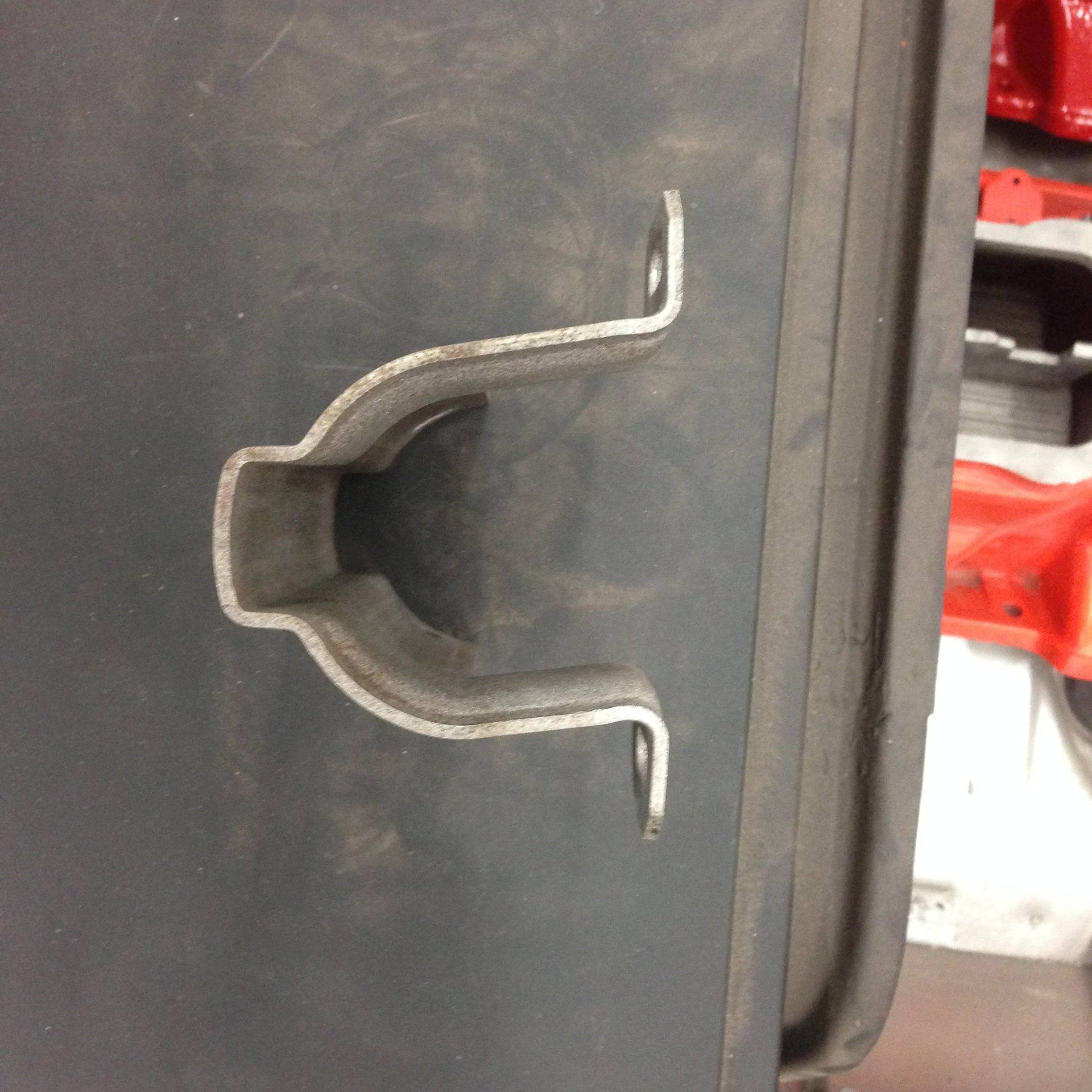

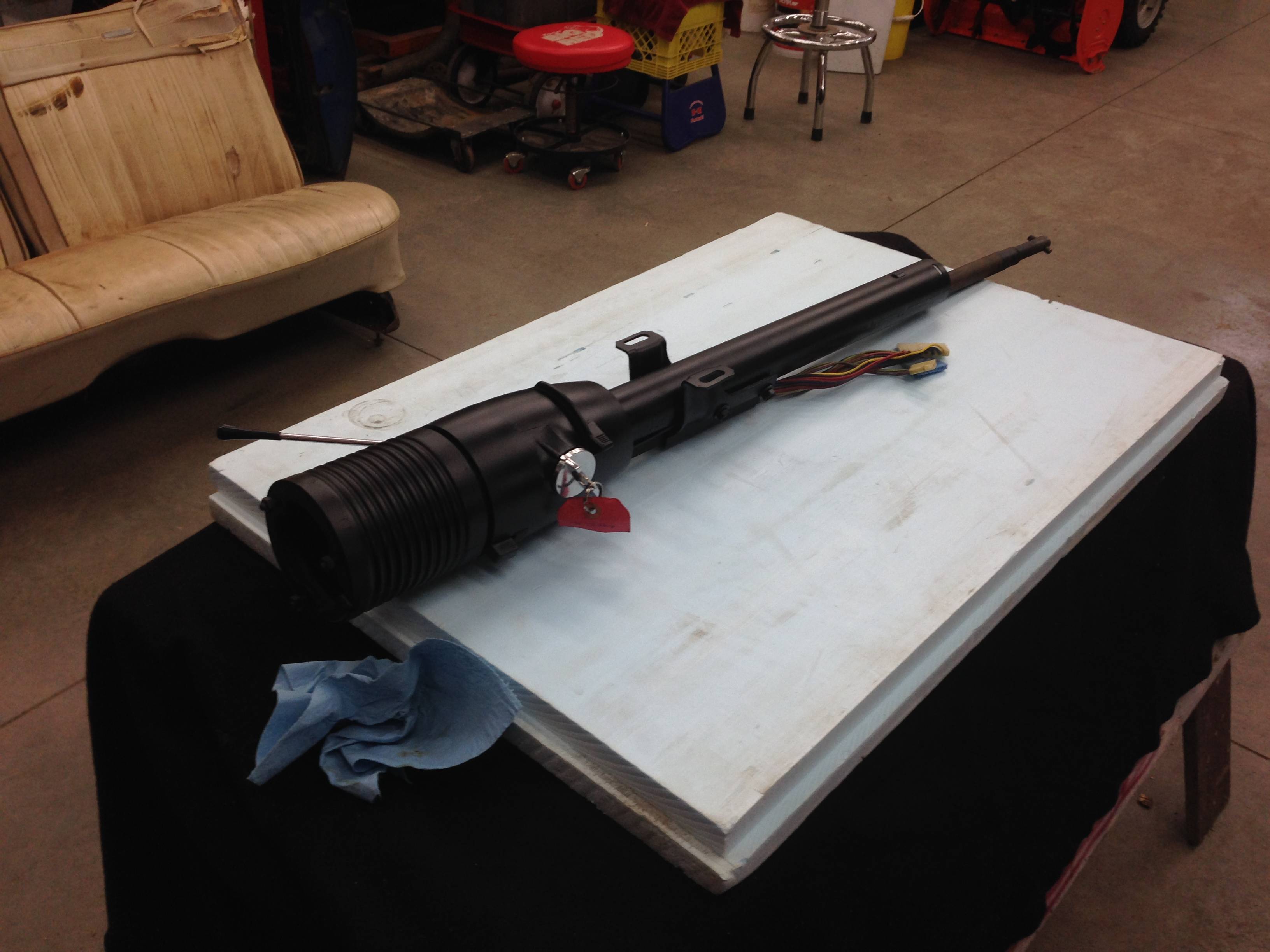

Well, I decided to mess around a bit today. I pulled the column I picked up a couple weeks ago apart most of the way and blasted and painted it. I need a new "instruction" insert for the key release. And I see the column to dash mount has a bend to it, but it fits everywhere, so I wonder if they are like that to offset the column. I also am missing the bearing or bushing at the bottom of the sleeve. I'll give it a couple days for the paint to harden and then re-assemble it.

Very nice job on your steering column. Isn't it a great feeling to go take a grungy looking part and turning it into a thing of beauty. Nice work. I have the same issue sometimes in moving on to the next step before it's maybe ready.

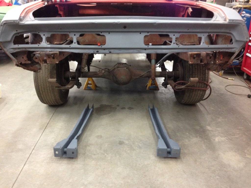

Over the weekend I picked up a trunk pan and two rear rail repair sections. The rails were surface rusted from sitting in a car for a long time. I made an electrolysis tank and gave them and bath. It works great. Leaves very little to blast. Then I hit them with glass bead, probably 1/2 hour worth each, and they look like new. I forgot to take a before pic but here is one after the tank and a wash off and then one after blasting and ready for self etch.

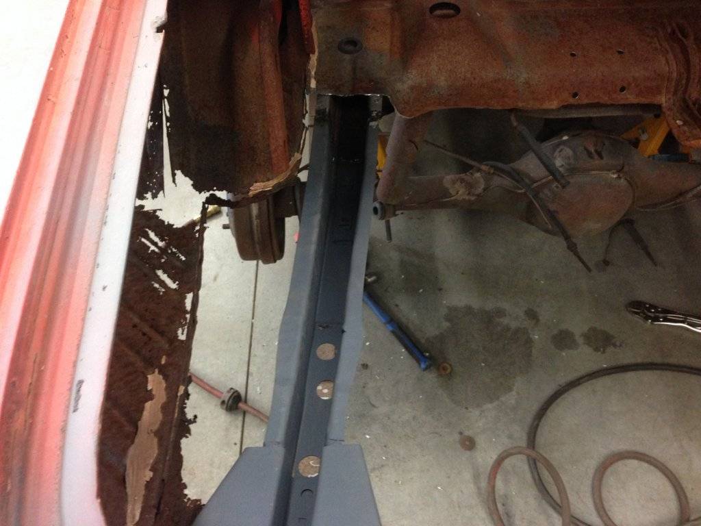

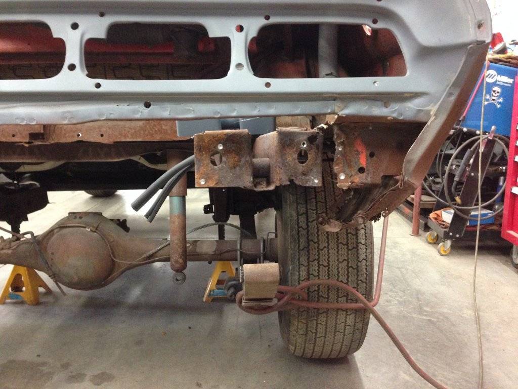

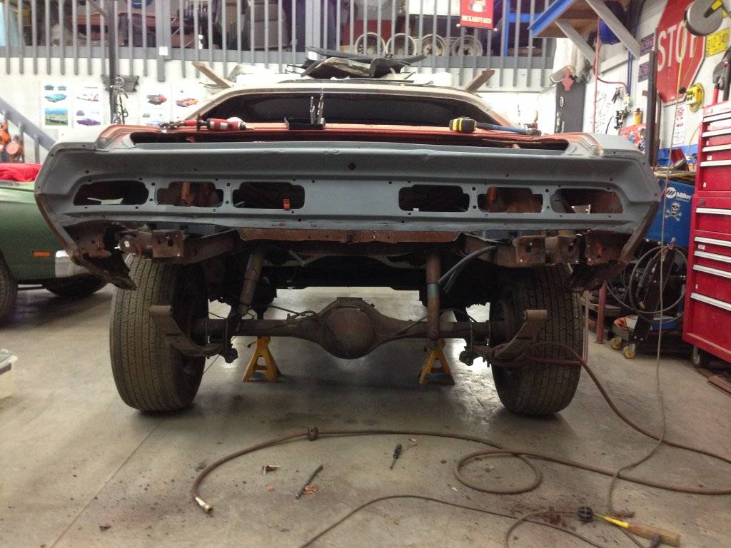

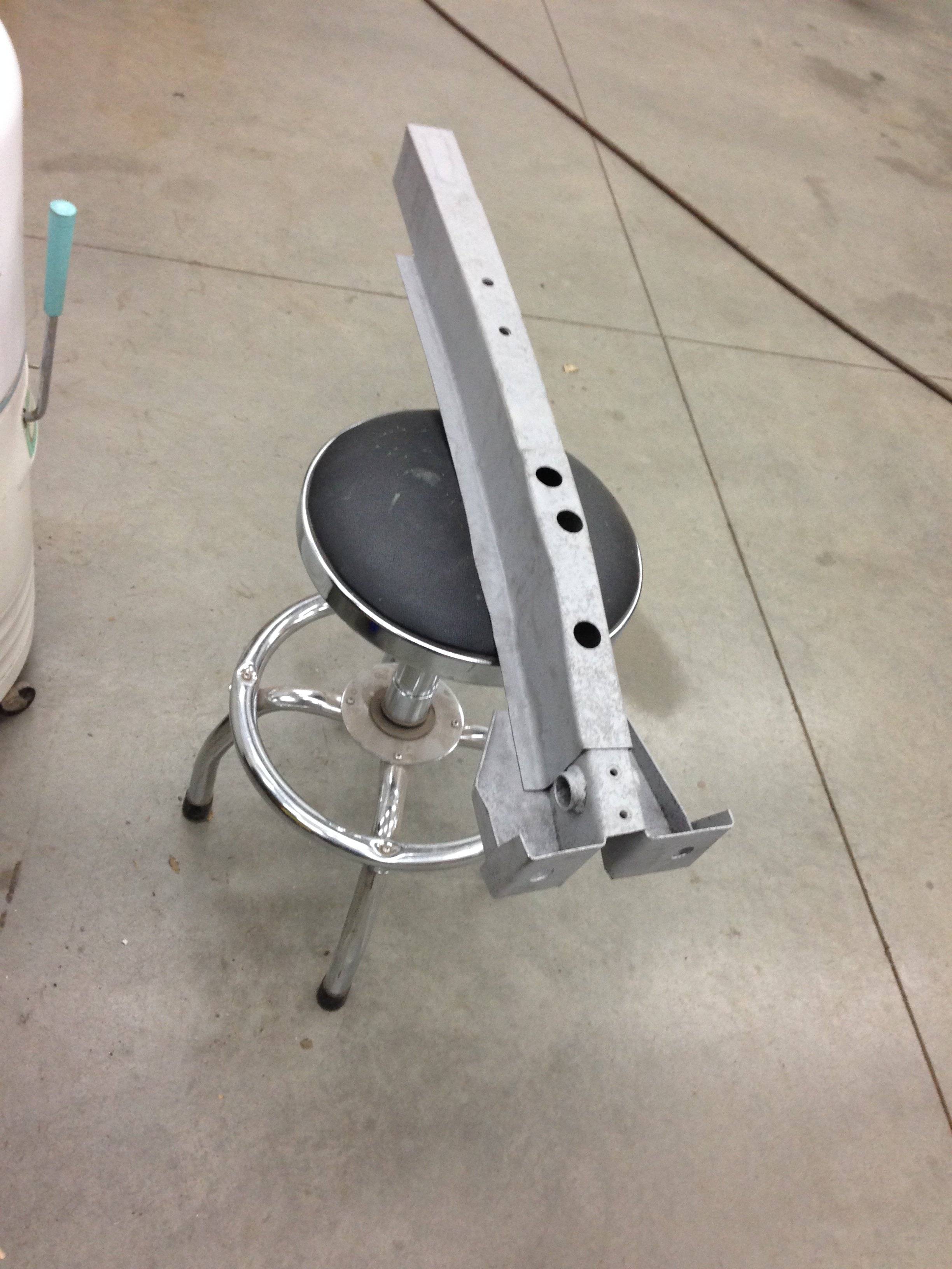

I figured it was time to pull my balls out of my purse and attack the rear frame rails. Measure 453,217 times and cut once! I discovered that the aftermarket rails are slightly different than stock. Good thing I am a measurer. I took my original measurements and cut the old section out. When I started comparing I discovered the back bumper / spring mount was slid onto the rail about 1/4" further than the original on the new piece. That would have sucked as the bumper mounts and spring mounts would have been 1/4" further ahead than they were. Probably acceptable by factory tolerances but not by mine. Anyway, I got the driver side done and will do the pass tomorrow.

Yes, the steering column collar is supposed to look like that.

Thank you quapman, I figured it was a strange place to get accidentally bent.
I finished the pass frame rail change out and repaired the tail light panel. It wasn't too bad but I had to section in a piece in the middle at the bottom. The rails are welded both inside and outside. Now I just have to clean up around the wheel houses so I can fit the pan.
