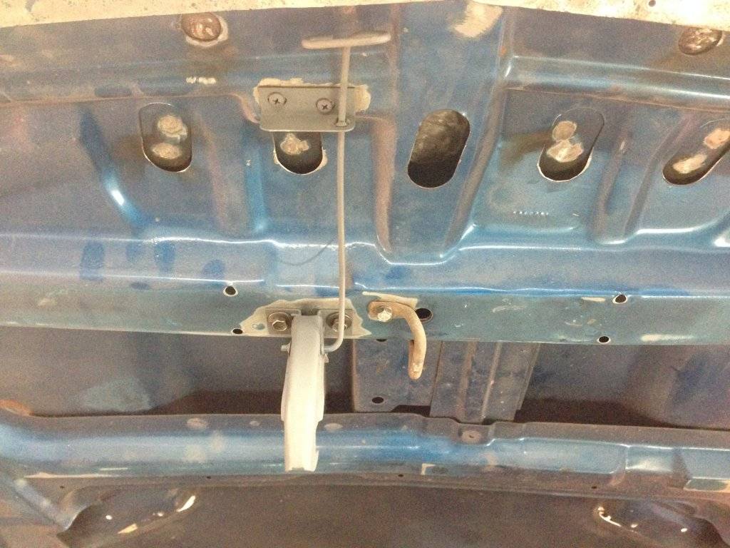

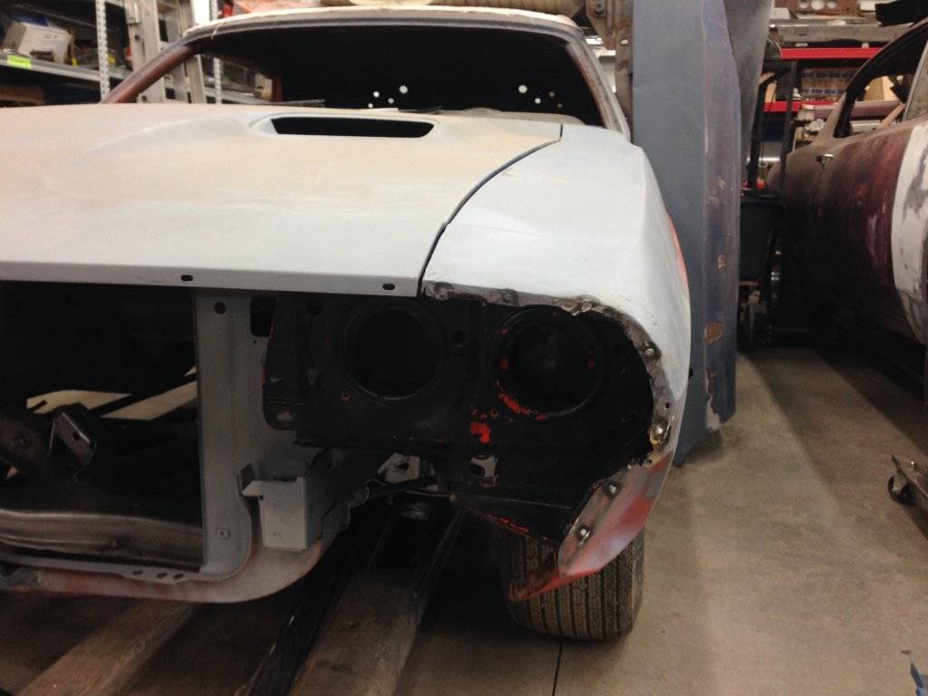

I was playing around with the parts I bought and realized I didn't get the latch assembly with them. Fortunately the 73 car had it. My hood is mounted along with another fender I recently acquired. I now have 3 driver fenders and have to decide which is actually the best one to use. All have their own little quirks of course. I also learned there are a few differences between 70 and 71. The little cut out on a 71 is the first. I think it is for the grill somehow. Next was the hood rubber stops. On my 70 fenders it is behind the rad support whereas on the 71 fenders it is in front of it. I believe this to be correct as there are no alternative factory holes in either.

........I also learned there are a few differences between 70 and 71. The little cut out on a 71 is the first. I think it is for the grill somehow. Next was the hood rubber stops. On my 70 fenders it is behind the rad support whereas on the 71 fenders it is in front of it. I believe this to be correct as there are no alternative factory holes in either.
Those cut outs are correct for a 71 but nothing attaches to them. Starting in 72 there is a grill bracket that fits into those slots. The factory must have been looking ahead to 72 and the re-design of the fenders and grill. The hood bumpers for the 71 are in front of the rad support.

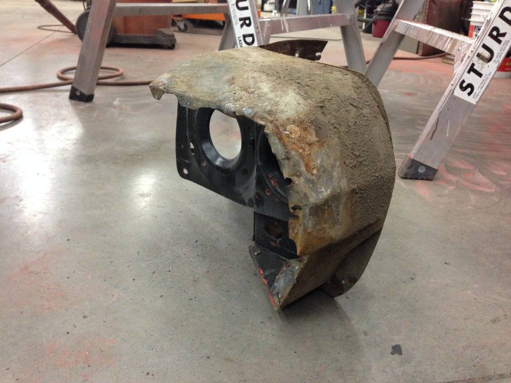

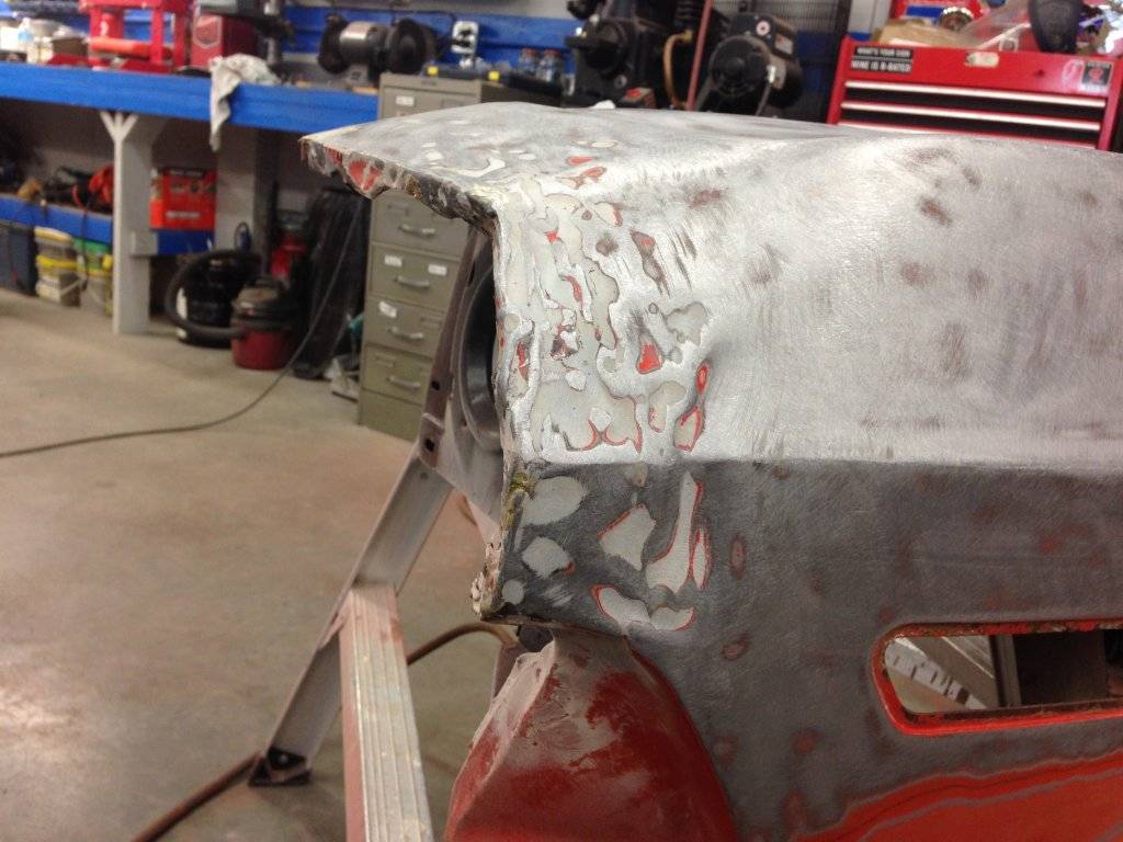

Thanx, good to know the real reasons behind all the details. I decided to clean up this fender. I was worried it would be rusted like the other I got with the car originally. Turns out it is rust free but has a repair in the front. I should be able to get it a little better than it is. Other than that it is in beautiful condition.

That doesn't look bad at all. I would cut the front headlight bucket out and have at it. Make some patterns off the right fender to guide you as well as fitting a headlight surround to make sure it fits.

I think that's what I'm going to do. It looks like the fender was repaired on the car originally not allowing access to the underside. I agree, with the bucket out it should clean up almost perfect.

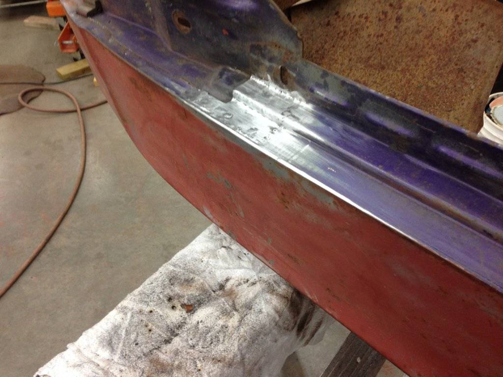

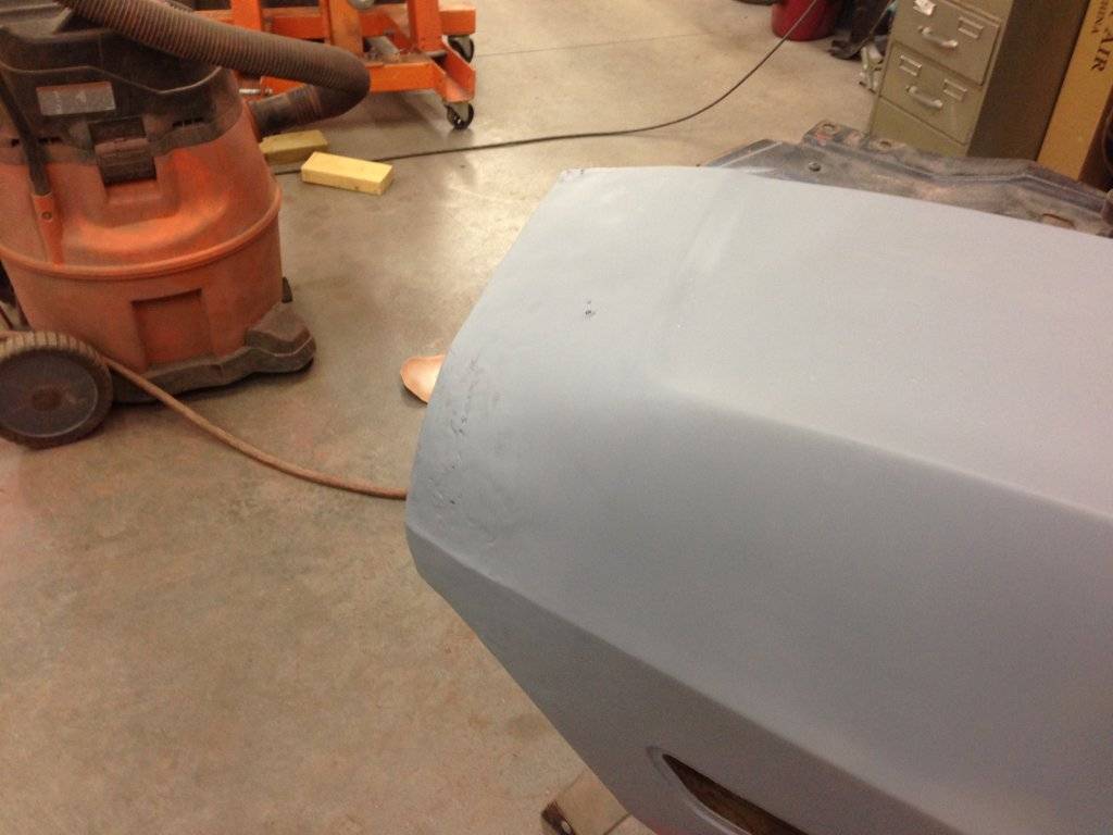

Well I got to work on the fender. I'm happy with my work but still not sure which fender I will use. It came out pretty good, considering all the work that was previously done. I had to fill holes and grind off brazing. It will require a skim coat of putty to finish, but definitely way less than before. The headlight pot turned out well too. Using the headlight surround is a great idea, as you cant tell how straight thing are without it. I'll reassemble it tomorrow.

Nice: It's silly I know but I try to use the parts that came with the car off the line when I can. No one else knows but somehow it makes me feel better.

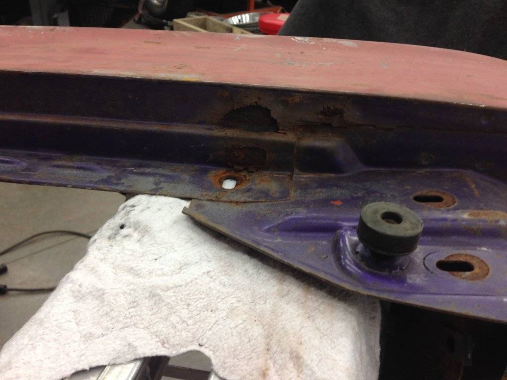

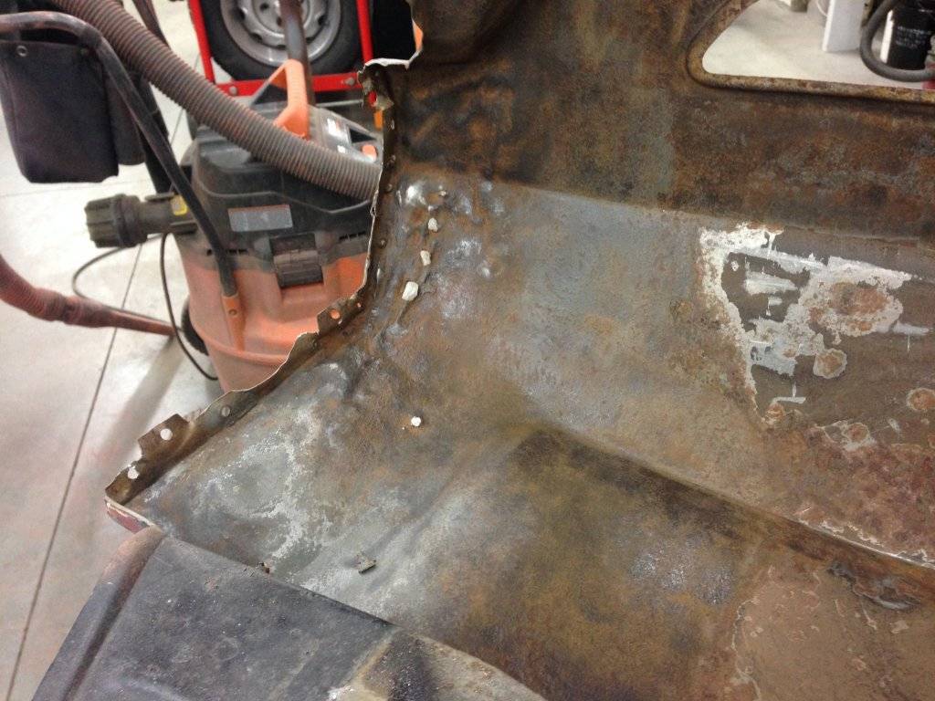

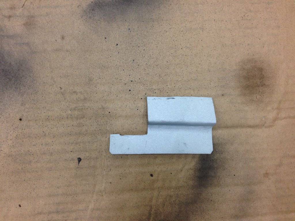

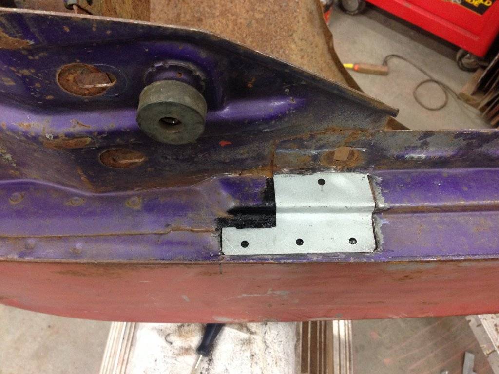

My passenger side leaf spring hanger mounting area was hit at sometime. The bottom was pushed back about an inch. I decided to take it a part and repair it. Then I cleaned up some more rust in the wheelhouse area. I have yet to do the other side the same. Once I complete these I should be able to install the pans. I think I can repair the inner wheel houses with the pans in, I just wont weld those edges. Man it will be a different car then.
