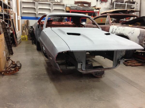

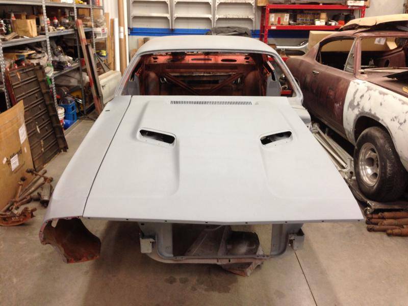

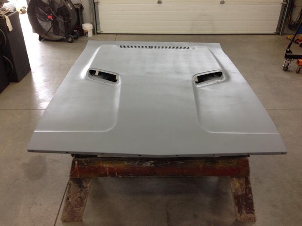

Today's efforts. The hood was previously sanded down. I'm not sure if it is warped or not. I carefully took it to 80 grit and primed it. It seems really flexible to me. I didn't realize they were so delicate. Once it is good and dry I will feel it up to see if it is too bad to use. It is a different year as the "DODGE" holes are welded up, but I'm OK with that if it is straight.
DetMatt1
May 13, 2009
8,151
2,271
Metro Detroit
That hood shouldn't feel flimsy at all, should be quite rigid. Is it rusty? Is the skin secured to the frame all the way around?

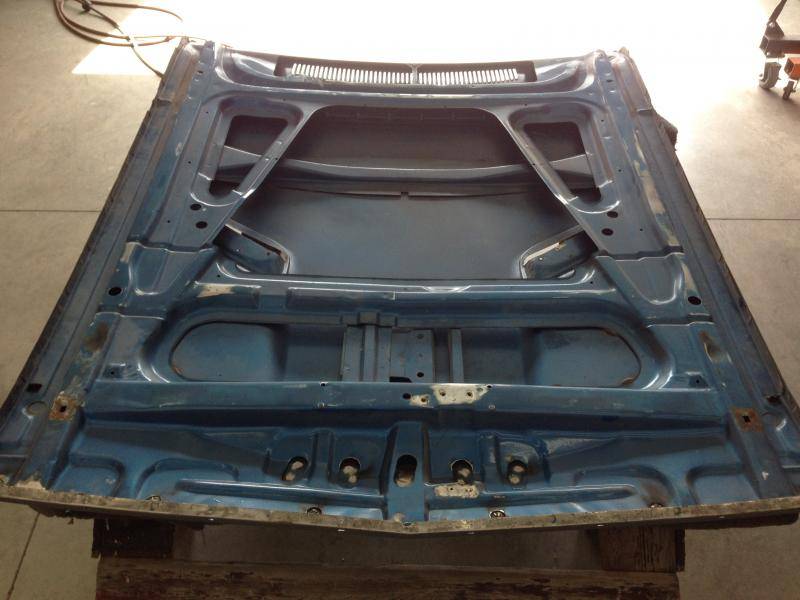

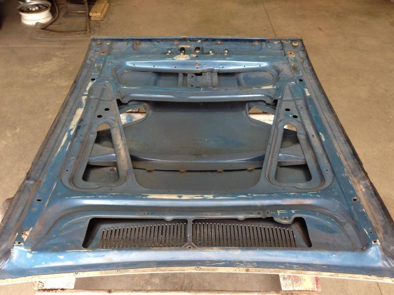

Well, I had a closer look at the hood. It seems that the glue on the framework has lost it's grip. Perhaps that is why it seemed to vibrate on me.

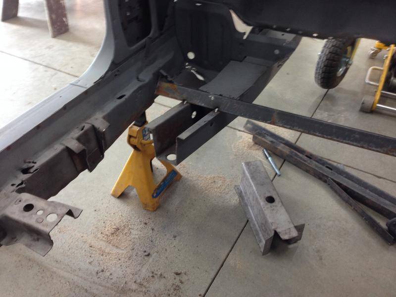

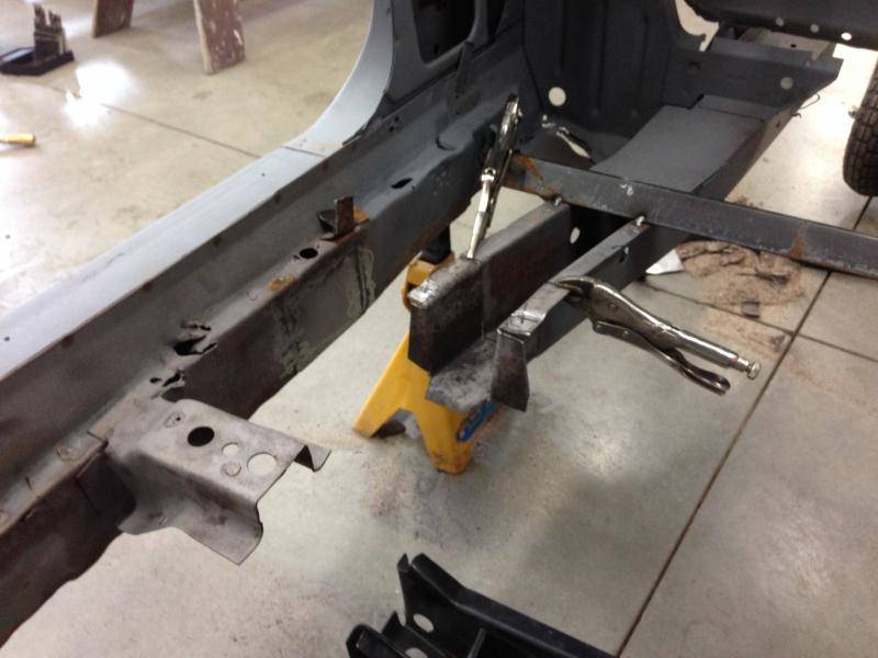

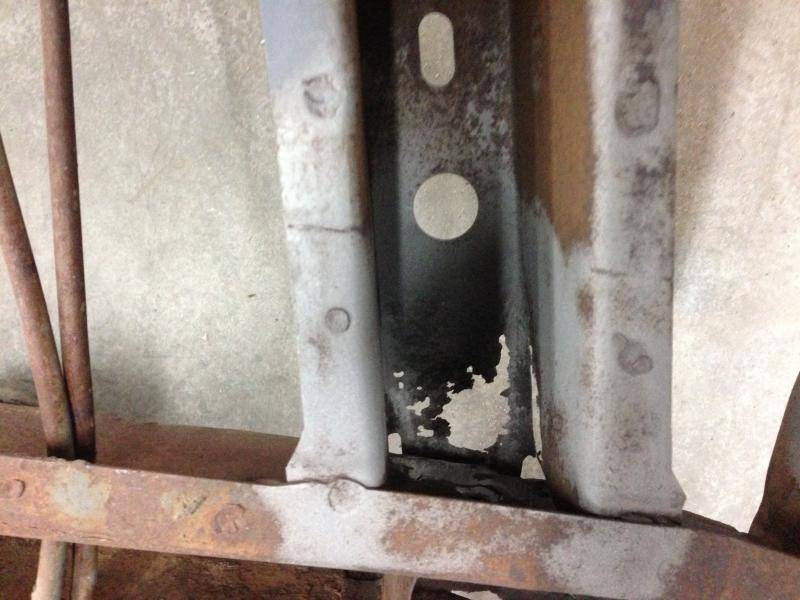

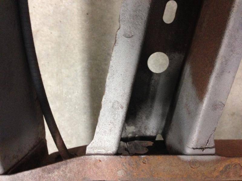

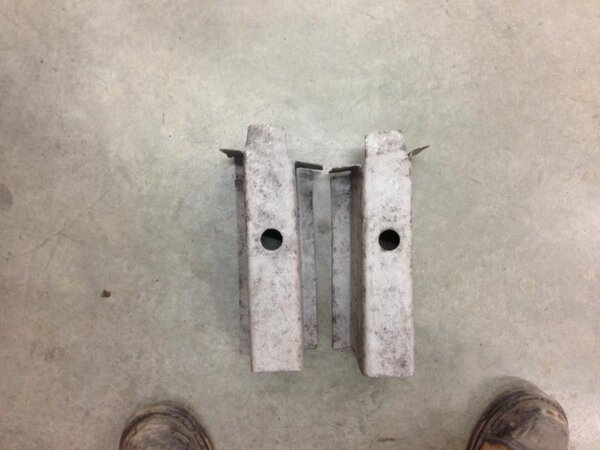

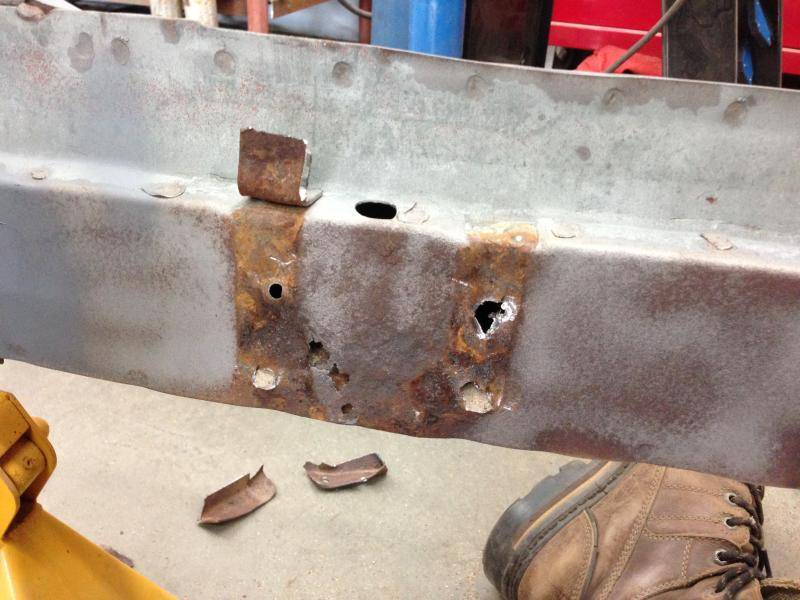

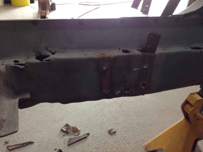

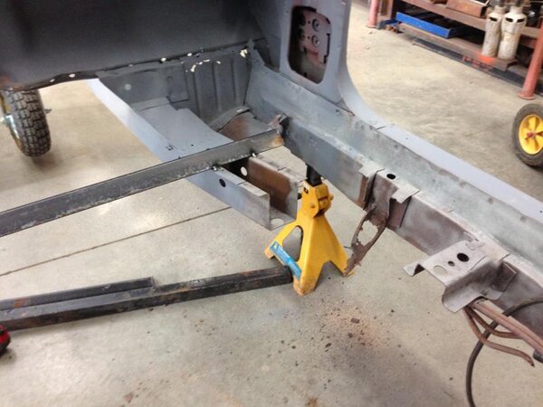

I think it is time to take on the torsion bar cross member. But before I can change it out, I have to repair the ends of the rails. The member had rotted ahead into the rails a couple inches on each side. I have a friend who is parting a car out and I salvaged the sections from it. I will chop them down to fit and then tackle the cross member. Funny how some cars rust out in certain places and others are perfect there but rotten somewhere else!

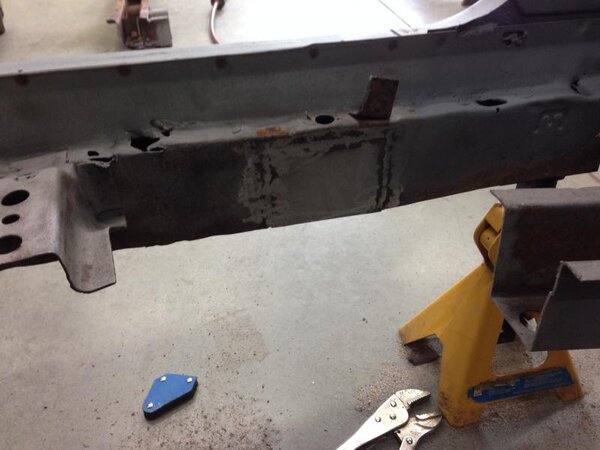

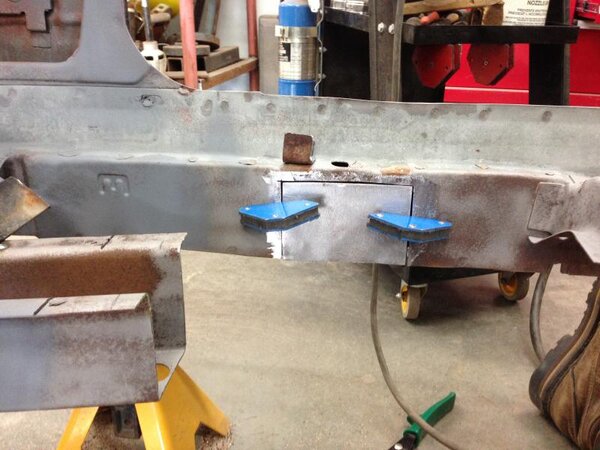

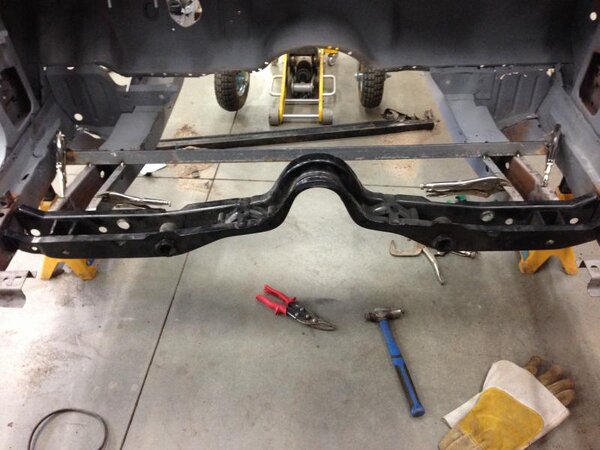

Feeling brave today.............I got the body level, welded a brace across the rails, made some measurements and then cut away the ugly!

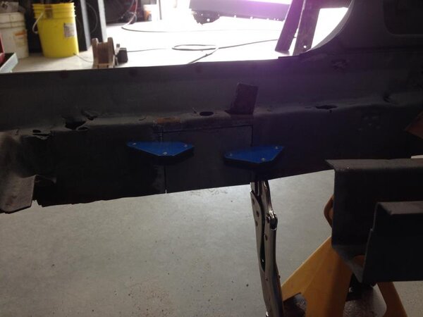

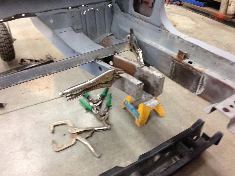

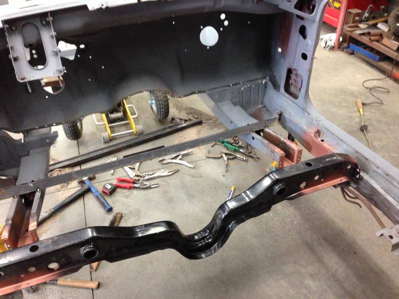

Test fit prior to making it a permanent fixture.
Prepped and ready to be permanent.

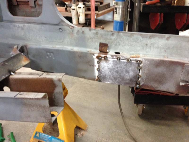

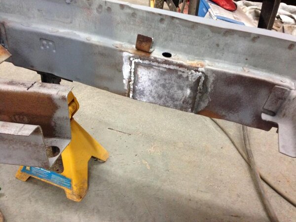

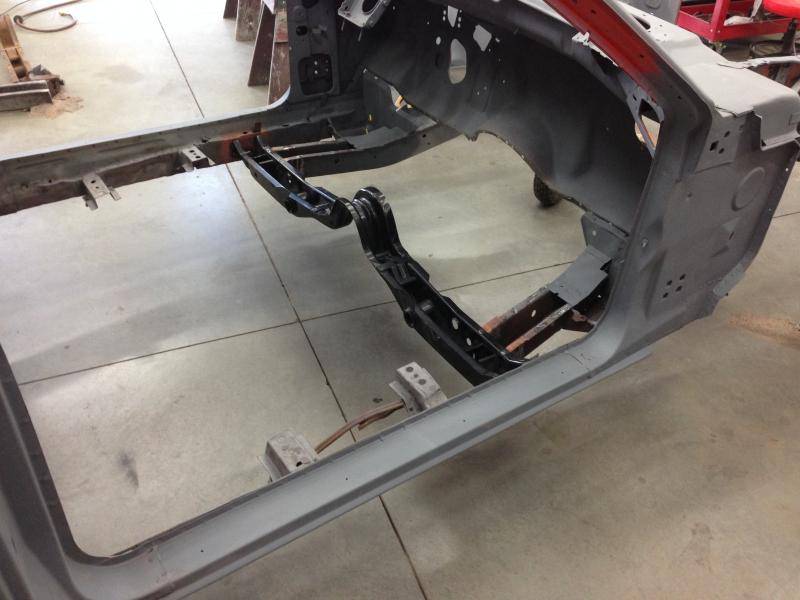

Well, it is a done deal. I welded inside and out on the frame stubs and gave the torsion bar cross member a few extra welds too. That pretty well wraps up the front end of the structure for repairs.

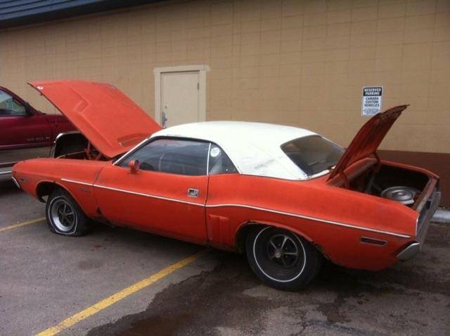

A little update. I have not fallen off the face of the earth, but the work on the car is paused. The main rust is gone and that was the goal. I have other stuff to finish first and in the meantime collect parts for this baby. Now I know it was a long shot but I posted an ad on Kijiji looking for the original engine. This car was parted out in the 90's I think, so it was unlikely. Well I have found the trail, and a lead on the original engine. I have no idea whether it will ever end up back in the car, but I have the full story of how it came to me. It has been through three owners between myself and the original, but they never registered the car. So I will technically be the second registered owner of this car. ( Done deal, I registered it on Saturday :) )I am going to continue the search and see if I can contact the original owner to see if they have any pictures of it in the '70's. Here are two pics from the second owners property where the rally cluster, dash panel, engine and already replaced 1973 727 transmission were removed. I'm surprised but not surprised. Alberta is small and the Mopar crowd is even smaller. And the fact this was a stripe delete RT really helped narrow down the trail. It just goes to show even after 20 years or so there is still a chance of reuniting original parts!
Edit: The picture also helped me know what wheels came on the car. That is the only spot on the build sheet that was ruined beyond identification.

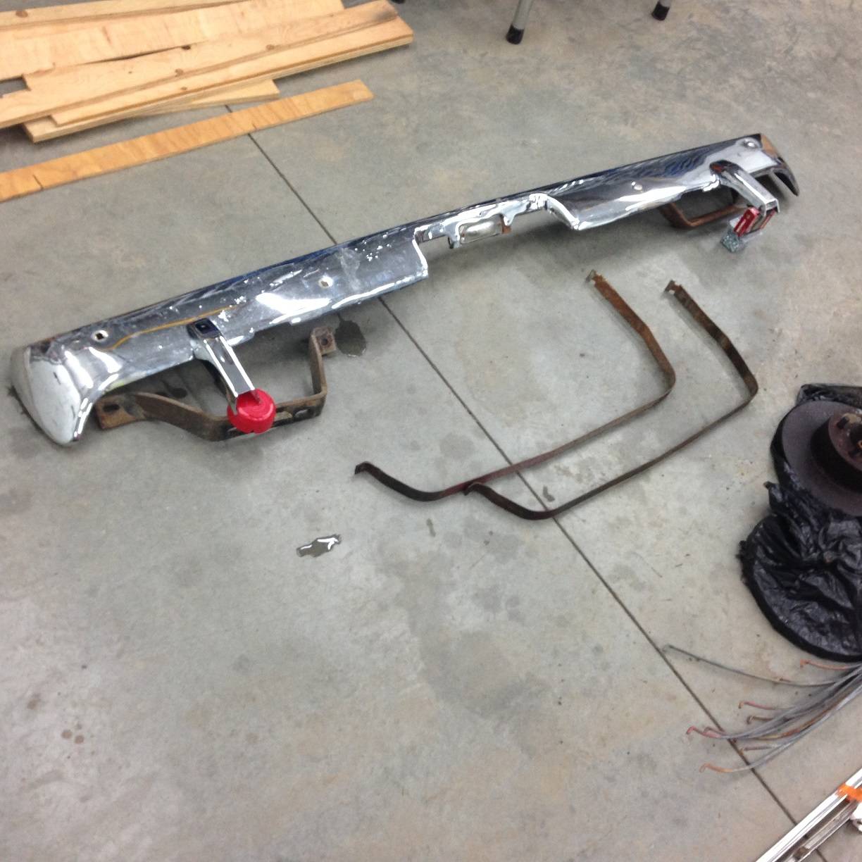

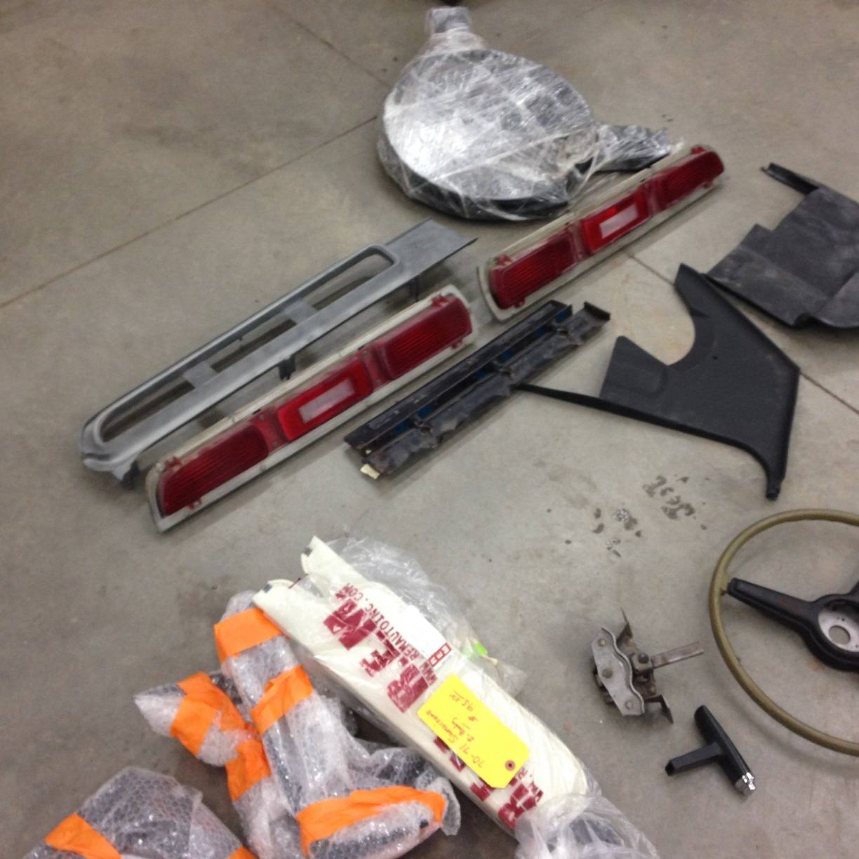

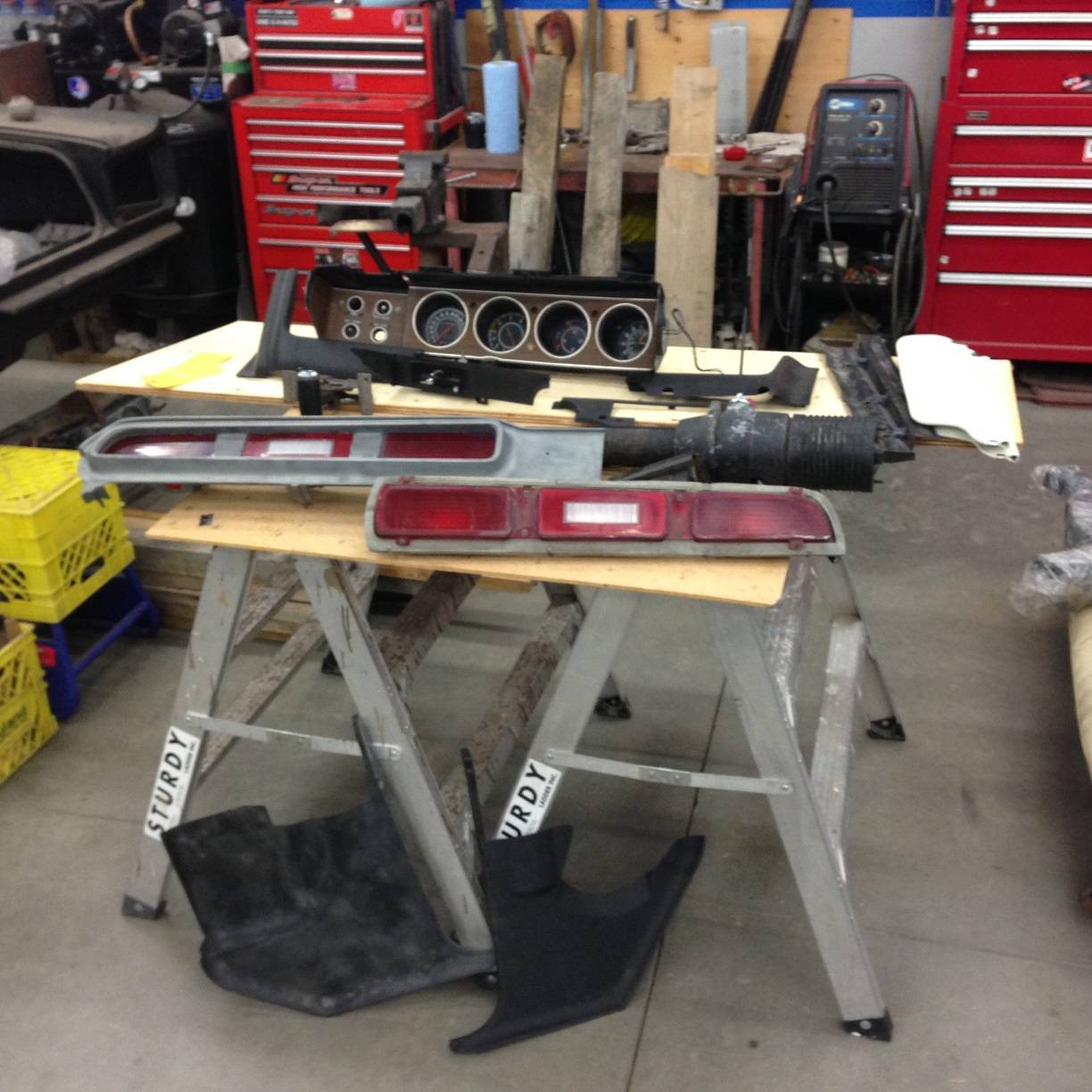

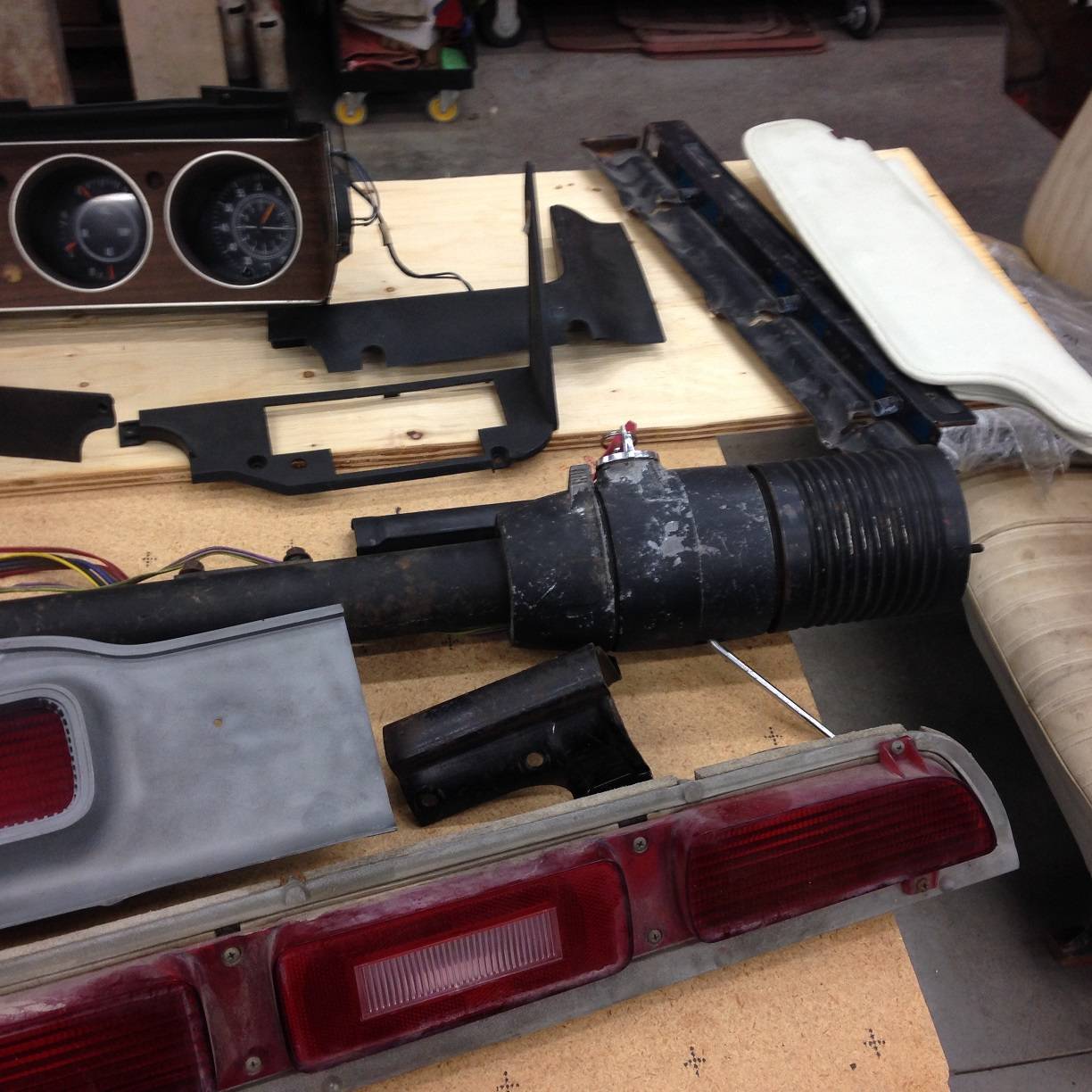

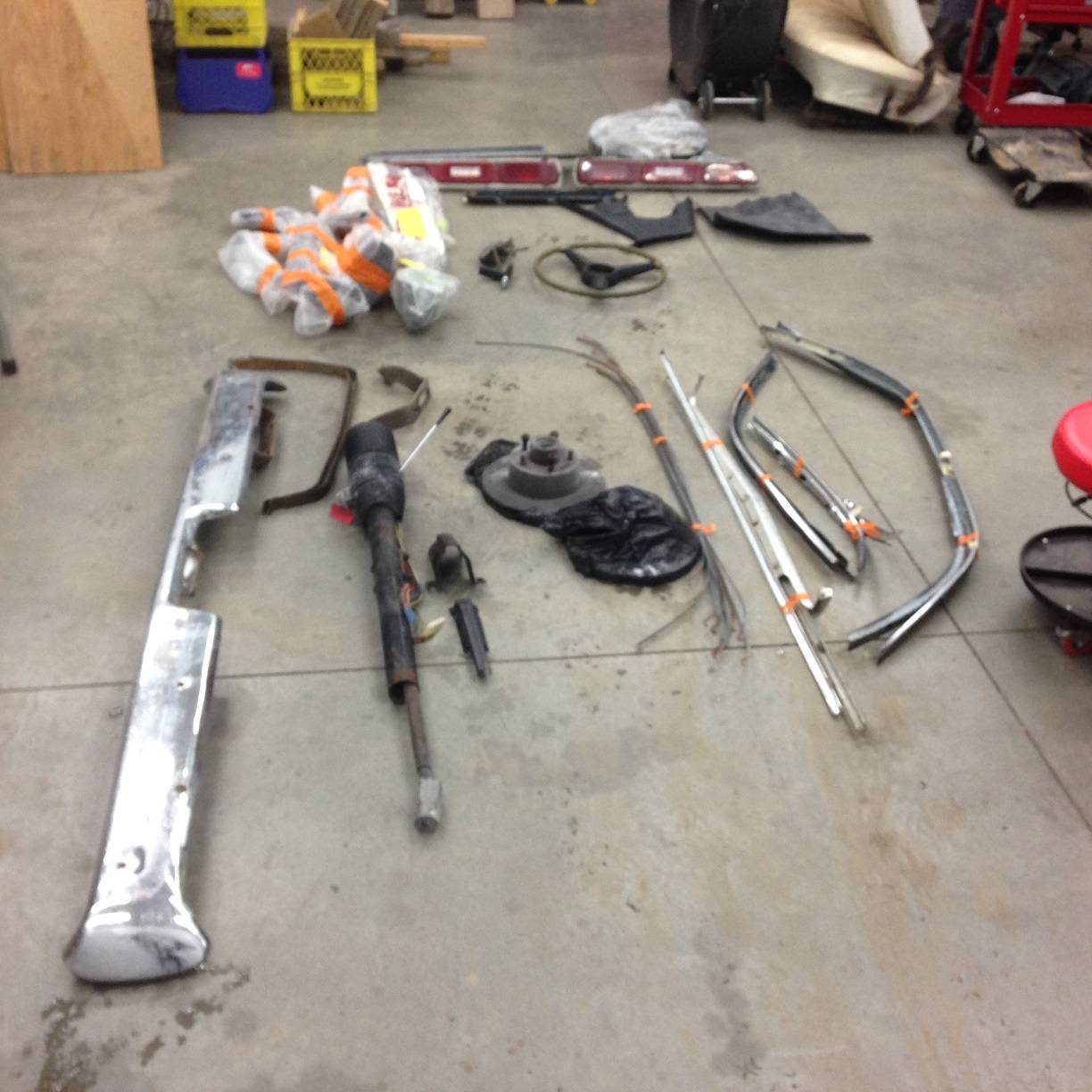

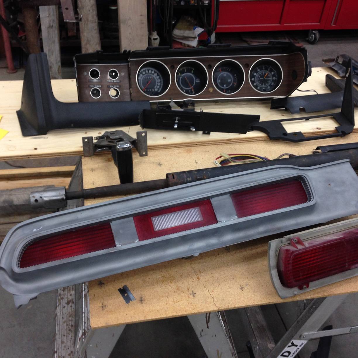

Well a buddy and myself went on another little road trip today. We met a very cool fellow who contacted me saying he had some Challenger parts he did not need. I got a pretty good haul and picked up my freshly restored air cleaner that is part of the engine deal I made earlier with another guy. The rally cluster is 72-74 but that isn't critical to me. The control panel even has rear defrost which my car has. The clock is freshly rebuilt. The bumper is 70-71 and the bumperettes are freshly re-chromed. The column is 71 and has a key. I got most of the dash plastic with heater controls and some kick panels. The visors are beautiful, might even be new. Got a bunch of chrome trim for around the doors, the hood molding, the trunk molding and a piece for the grill. Headliner bows as well and gas tank straps. All this excluding the air cleaner cost me $1000. The guy was super fair on his pricing as far as I'm concerned. None of the stuff is mint condition, but it is all very good for restoring and using in my car. It's nice to see some guys out there still just appreciate the hobby and aren't out to make a fortune on everything. He has a few more parts I'll go back for later. I forgot the slapstick shifter mechanism!
