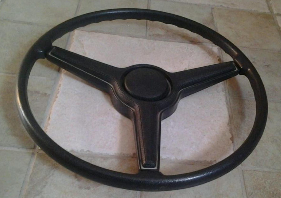

The following image shows an actual steering wheel:
This pictured wheel is a 1971 version with a textured rim. The 1970 version for similar models had a smooth rim.

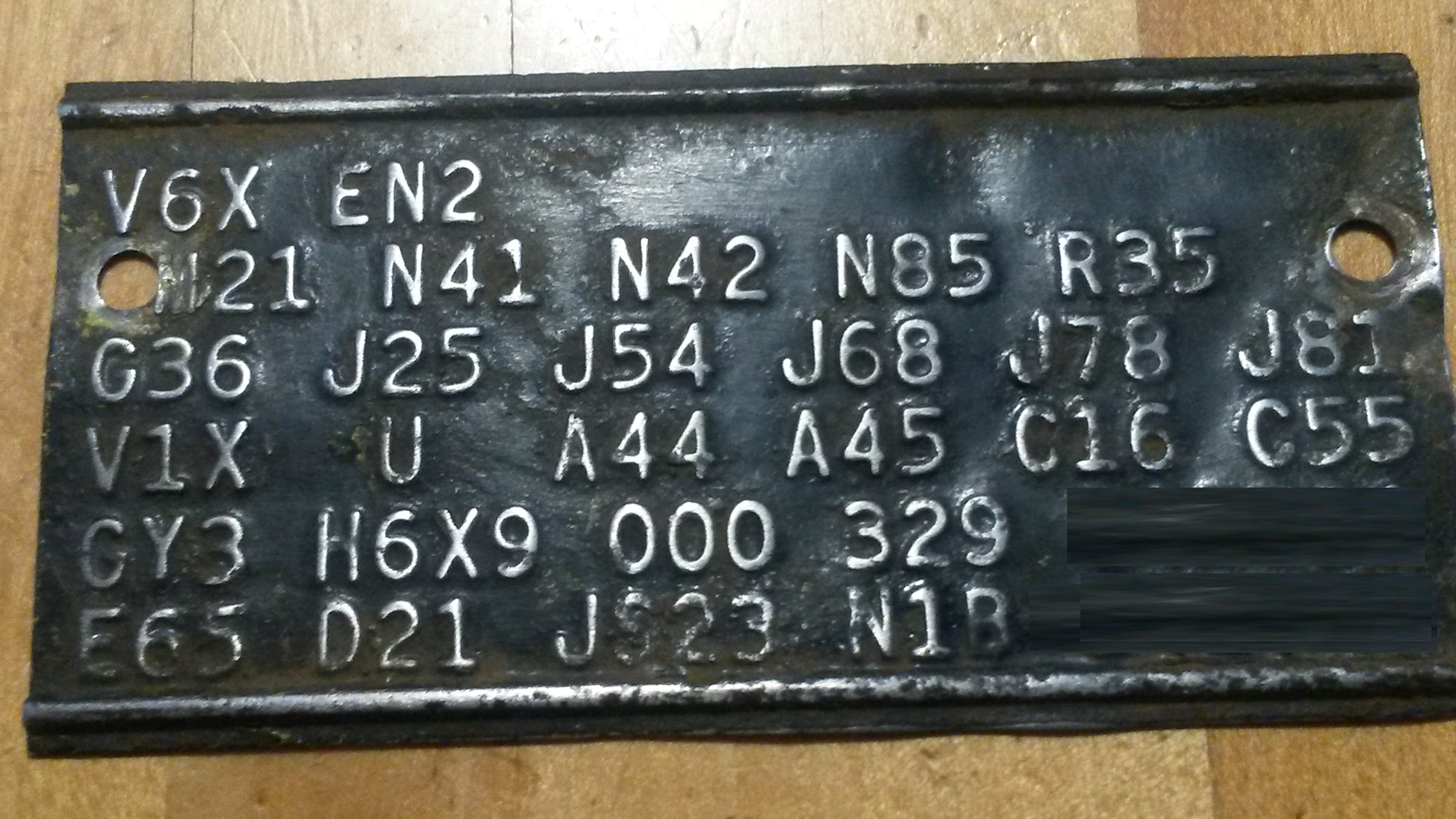

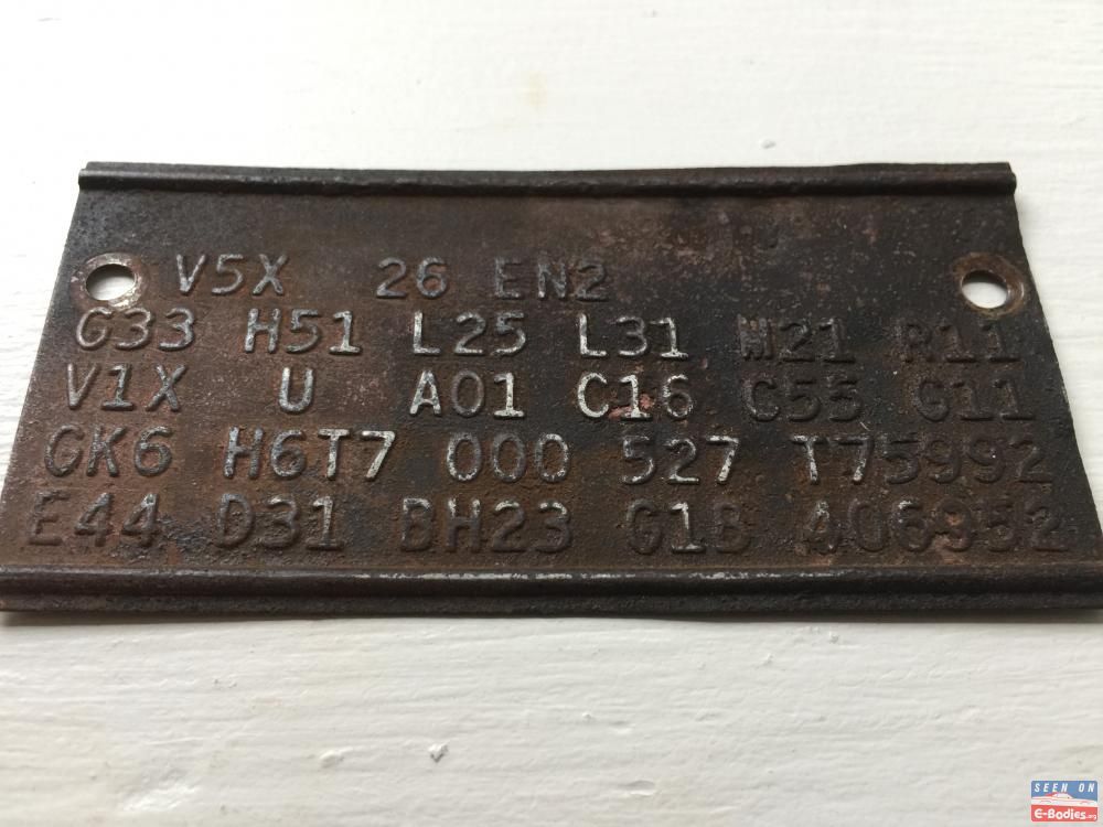

Your tag would look similar to this 1971 BH23G1B fender tag. It was the closest one I had.
I don't think I have seen J55 on the tag. It will be on the window sticker and broadcast sheet. Just my 2¢.
Take note, G11 G37, J54,J55. No J55 on tag
From what I understand , this one has one of the rare options. M73
Rare options on this one.
