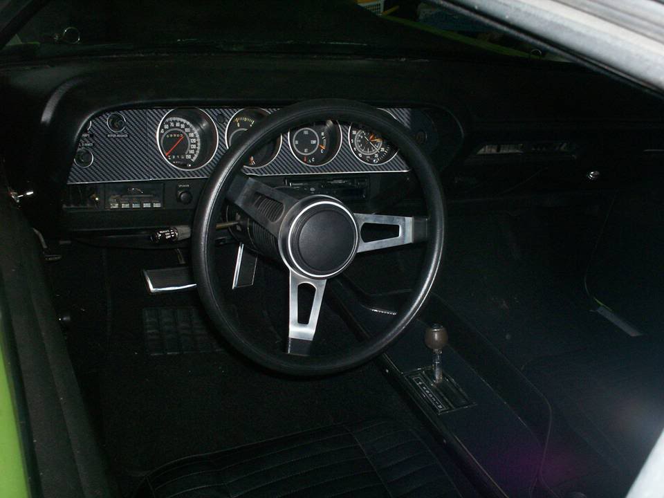

I have the same wheel on my 70 Challenger and I had to open up the 3 screw holes a bit but know real issues. You will need a horn button kit from Grant.

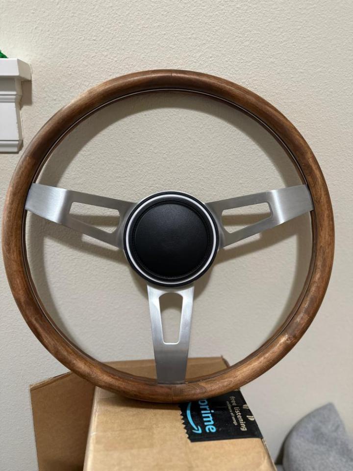

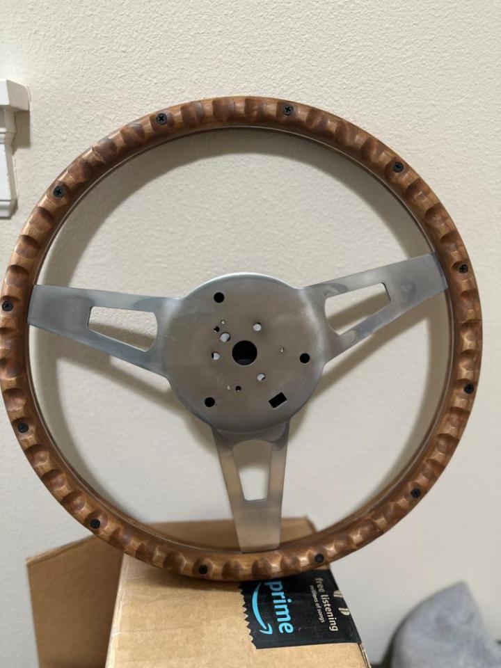

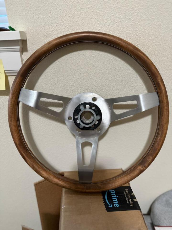

I sent back the wood wheel. The wood joints were separated and the wood sandwiches the metal, which is visible, making the grip to thick.

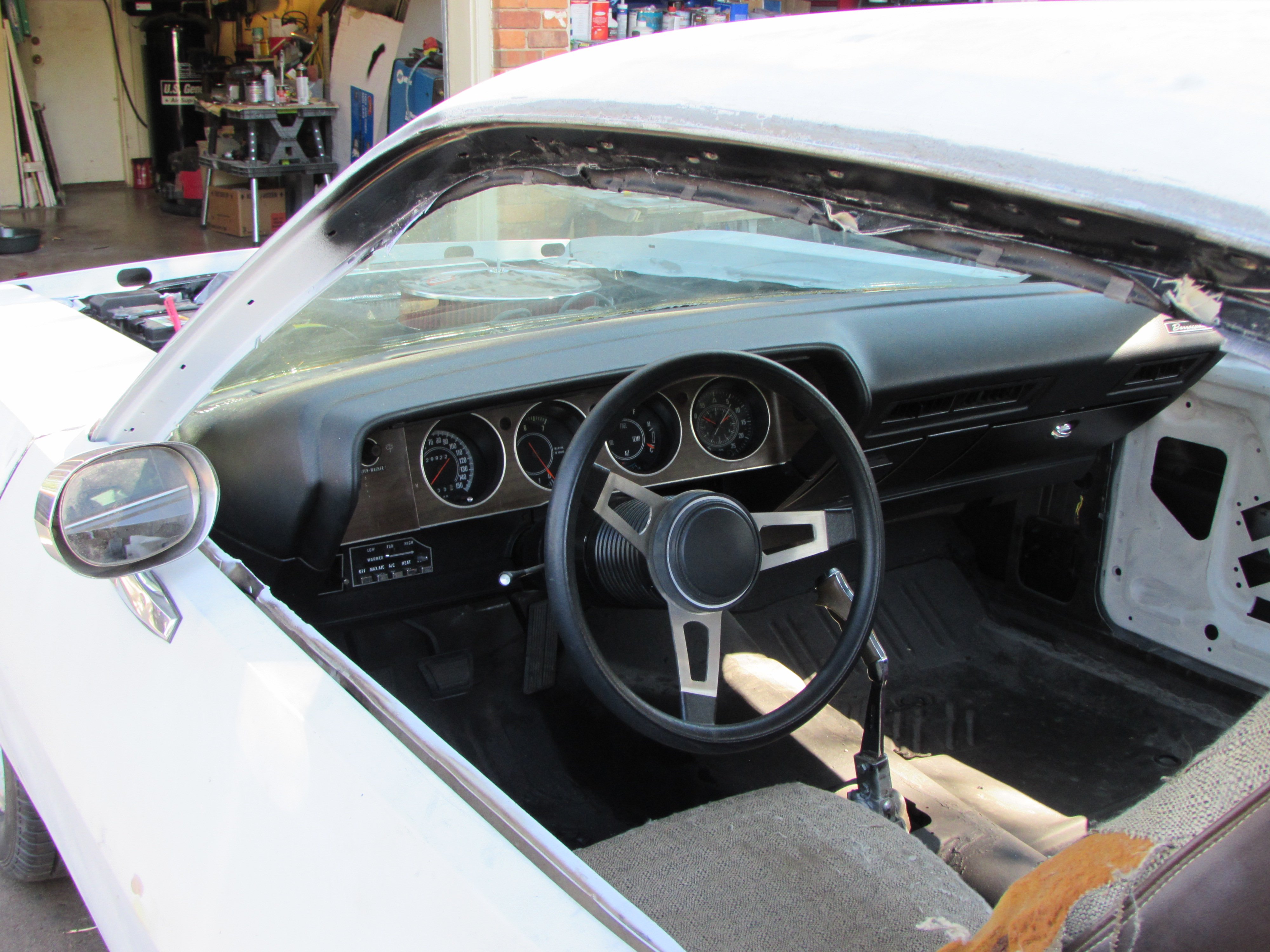

I put a grant wood wheel in my challenger, it fit well. I used a horn it came with.
