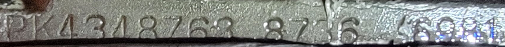

I've found plenty of references that list 727 part numbers but for some reason the part number i have is never listed. Can anyone ID this part number. If i believe the date code indicates Friday, June 28, 1985 and the PK means the kokomo plant. thanks!
PK4348763 8736

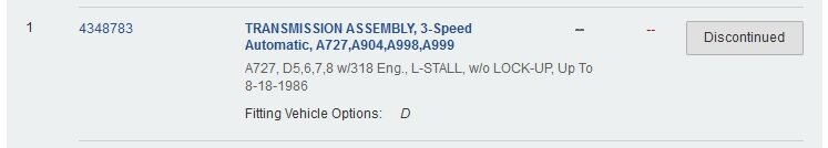

Howdy. By chance is your "6" actually an "8"? 4348763 comes back as a valve body assembly, not a complete trans. 4348783 comes back as a small block 727, Low stall, non-lock up for a 318 in a pickup truck - probably '86.
This is the closest I found - FWIW.

pretty sure the 6 is correct... possible after looking more the last digit is an 8, not a 3... so 4348768, which i've found some reference to as a non-lock from a 318? So probably what MarkLevi says... though if i read and decode the date stamp correctly it would be from june 28, 1985 so not sure if that was early model 86 or late 85. here's the pic of the number

1986 4348768, A-727, 318 truck, large HD ext hug, non LU, black insulator on valve body control lever, 2.9 KD lever, green spring governor, 3 and 3 gear planetary, std input and output shaft, 3 disc front clutch retainer, 11 return springs, governor has narrow spool, heavy H.T. weight, green spring, valve body has #79 steel plate , 528 transfer plate. At least this is what it came with back in 86.
awesome info... thank you @VOETOM ! helps when you can figure out the number correctly
That's certainly a tough one to read - have to agree last digit is 8. Look at the curvature and width compared to the 3s in the pic - becomes somewhat apparent, then. 3s would have been better with the flat top just for this reason....but they didn't do that so... oh well
