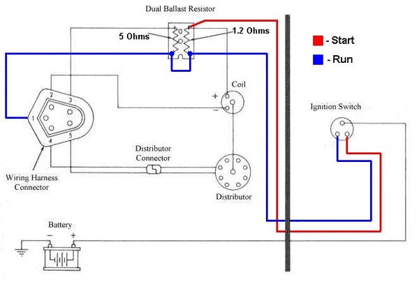

Here's a few ways to look at it.

In short. The use of a test light will narrow it down where the trouble is or not. A volt meter will confirm if it is a problem.
