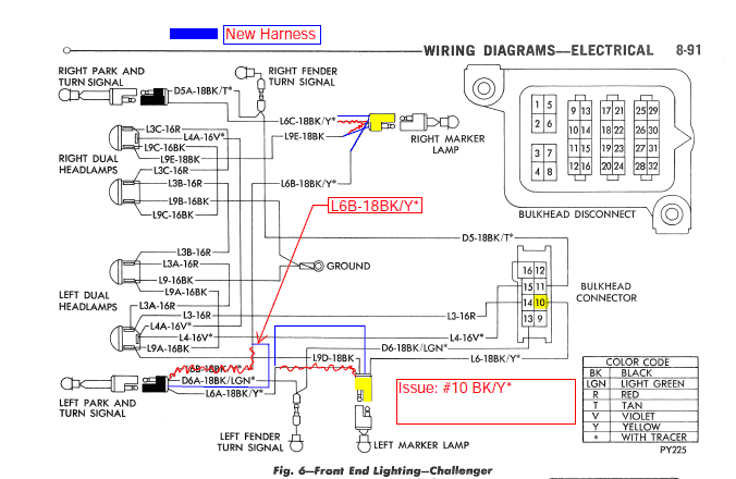

OK, Guys
I have an update. I checked to ensure everything was grounded. I am pretty positive I grounded everything. In looking at the schematic of the front lighting harness, I wasn't sure if the ground location at the radiator support was for the entire front lighting section or just the headlights.
1. For this reason I made sure the front valance was grounded. I didn't run any extra wires, I just made sure the valance had a good metal-to-metal contact with the lower fender.
2. I unplugged the side markers and the parking lamps from the harness. The headlights (Hi & Lo), Tail lights, license plate light, brake lights, rear blinkers and fender turn signal lights all operated perfectly.
3. I then plugged in the parking/running lights. Same result as (2.). The only difference is that the 'running or stay-on function did not work, but the blinker function did work.
**FOR THE NEXT TWO STEPS, THE PARKING LIGHTS REMAIN CONNECTED**
4. I then plugged in the passenger side marker only, moved light switch to the first position and it blew the fuse. I unplugged the passenger side marker light and replaced the fuse.
5. I then plugged in the driver side marker only, moved the light switch to the first position and it blew the fuse. I unplugged the driver side marker light and replaced the fuse.
Conclusion of this test:
Looking at the wiring diagram with my 'untrained eye', given the fact that all the other front lighting operate properly with the exception of the running function of the side markers and the front parking lamps, the common wire to these four locations is the (L6-18BK/Y*), which is position 10 in the bulkhead connector (Refer to attachment).
Next Steps:
I guess I will unplug the connector at the bulkhead, inspect at the firewall in the engine compartment and under the dash to see if anything does not look right. Then, with the connector still unpluged, I will turn the ignition switch to the on position and see how much current is present at #10 position at the bulkhead connector. Based on the results, I will determine the next step.
Any other suggestion will be greatly appreciated

It does sound like your #10 (Black with yellow tracer) is going directly to ground. Perhaps remove the parking lamp bulbs (1157, if I remember correctly), and side marker bulbs, and then check the BLK / YELLOW wire to see if it is grounded somewhere (unplugged from the firewall). With the bulbs removed it SHOULD be an open circuit.
The next step would be to do the same with all rear bulbs. With rear bulbs removed check terminal #10 to see if you get ANY ground signal (light switch on). With bulbs removed, AND the dash light dimmer unplugged, you SHOULD have an open circuit.
One other thing to look at...... The dash light dimmer switch. Same circuit. If the rheostat has come loose (common) it could ground out against the case, causing the fuse to pop.
Happy hunting

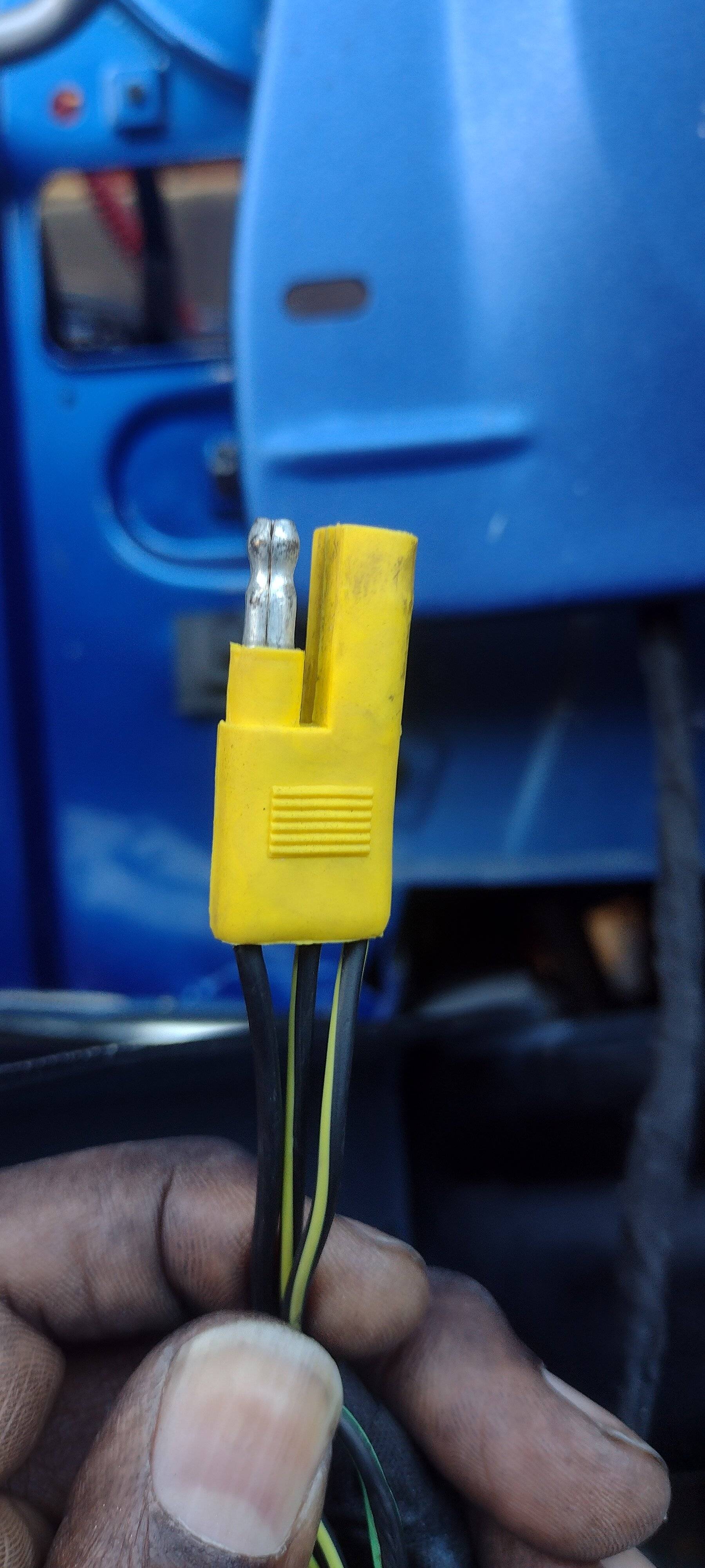

Hey Guys,
Still testing, but wanted to ask a question. How accurate is the above wiring diagram for the harness? Looking at both my new and old harnesses, it appears that at the left side marker connector (Yellow), there are two BK/Y* wires coming from the female socket and one BK wire coming from the male plug. However, when I look at the wiring diagram, it seems to indicate one BK/Y* wire coming from the female socket, and a Bk/Y* along with a Bk wire coming from the male plug. Please refer to the photos.
I am not sure which is correct and was curious to know if either of you have heard of any such thing.
Thanks much

Before I go any further with troubleshooting, I wanted to show you all how my new harness is configured when compared to the wiring diagram. It is slightly different from the Wiring Diagram. Would like to hear your opinion; Please refer to the insert. Do you think the harness is built correctly and the wiring diagram is not totally accurate in terms of the wire runs, or is the harness built incorrectly?
Thanks
The blue shows the wire runs of my new harness. The red 'scribble' is the original wire runs in the wiring diagram.
