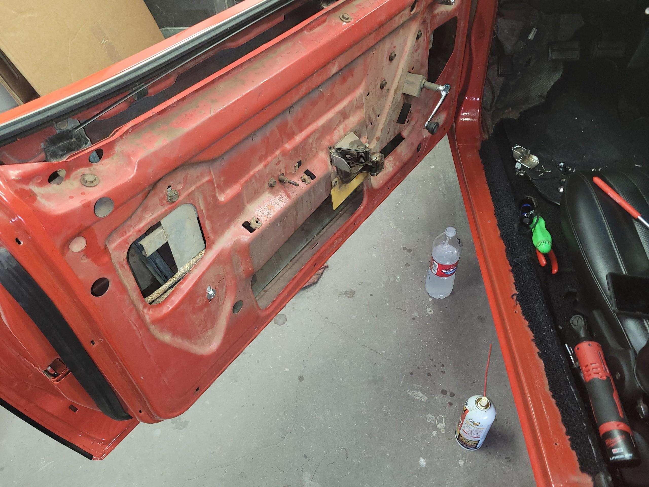

Hi all, It has been a while since I have asked a question. I am haveing trouble getting the drivers side inner felt to stay attached. It comes loose when I roll the drivers window up. Does anyone have any ideas on how to make it stay put. It is a new piece.
Thanks in Advance.
Attached are a couple of pictures. We have the door torn apart trying to figure this out.

Are you talking about the felt we see in your door picture that rides on the outside of the window or the felt that is attached to the door panel and rides on the inside of the window.

Inside felt. That is an older picture of the drivers door to help with my question. The outer felt is fine. Can't get the inner felt to stay attached at either end of the door.

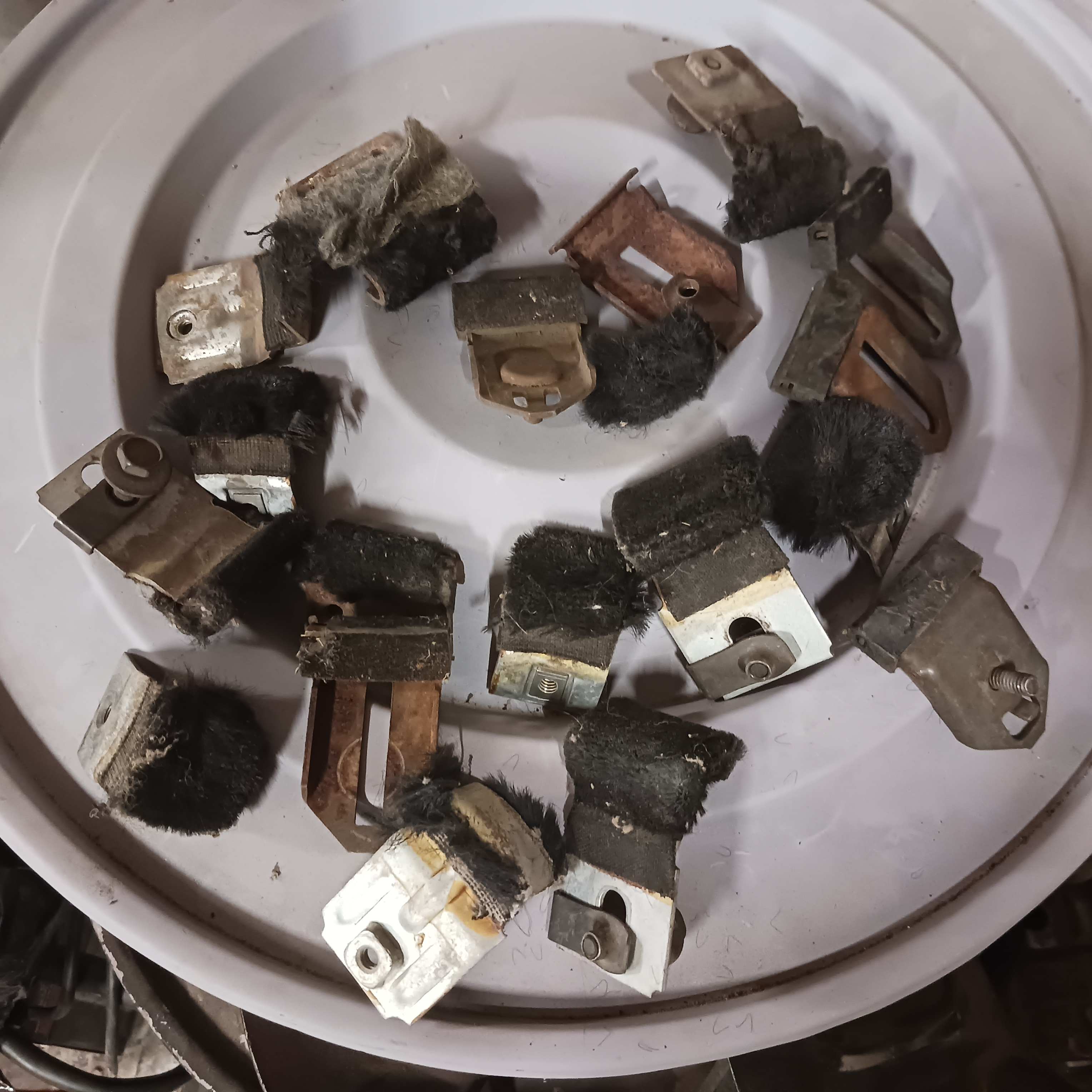

I understand what you have going now. I agree with Moparlee on the 3M Black Super Weatherstrip and Gasket Adhesive. Strong stuff. I've collected several of these brackets thru the years (see photo). Some use a felt, some use a long Mohair type material and some use a rubber. The 72 Challenger I'm working on uses the long mohair material. Report back on what you find works best. I remember seeing where someone had the replacement material but couldn't locate it just now. Good luck. The ones with rubber in the photo were up-stops if I remember correctly.
