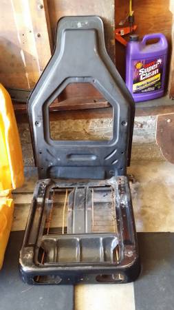

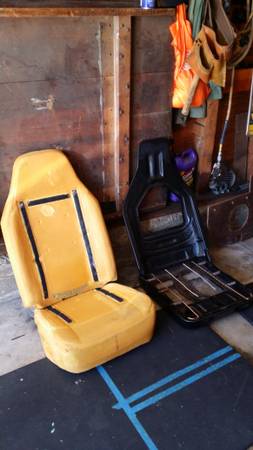

Hi,
Im trying to find some correct bucket seats and or frames for my 73 Challenger.
I found some for sale , but the guy does not know what dodge/plymouth car they are from.
Some part numbers from the seat frame are
Top line- 100791 z
Bottom line- DLD (upside down triangle symbol) FZTB9863100ABR
Is there a book to look in somewhere ?
Online?
You are looking at upholstry tags. Post a pic of the seats and we will tell you what they fit.
Here are 2 pictures
Those don't look like anything I've ever seen before. I'm very familiar with '70 & '71 seats and I can't imagine the change, if any, would be that drastic in the later years. Those don't look to be Mopar. My .02.
Doesn't matter. Those are not the correct seats for any Mopar. Keep looking. The 73 seat is like a 72 seat except for the rear of the seat. The 70-72 have a hard plastic cover on the seat back and the 73 is vinyl upholstery front and back.
Thanks
The person that is selling them is offering them as e body maybe b body seats. He is not sure what they are from.
They were in his car when he bought it.
Good. I have seen a GM seat that looks close to them. No way to know what they came from.
