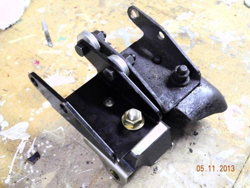

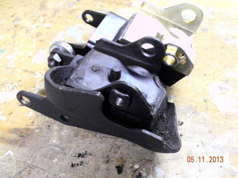

Guys, bought these poly motor mounts from Schumacher and they do not seem to line up properly with the old ones. The old ones look like the original factory mounts since they have the heat shield welded on. See the photos, bolted them together to show they do not align. Any help would be appreciated. Ralph

That is way off , I would contact Schumaker , send pix & see if they sent the wrong kit

I checked with Schumacher and they are correct, they told me what to do to install them. The old mounts collasped about an 1". I also ordered a standard rubber mount set and they were excatly like the poly mounts.
I got them in the hard way, but there in and looks correct and great product.
