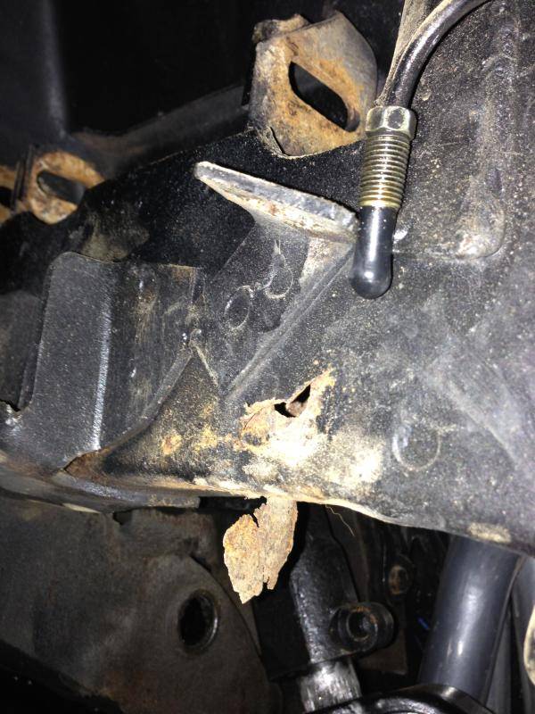

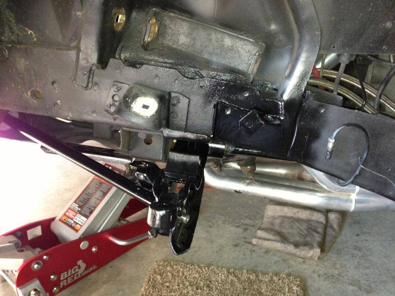

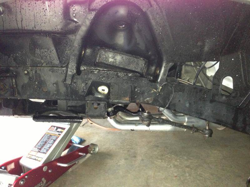

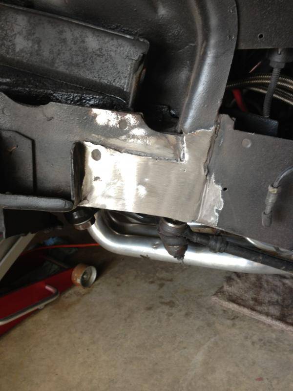

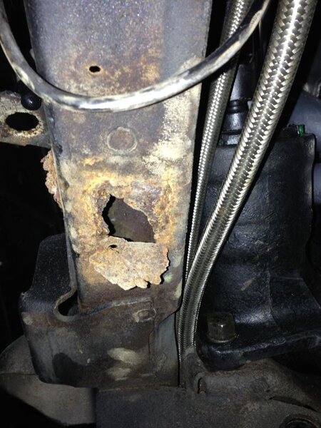

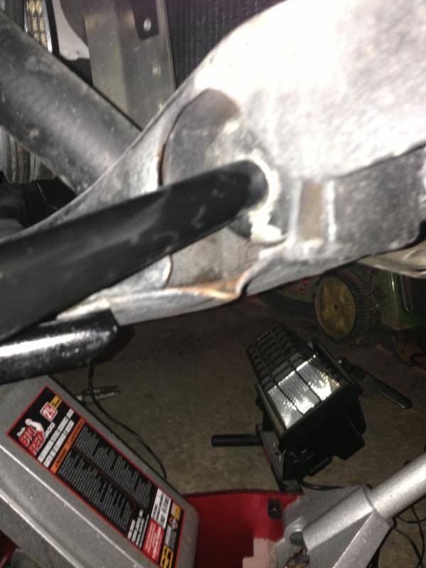

I didn't notice this nice divot in the K member on tear down below the strut rod but this explains why the rod was bent. Also hoping I didn't get into to much of a hurry with assembly as i still need to slide the torsion bar in. Wondering with the upper control attached if there will be enough droop to allow the bar to be inserted into the lower arm. Crossing my fingers. Awaiting the dust boots.
