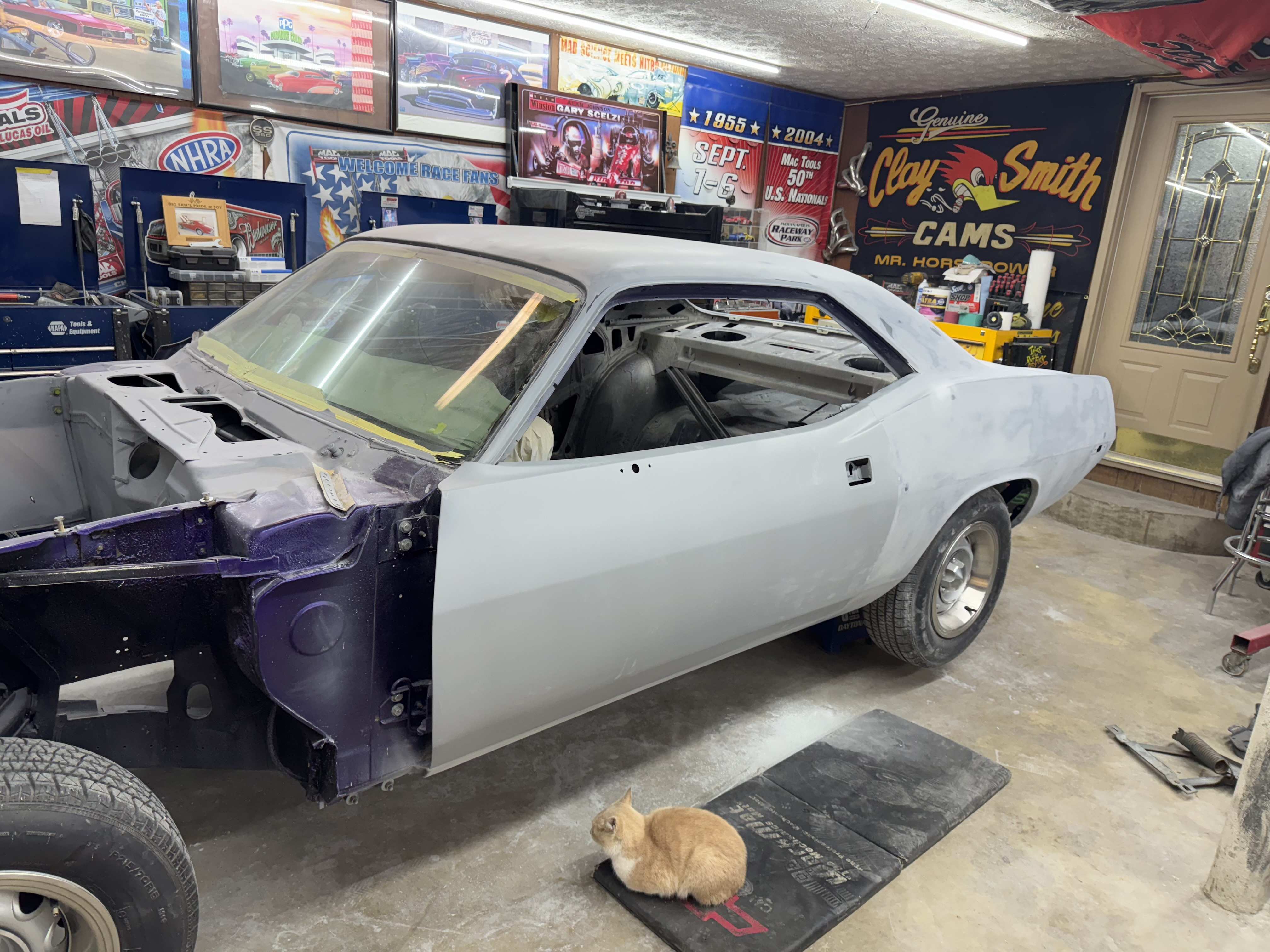

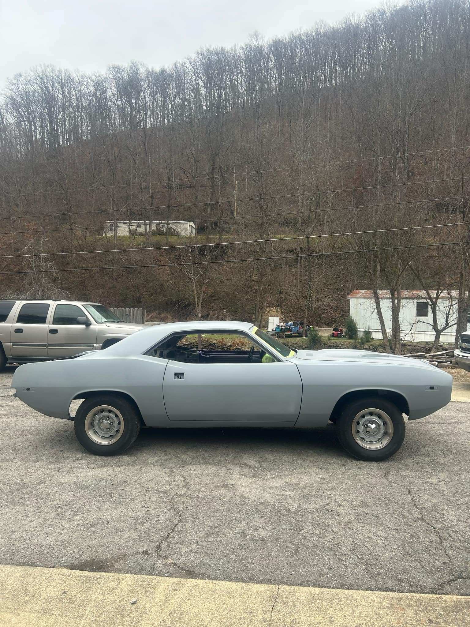

I’m needing help with the 14 circuit kwik wire installation. Does anyone have the schematic for the 73 Cuda? The orange number 33 wire is giving me trouble. It blows the 50 amp when I connect it to the acc on the column. I need all the info I can get on using this harness. Thanks. Here’s the car, I bought it in December and I’m moving quickly.

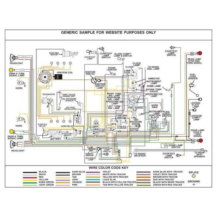

Found an in general diagram. Is this anything like it? Looks like the orange wire is for the light sw to the headlight dimmer sw?

I got it figured out, the alternator exciter with hooked up was grounded.
