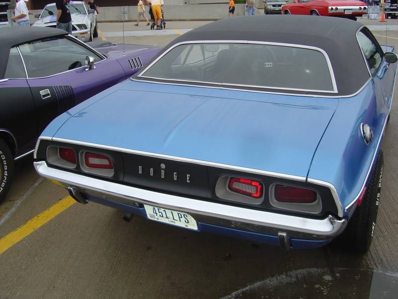

Original unrestored tail panel on a 72 Rallye.(JS VIN) Only the Rallye in 72 got this paint treatment.

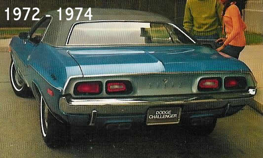

This is how the standard Challenger in 72 was painted...as well as ALL 73-74's.(argent tail panel with organisol around tail lights)

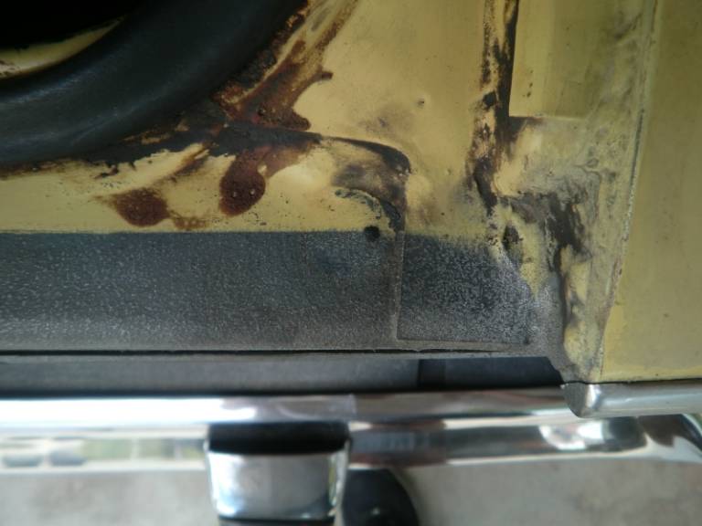

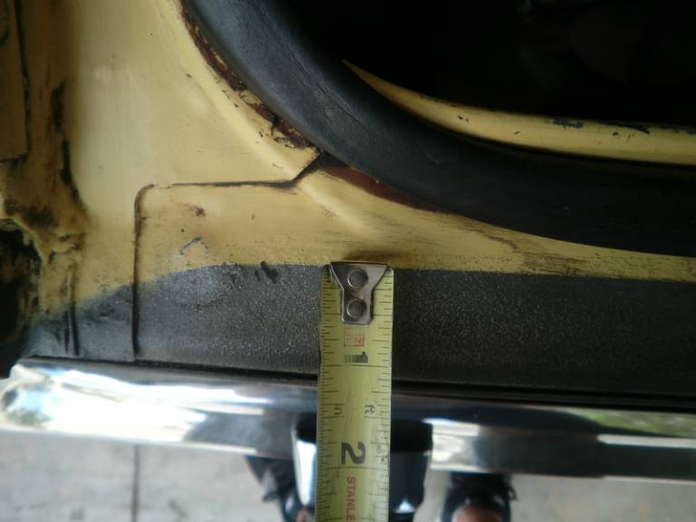

Also the argent tape line is up under the trunk lip. It was masked off about an inch after wrapping around the corner towards the weatherstripping. THis was so you wouldn't see the mask line under the trunk lid from behind.

You can kind of see it at the top of this pic. The argent goes back toward the trunk opening about an inch.

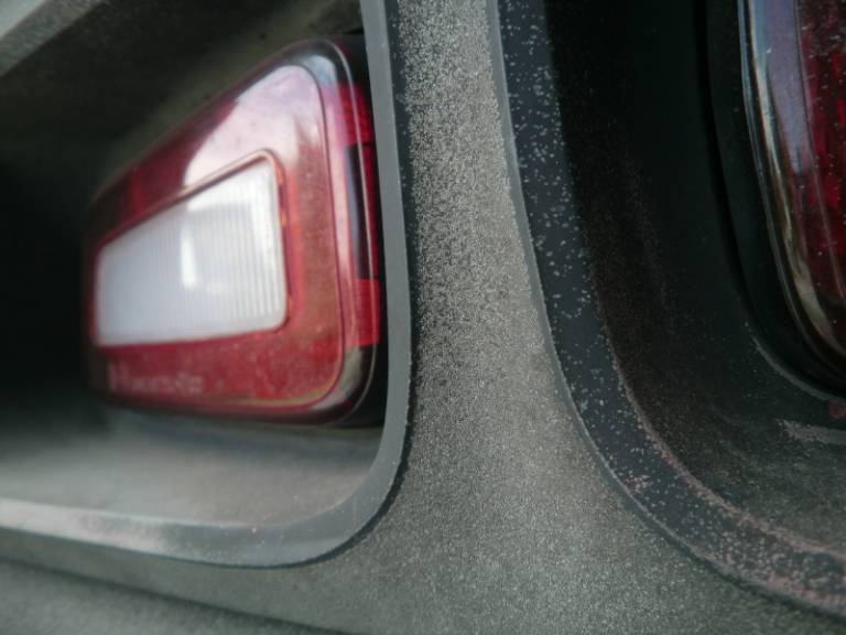

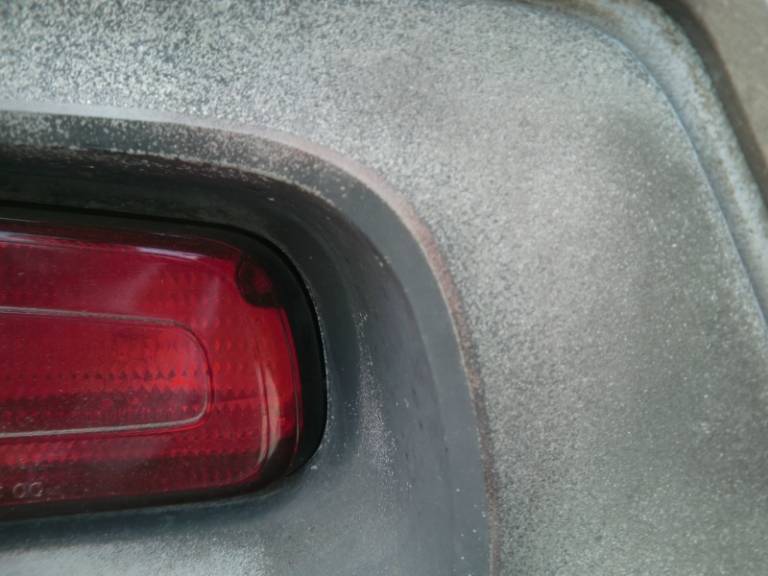

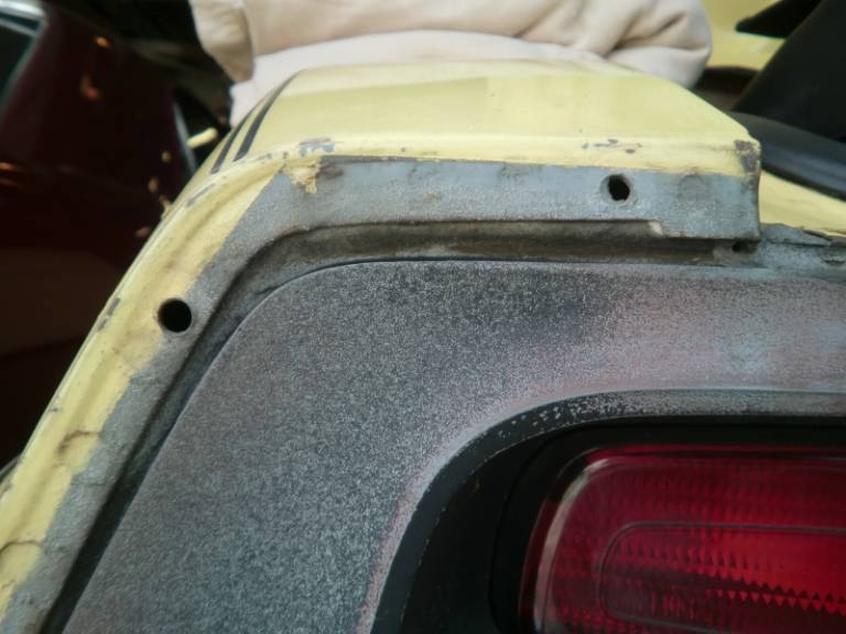

Here are some pictures of the rear portion of my car that is still original paint. Not great paint, but original.
Drivers side
Passenger side
The light pockets are flat black with the silver surrounding the rest.
the 3 filler pieces all are painted the same as the main panel. the textured silver.

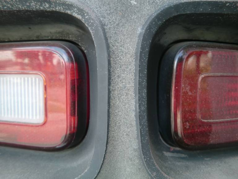

Close ups around the tail lights. I suspect that during original painting they placed a formed cup into the light openings. As you can see the silver areas actually overlap the outermost seam line around the lights and is not real consistent around the perimeter.
Some of the pictures show the flat black still remaining and some are showing the reddish primer color. but you can clearly see where the silver ends.

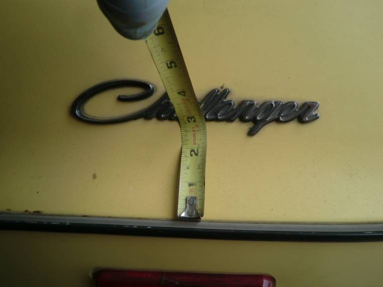

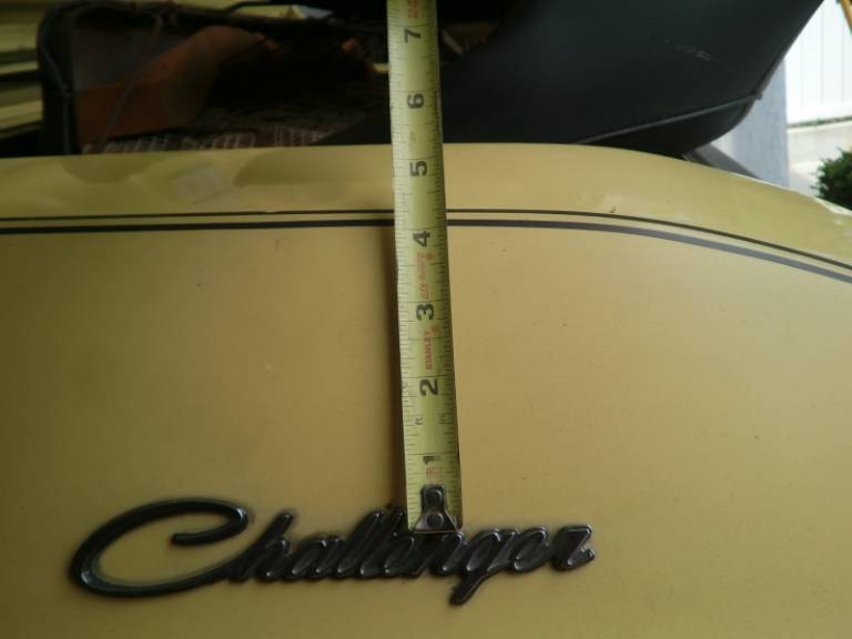

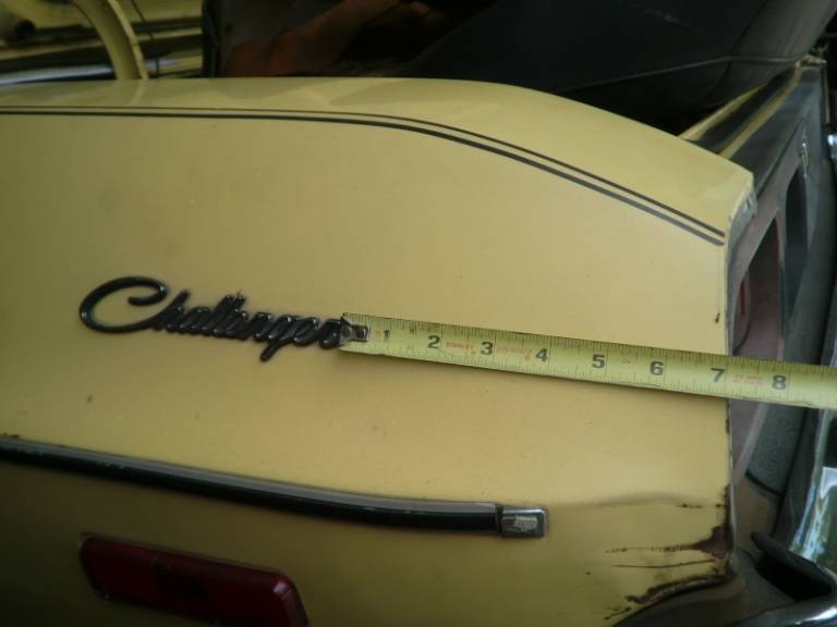

Emblem placements

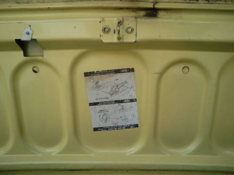

Jack instructions. Assumption is that it was placed on the lid with it off of the car because it is upside down when installed.
Fender/quarter cut lines
As for the above mentioned note that the 4 light recesses were textured. Mine are not. They are painted only a flat black. After reading this I even went out and looked closely to be sure and I cannot see any evidence of texturing. I am not the original owner so I cannot 100% be certain but...
I have owned it since 1983.
Mike.

This is great info. Just what I'm looking for. By the way, did the factory also not take much time for placing the rear quarter panel emblems or those were pretty precise to these measurements? Thanks.
moparleo
Oct 17, 2011
7,231
2,014
Not unless there were mounting holes to put them in, you can find the "specs" for the placement. But that was just a guide. Sorry to say but our cars didn't have the best in quality control back then. That is why pictures and documentation are so important for that 100 point "correct " resto. No 2 cars are the exactly the same.

The black was organisol. The amount of texture that is correct has been debated as well. Depending on how it was sprayed, there might not have been much. Organisol doesn't have near the texture that argent does.
Thanks for those pics. The area up into the trunk is very dark. It looks like the tail panels lightened up over the years from being exposed to the elements. Mine needs to be redone I think.
