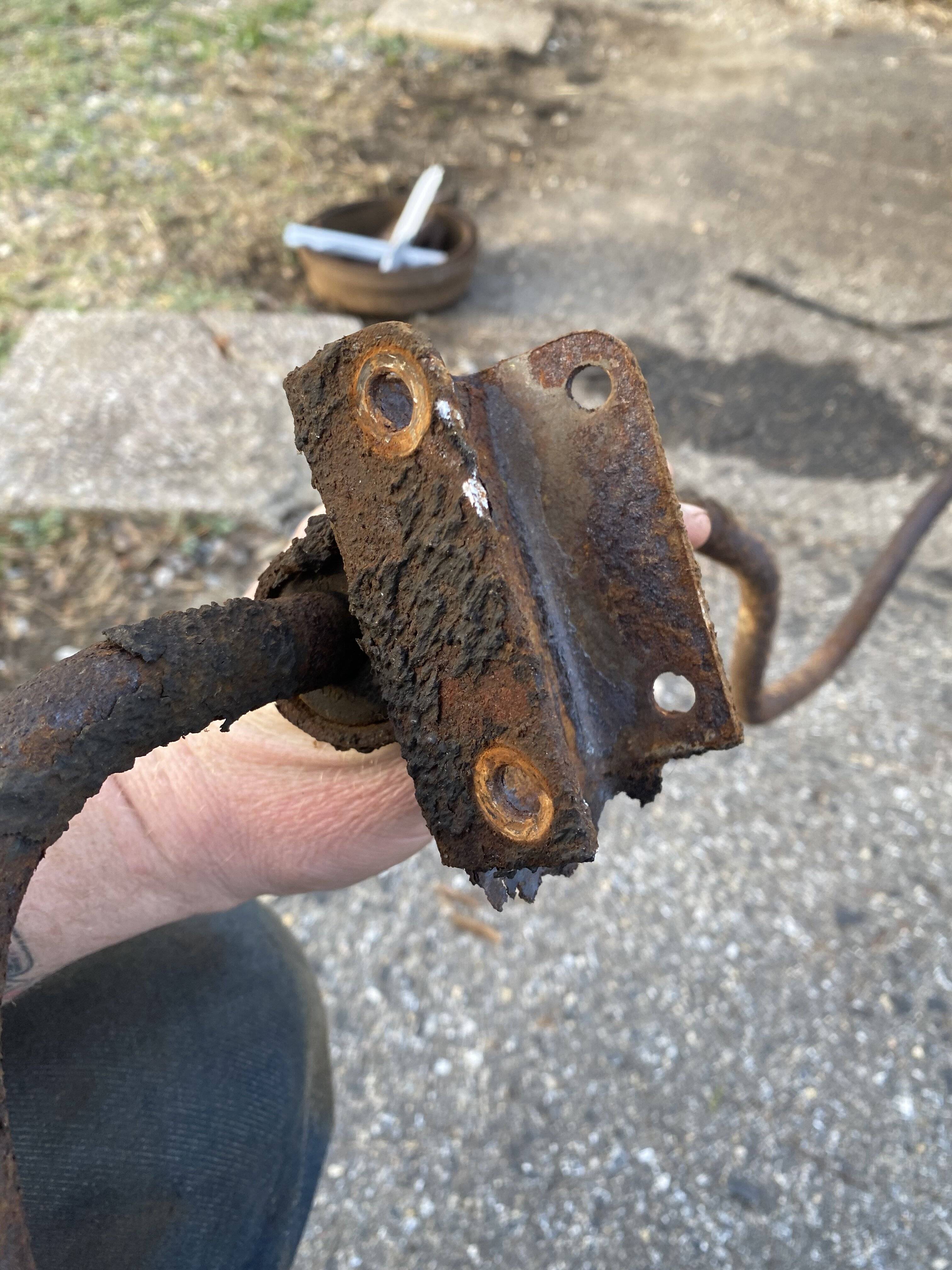

Does no one make a exact replacement ? I’ve gotten two kits that said they’d work and they don’t . Well not without mods I don’t want to do . Mine was rotted and needed to be cut out . I can’t find new sway bars that Mount this way or even close to it

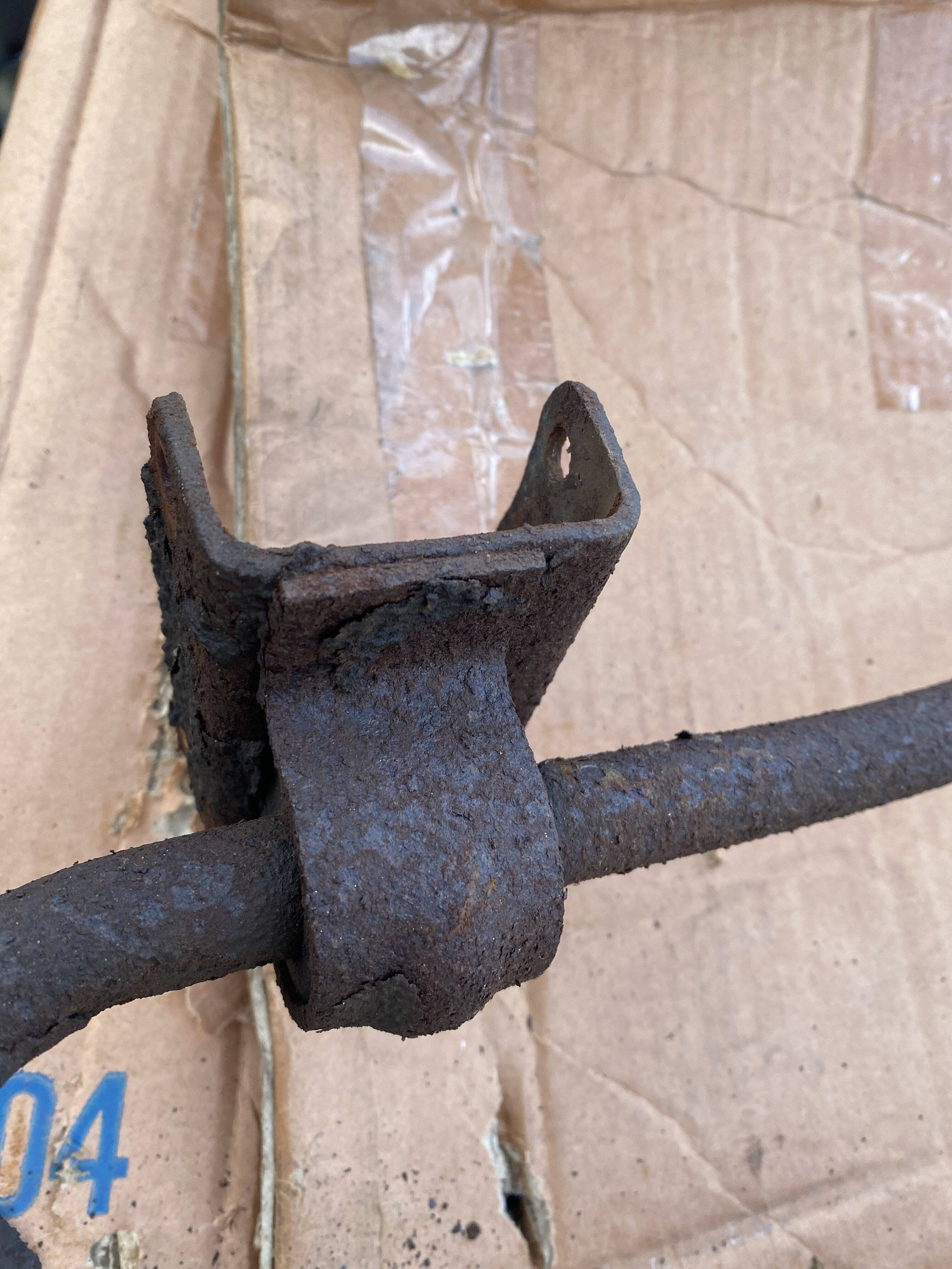

they were not meant to be replaced I cut out the spot welds with a spot weld cutter to remove the bushing then welded the holes up ground them clean then spot welded new prothane bushings in 2 spot welds on each end can;t remember what bushings i matched them up to

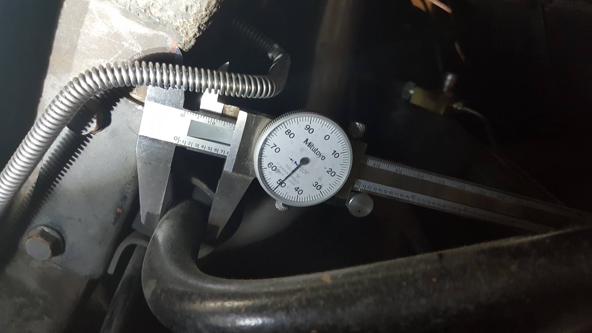

The Firm Feel bar appears to be the closest to stock and is even the same diameter as the OEM bar. See photo. I got mine off a wrecked 74 Cuda in a junk yard in Longmont, Colorado, in the late 1970's or early 1980's. I paid $40 for it, bead blasted it at the machine shop where I worked, and primed and painted it with a rattle can. My Cuda did not come with a rear bar, perhaps because it was a little earlier in production, in October of 69. The OEM and FF designs are preferable over designs which attach the bar to the axle for aesthetics and minimizing unsprung weight. You may find your best deal on a car being parted out, even if the bar requires blasting and painting.

Yes to save some cash I did the same as cuda joe years before Firm Feel E-body rear bars were available. My sway bar itself was in ok condition. Back then I was able to reuse frame brackets, after disassembly wire wheeling and blasted at work, adding new bushings. Also I needed to clean up/ remove rust from my rear sway bar end link lower leaf spring mount brackets. As for parts, they were inexpensive, as I was able to match up /purchased new end links & bushings etc, from local Auto Zone parts store, very low cost. Years later when they became available, I purchased Firm Feel, only because mine were pitted.
If you are able to clean up/ reuse your upper frame and lower mounting brackets and you only need the bar itself, I have the rear sway bar hanging in my garage you can have for cheep, typical pitting but serviceable,( just the bar, don't have frame brackets ) . good luck SCHU.
