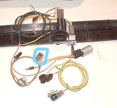

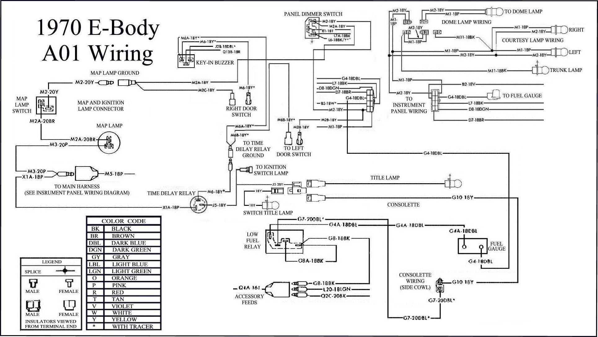

I've been hoping to get the ignition and switch pnl lights to work off the timer relay. I replaced the one
that was missing and have power to the lights but it won't time out unless I unplug the 'left switch'
connector. At the same time that provides the power to energize it whether the door is open or not.
I'm wonder if it's being back fed from the key buzzer since there's 2 wires at that connection but I don't
think it's even there. At least it's not working along with the fuel alarm.
Does anyone have any actual pics of how the timer is wired... Not sure what the grey plug is
in the middle of the pic but I don't seem to have that...?
