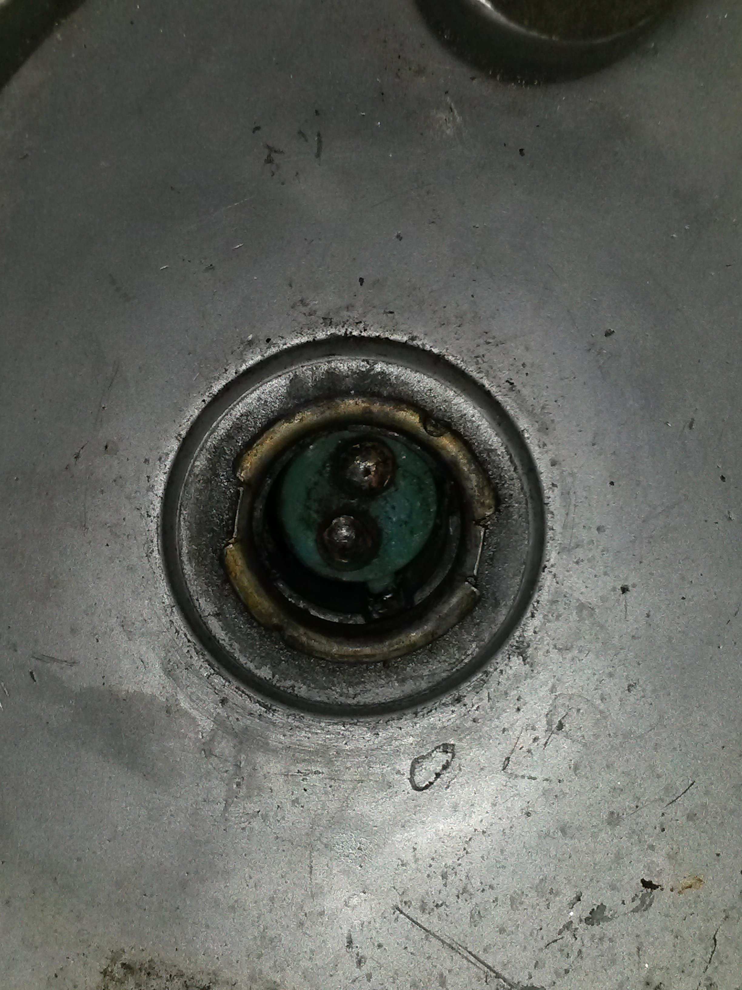

If you have a front park and turn signal light that glows dim.
The bulb is in backwards or not quite locked in. The socket is shorting out. Sometimes you really have look at it to see it.
That wasn't it. Tried it different ways and it only goes in that one way. It works fine for years. Now I'm gonna kill myself questioning it.I'm just thankful.It's fixed.
In a perfect world. Sockets not rusted or inner parts not bad. Check the socket connections inside and plastic insulator. Look and see! I fixed this one.
