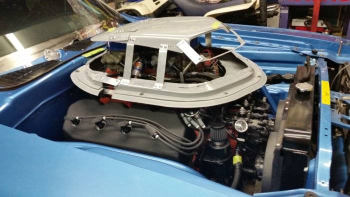

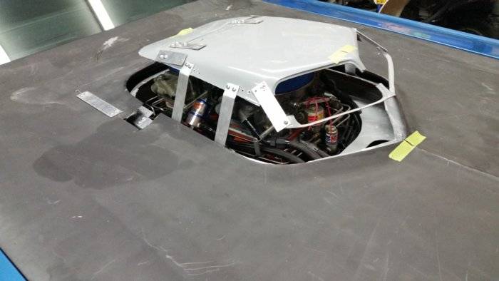

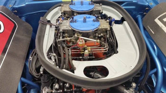

Figured I would add some pictures of mine. Not a stock resto since the original drive train was long gone.
6PKRTSE
Feb 3, 2010
1,066
654
Thanks. It was a lot of work to clear the tunnel ram. Stretched the hood opening and scoop length 3", raised the scoop 4-1/2" and opened up the nostrils 2-1/2" taller. The base Dzus slide lock fastens to the engine on tubular mounts I made. Then the scoop slide lock fastens to the base. All goes on and comes off in like 10 seconds and still functions like the stock shaker. Painting it all today as a matter of fact.
Can appreciate the "engineering" that went into the creation of the bubble

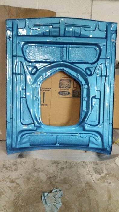

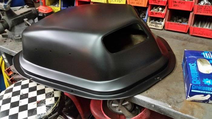

Thanks. We were able to get the bottom side of the hood, bubble and base painted today. Top side of the hood next weekend.
