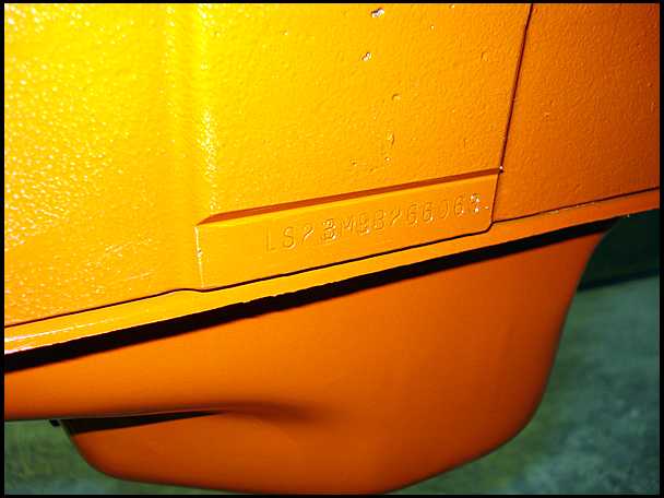

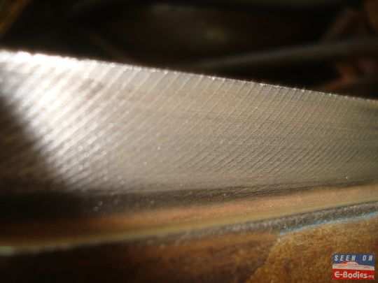

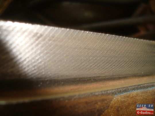

Not every block gets a VIN. I've heard this reported more than once. I can't say I've looked on every block I've come across, but when I looked, it's always been there.
The stamped number on the block can be hidden behind engine paint. You're looking for a flat machined area just above or touching the oil pan rail. On the passenger side. It's about 2-inches long and 1/2-inch high. The surface faces outward, perpendicular to the ground.
If you don't see a flat machined area, in the middle of the oil pan, on the passenger side, adjacent to and/or touching the oil pan, I don't think you want to bother removing any paint.
If your engine is missing it's VIN number, I may just call it original, but without documented proof. I'm not sure anyone will really care. This isn't one of those ultra rare Hemicudas. She sure is pretty, though.
Two images, one with VIN one without.
There is a partial VIN on the transmission, too.

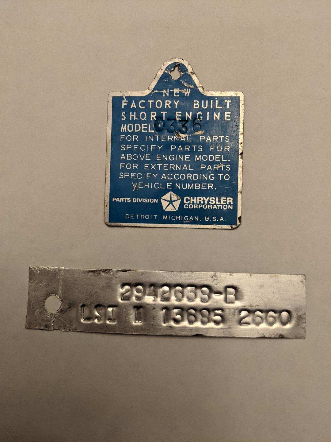

If it is a factory warranty block that machined pad above the oil pan will not have any stampings. But there will be a blue tag riveted to the side of the block.

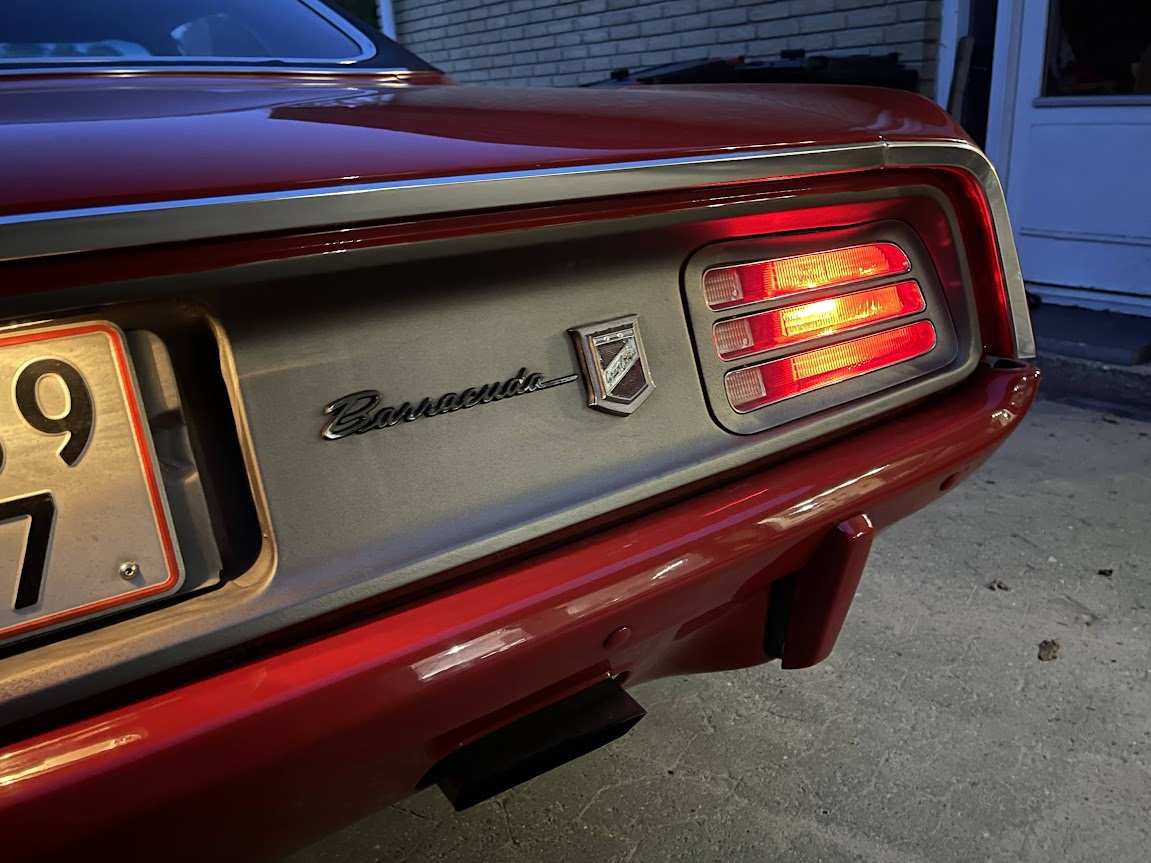

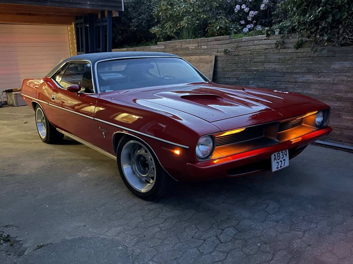

Thank you very much :), both for the educational pictures, and for the kind words abt my GP.. It is really pretty.. (especially that night)! I think it was showing it's gratitude by looking so good, as I adjusted the kick down lever earlier, that same day.. ha ha!

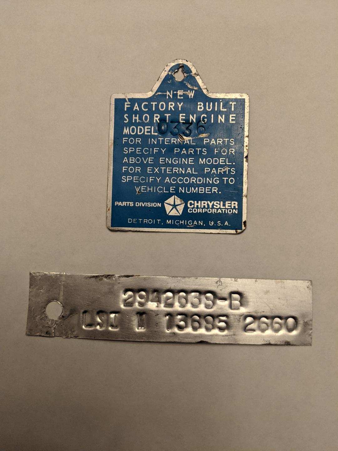

Thank you Lee.. Interesting with the blue tag.. Is anything stamped on those riveted tags? I don't recall seeing any, but might very well havd looked in the wrong spot on the block..! I work so much, that I forget a lot of things, but will get pictures when it stops raining every day, all day.. 🌨️ 🤨

Here are the two tags which were riveted to the side of my warranty block.

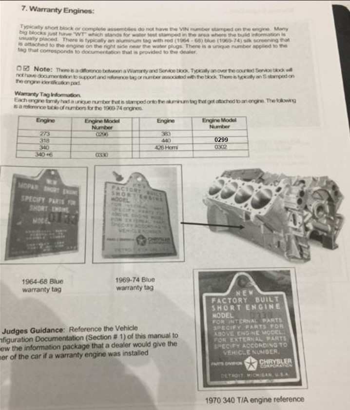

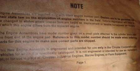

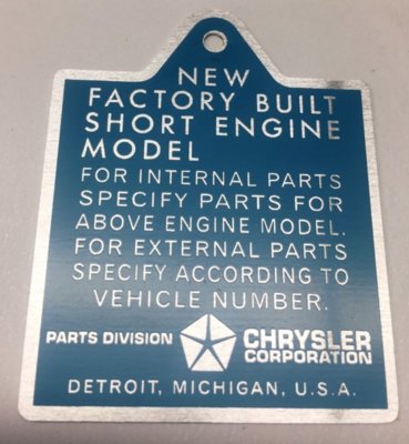

WARRANTY BLOCKS AND TAGS:
Pic 1: Engine Instruction Sheet with NOTE to dealership that warranty blocks are "supplied only with blank engine number pad" but the "Dealers are governed by their state law on the application of engine numbers in the field."
So warranty blocks will be found both with and without VINs stamped on their engine number pads.

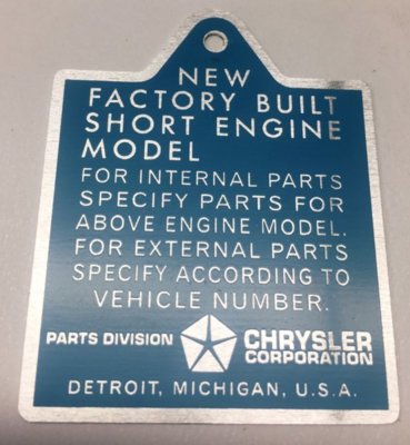

Pic 2: Example blank warranty tag in blue for 1969-1974 warranty blocks.

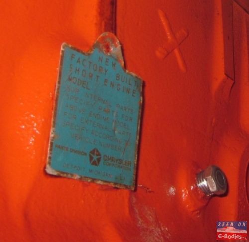

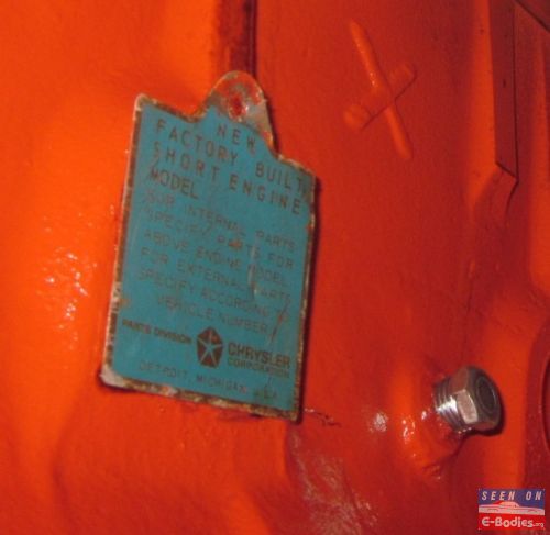

Pic 3: Location of a riveted warranty tag.

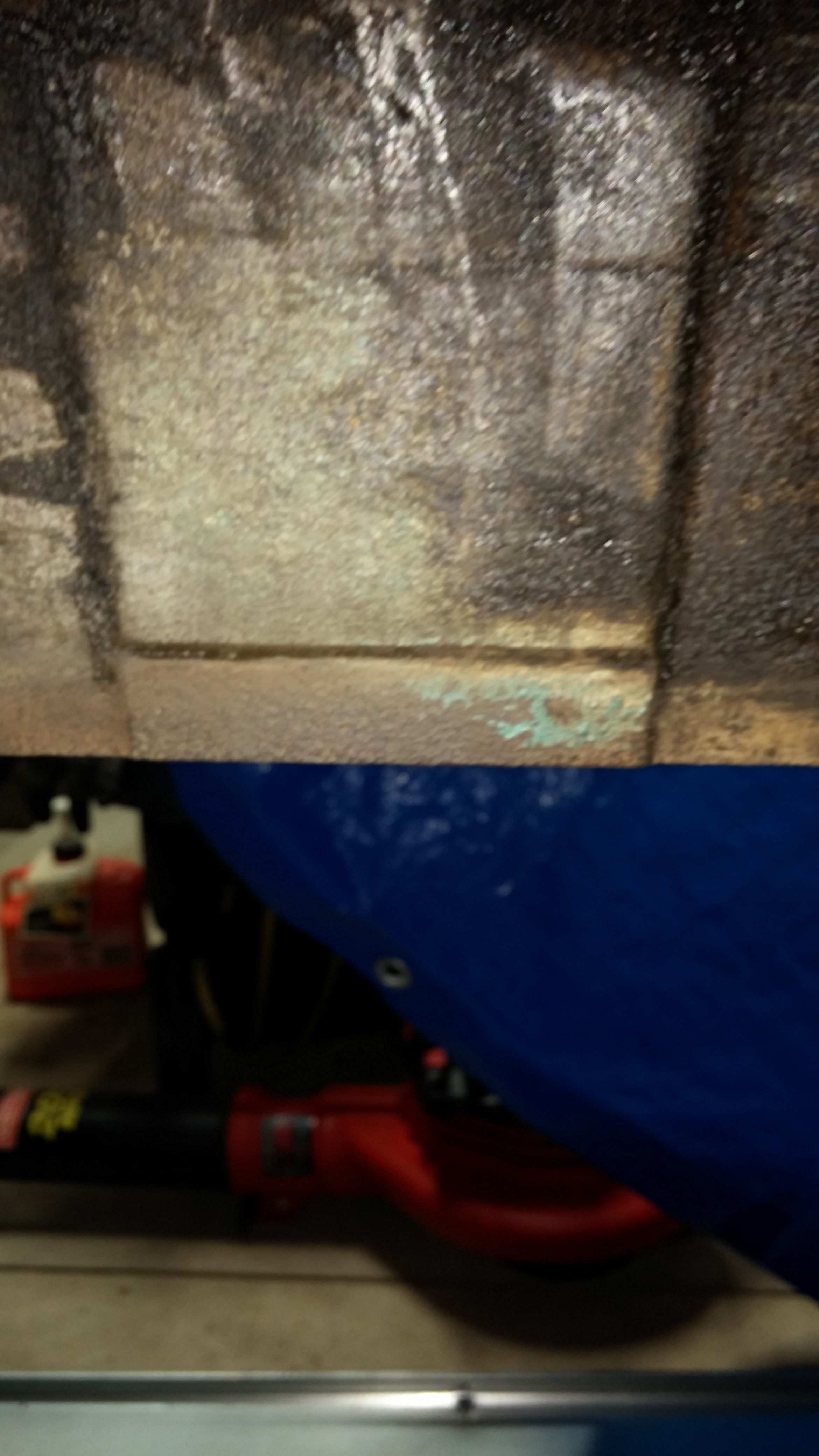

Pic 4: Actual warranty engine block showing a blank engine number pad.

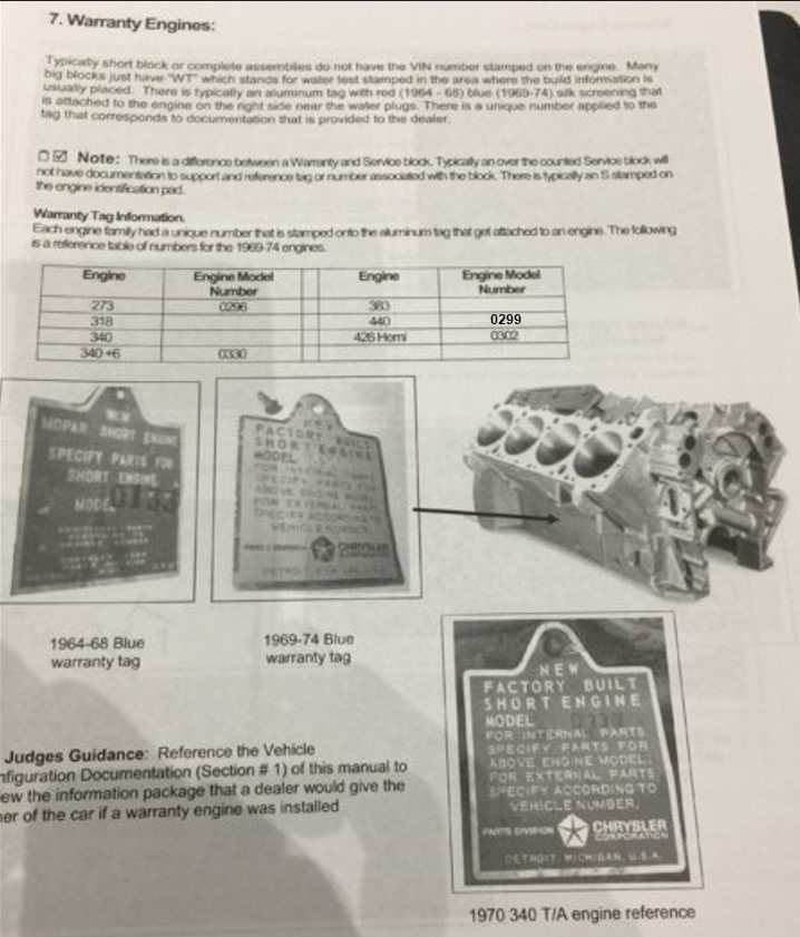

Pic 5: Details on Warranty Engines and Tags
