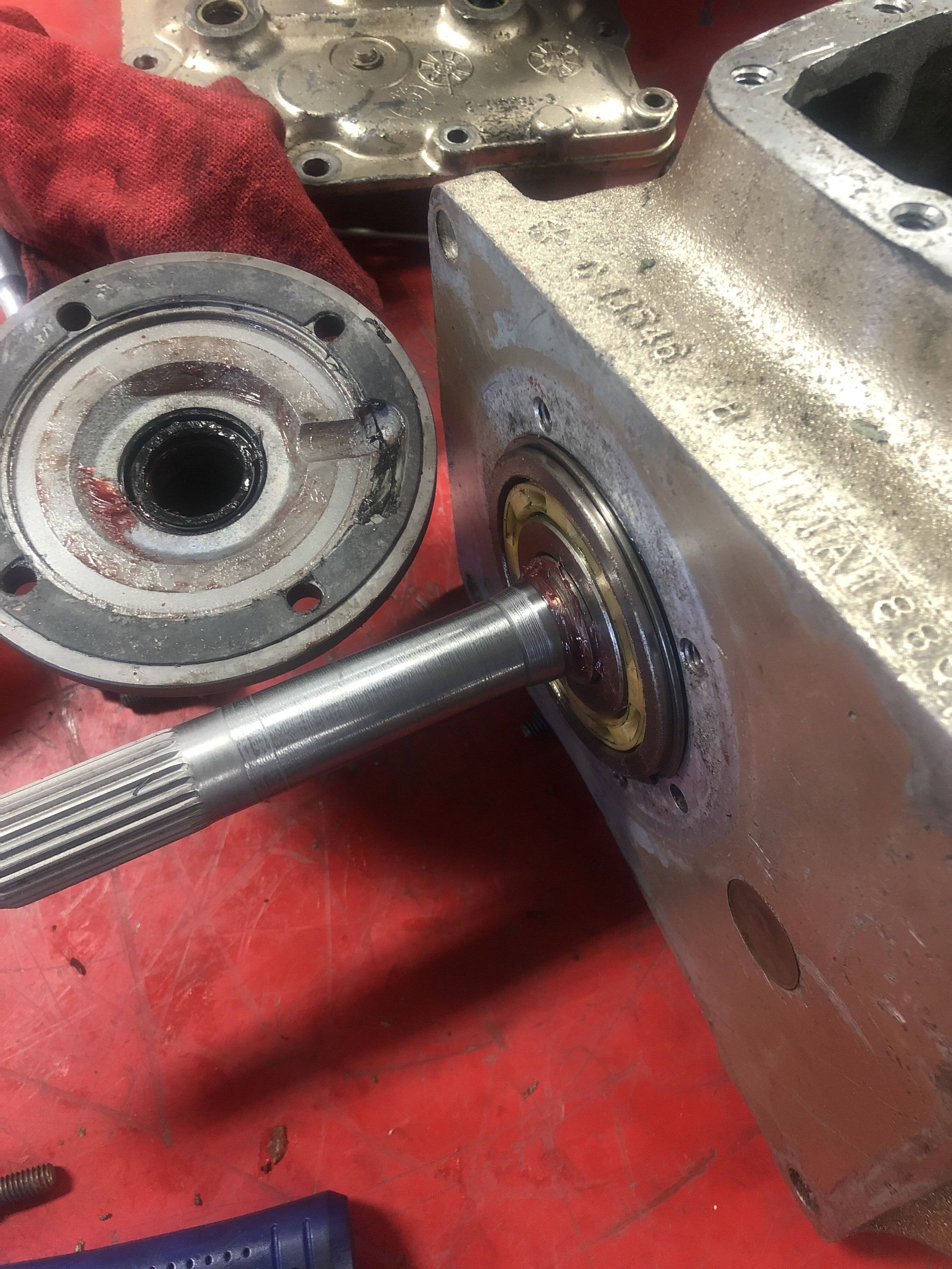

Hey I’m working on a 1986 a833, I just got this input shaft installed for me due to the previous shaft being bent. I’m installing the front retainer but when all four bolts are in all the way. The input shaft is very difficult to move or even lock up the more I tighten the front retainer. It’s not in gear, it’s in neutral, I even put some grease to see if that would help but it didn’t, Please help

Wrong bearing for shaft or wrong shaft ? mic both shafts? Use a depth gauge check depth of retainer and height of front of transmission. Clean grease of use bluing to see where it is contacting.

It could be a roller brg out of place inside the front input shaft or the syncro ring out of position between the the input shaft & main shaft , something is not right .

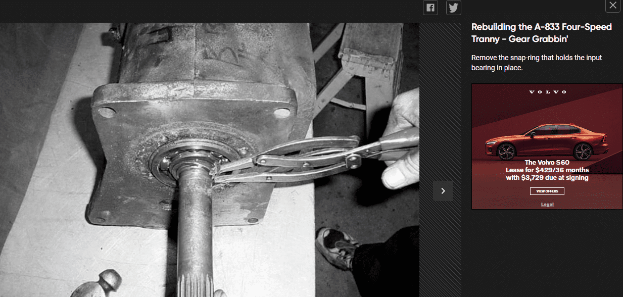

The large external snap ring should easily rest up against the case and the input shaft rotate easily. The bearing retainer should not be forcing the bearing in.
