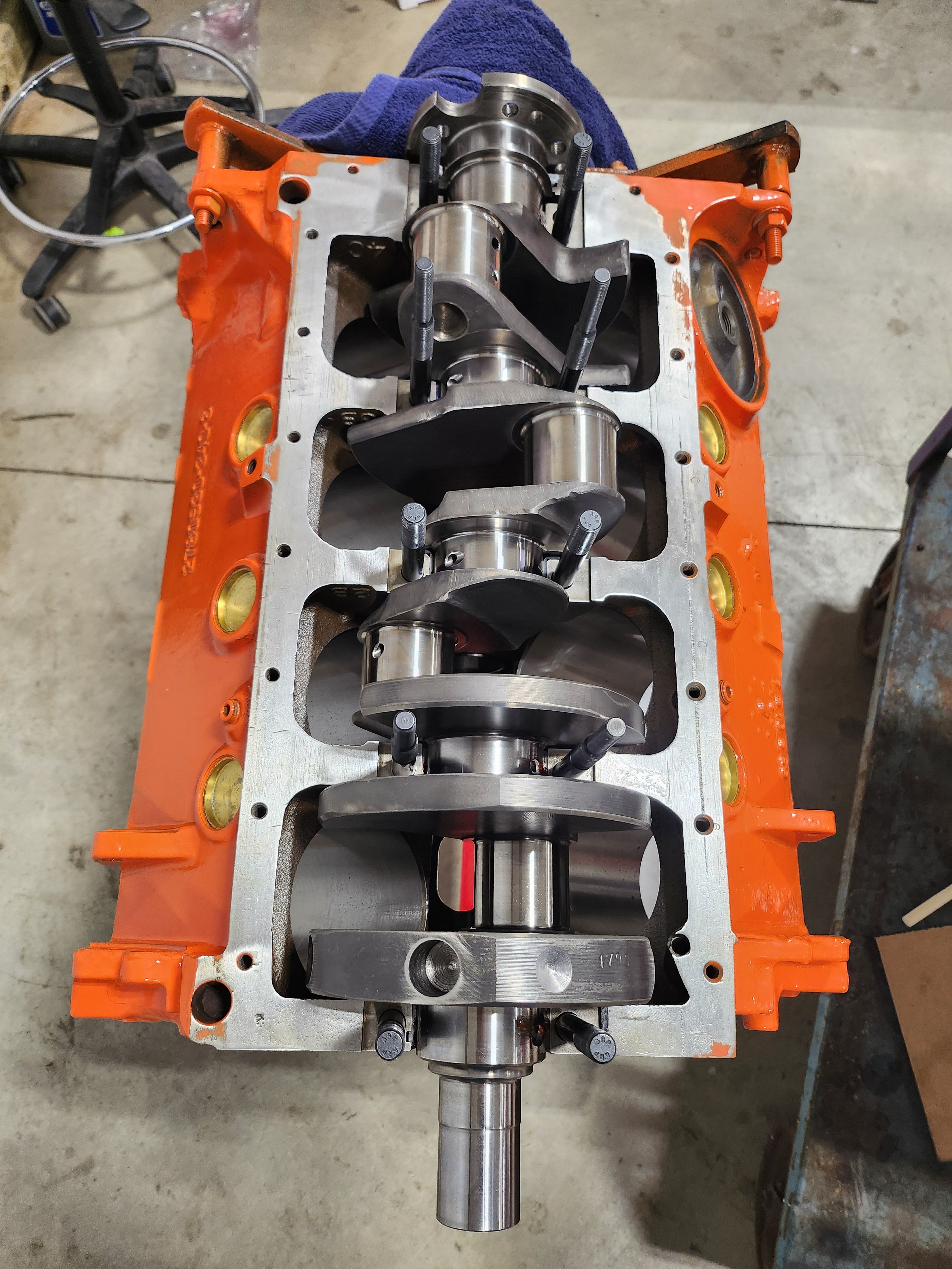

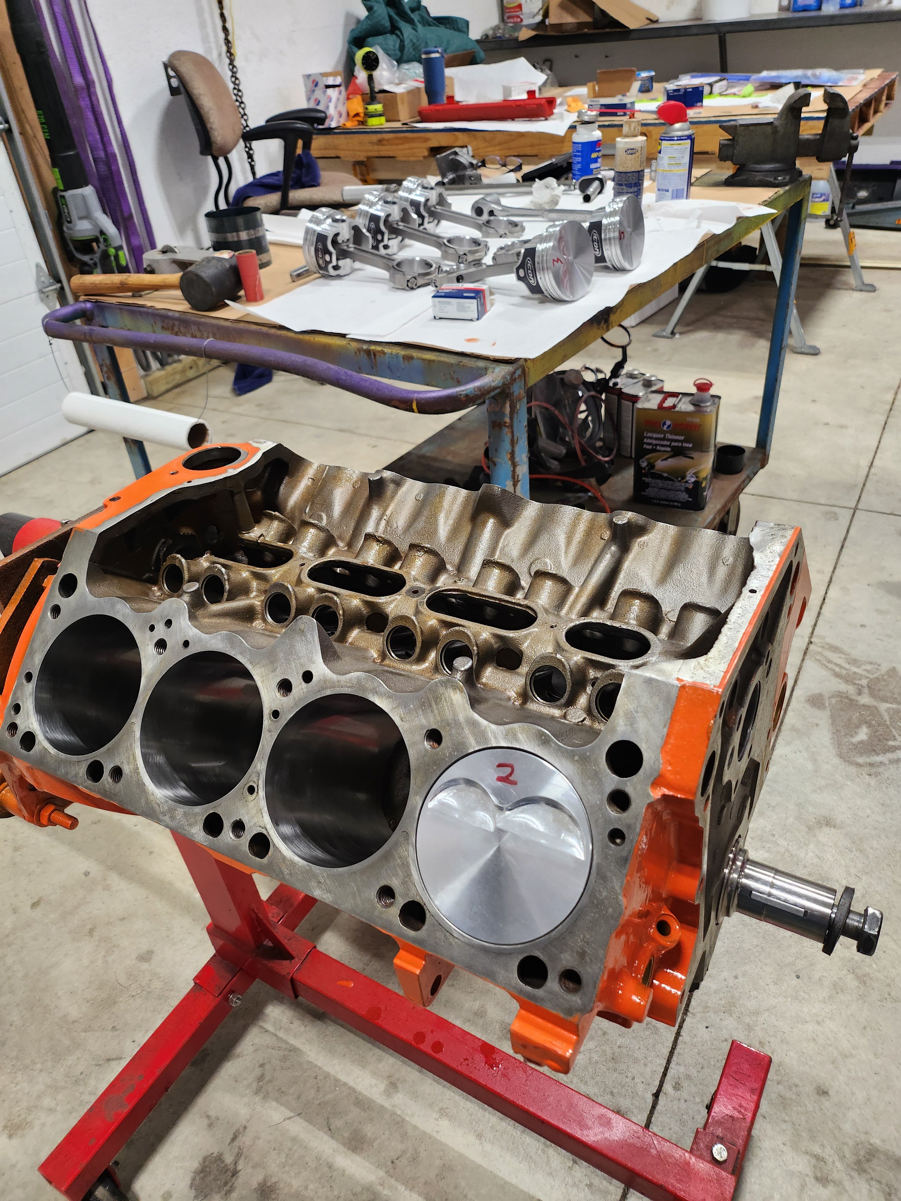

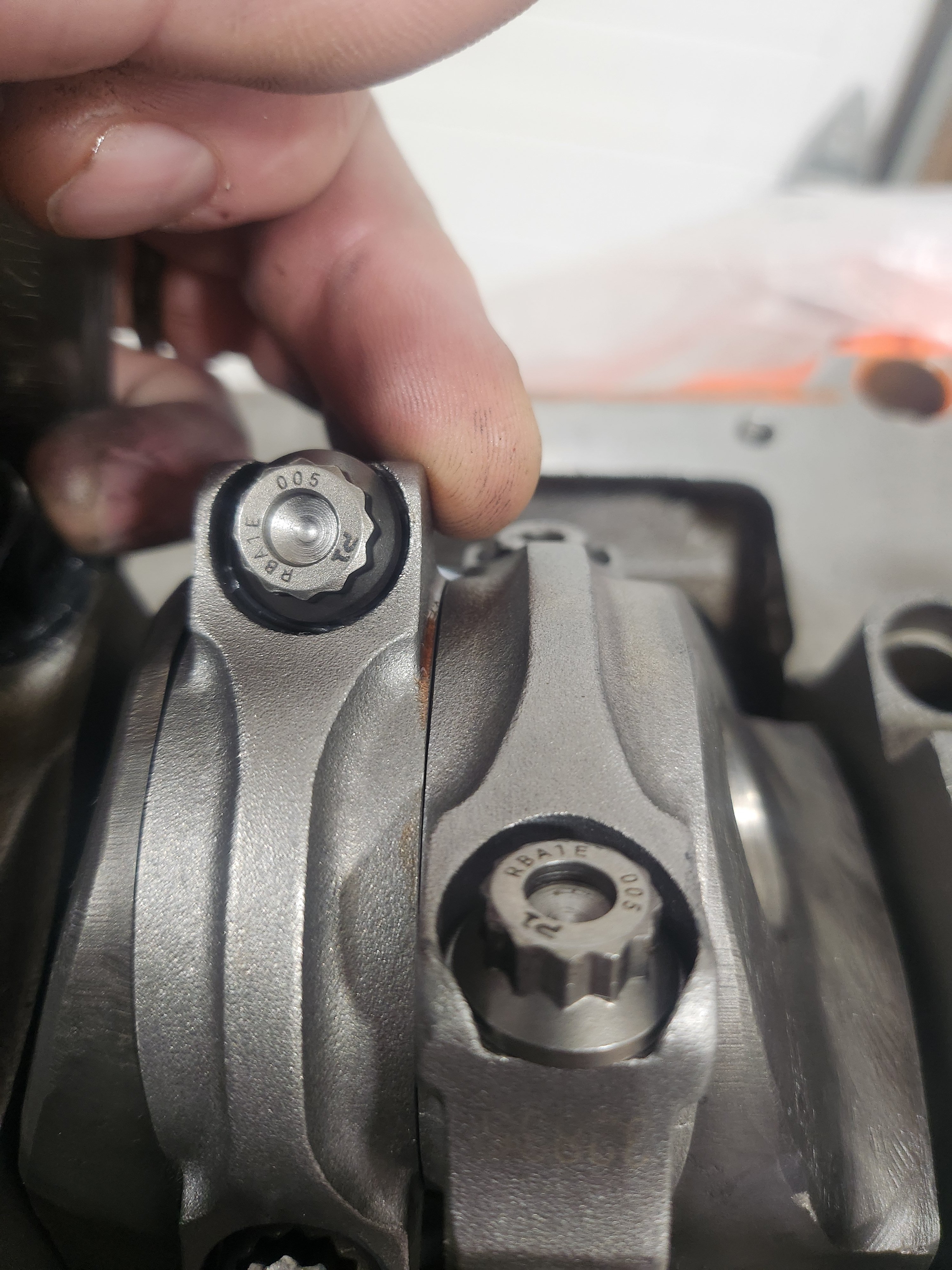

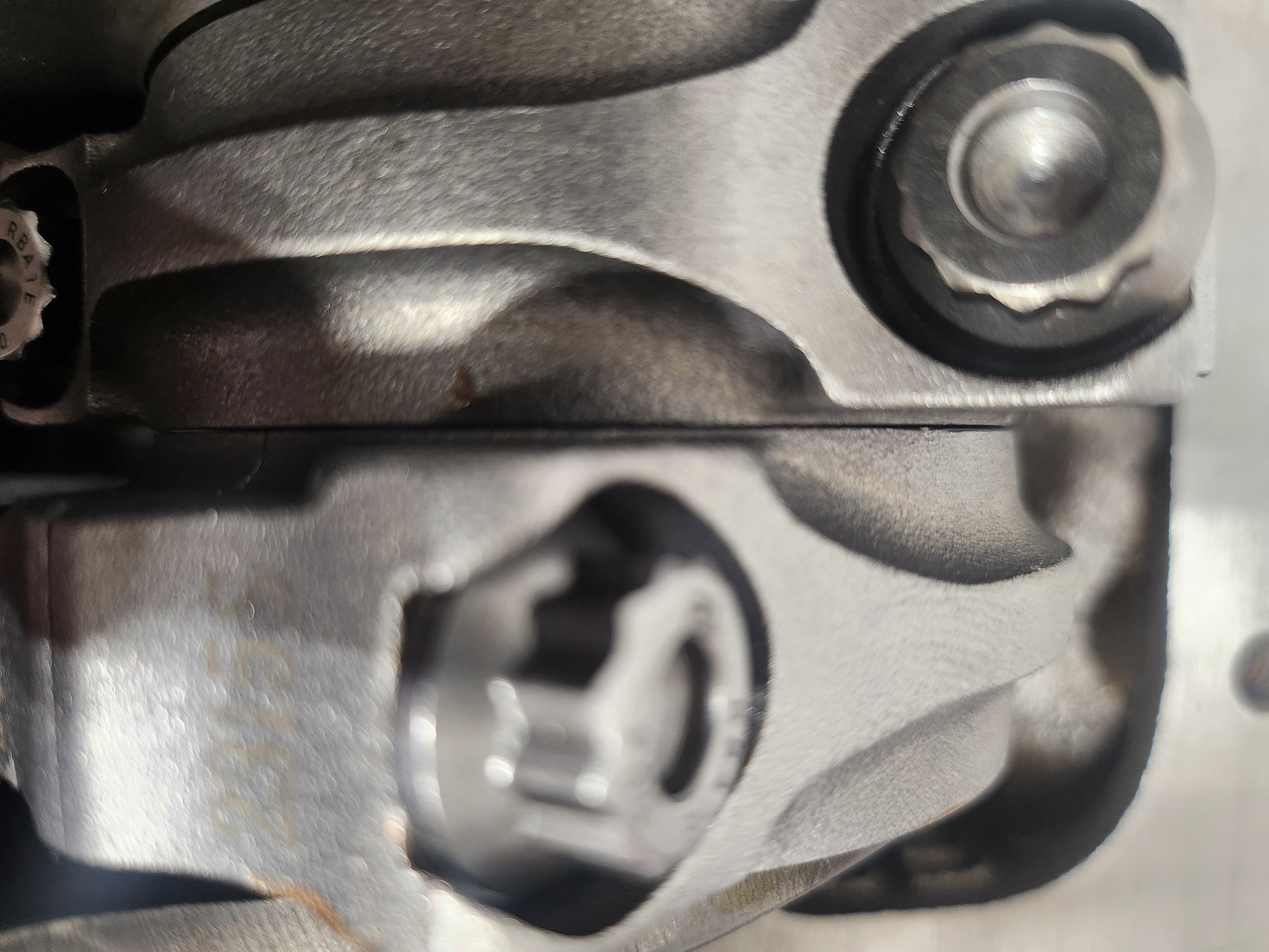

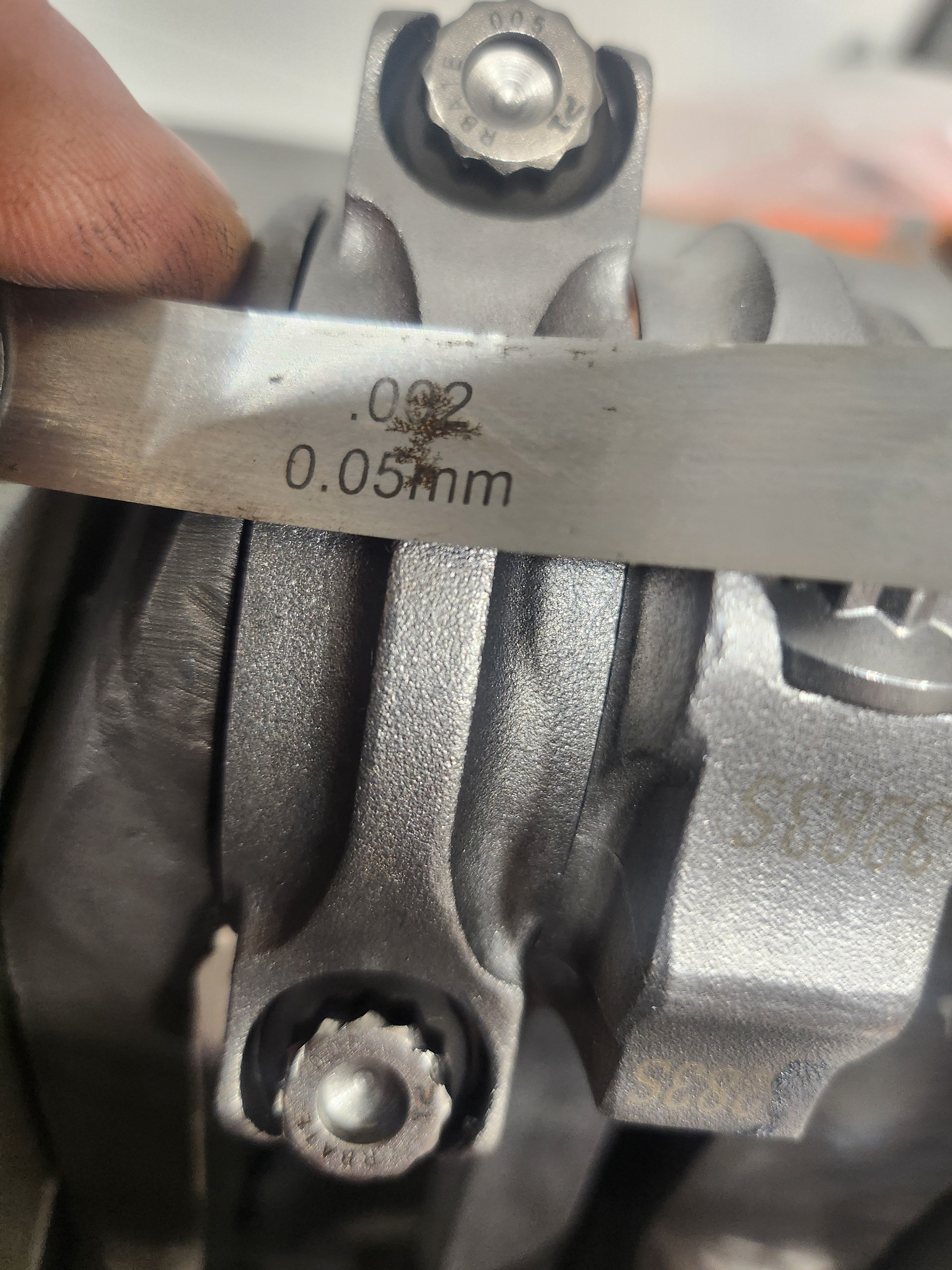

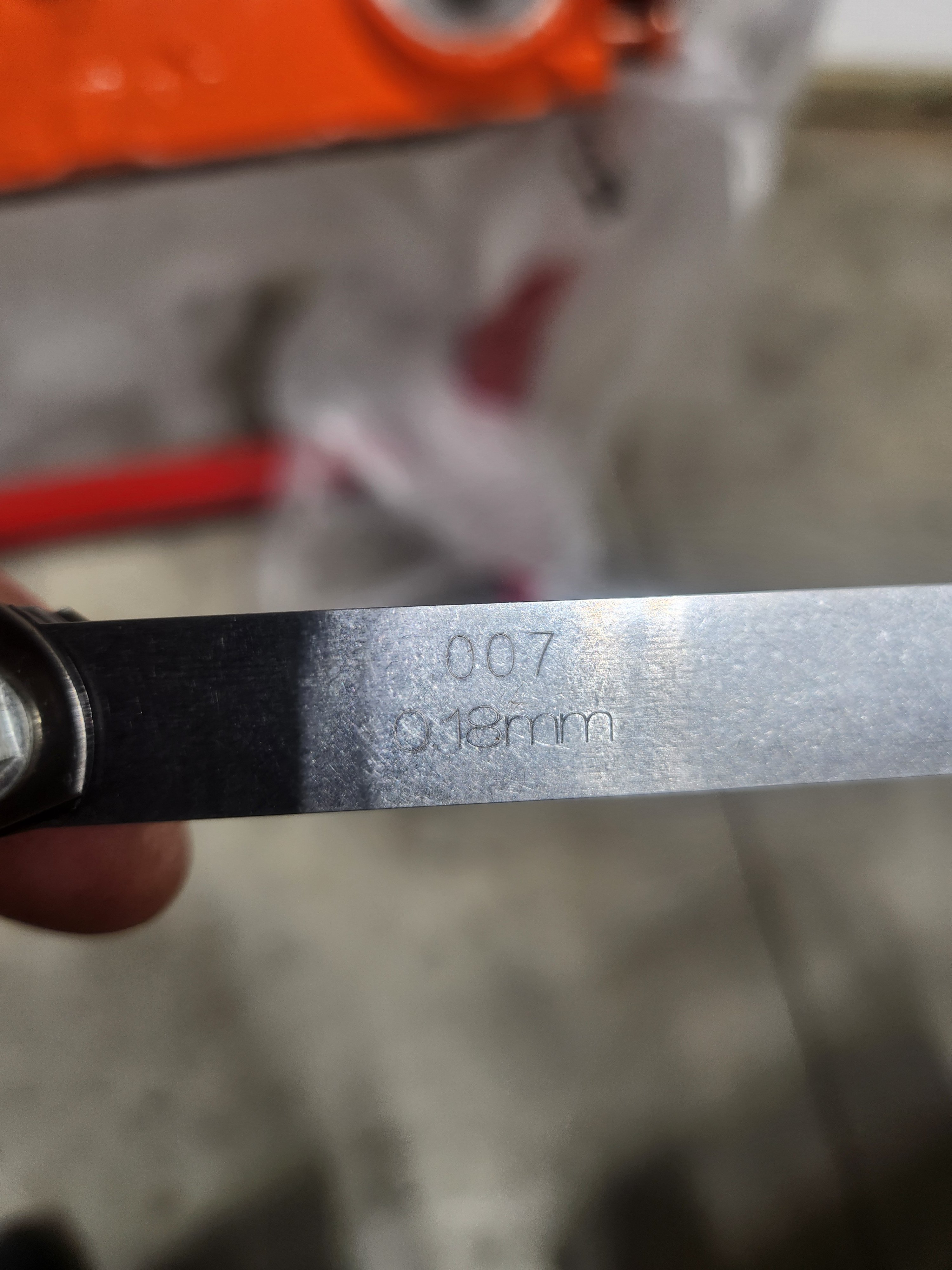

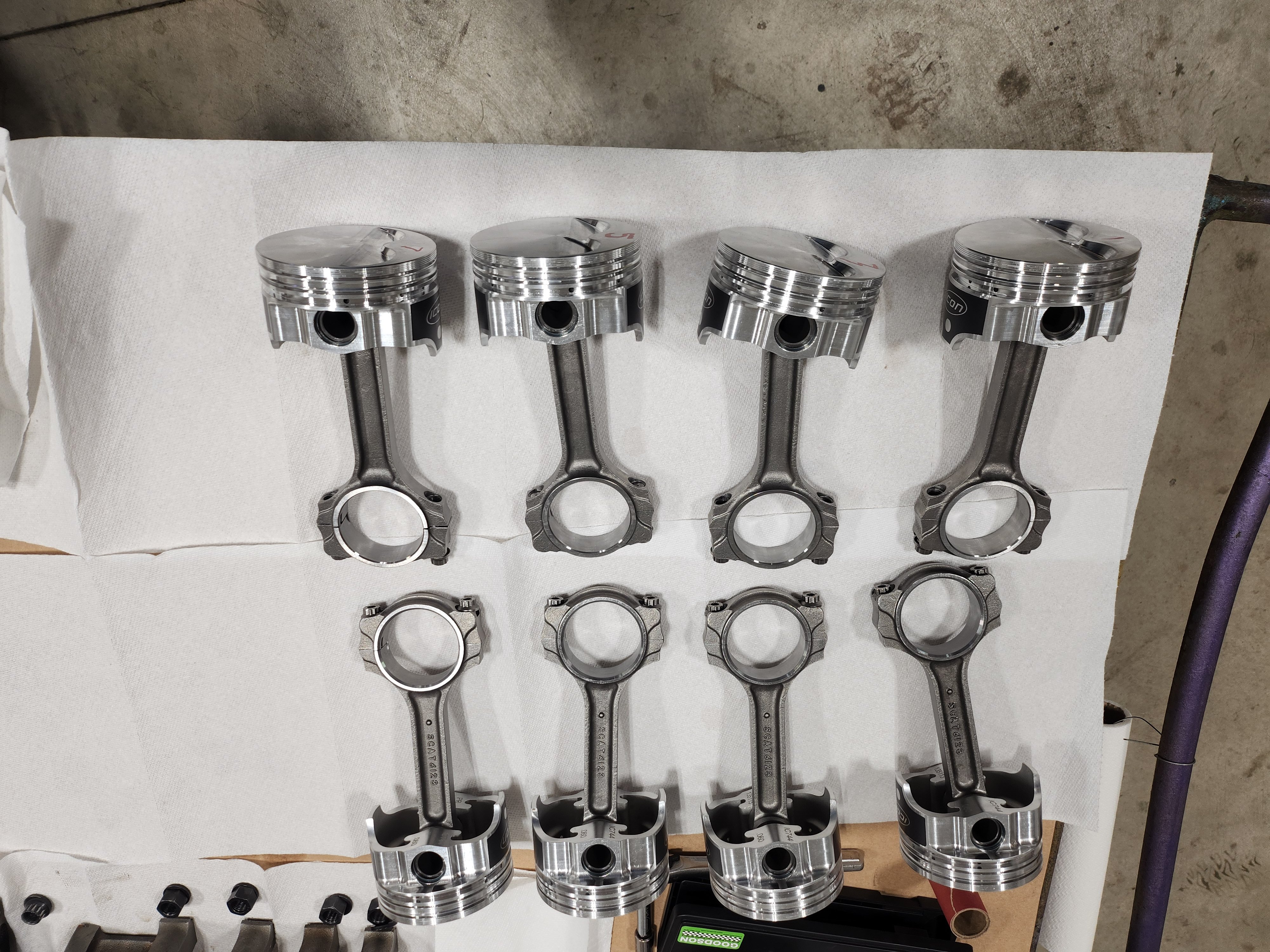

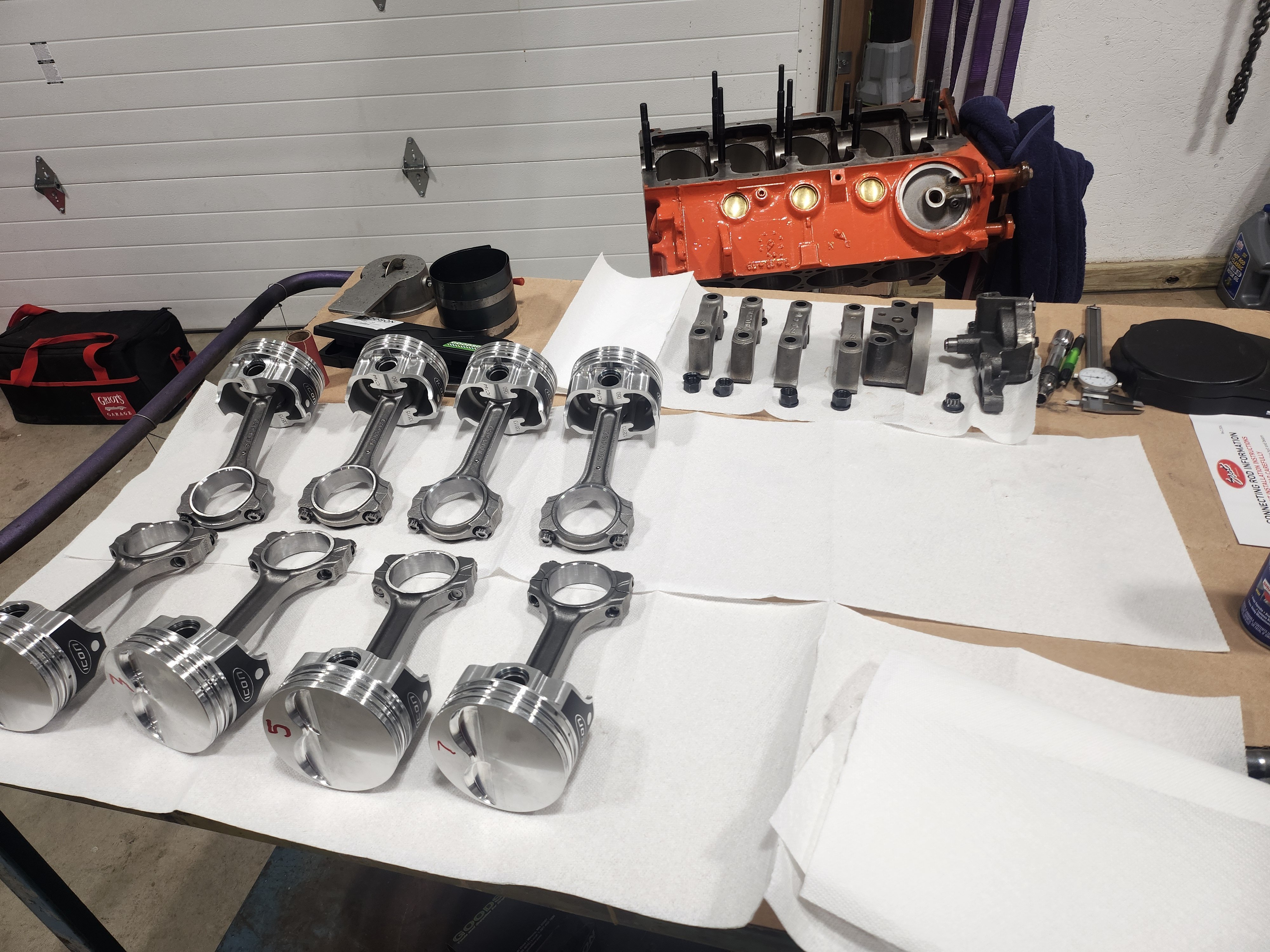

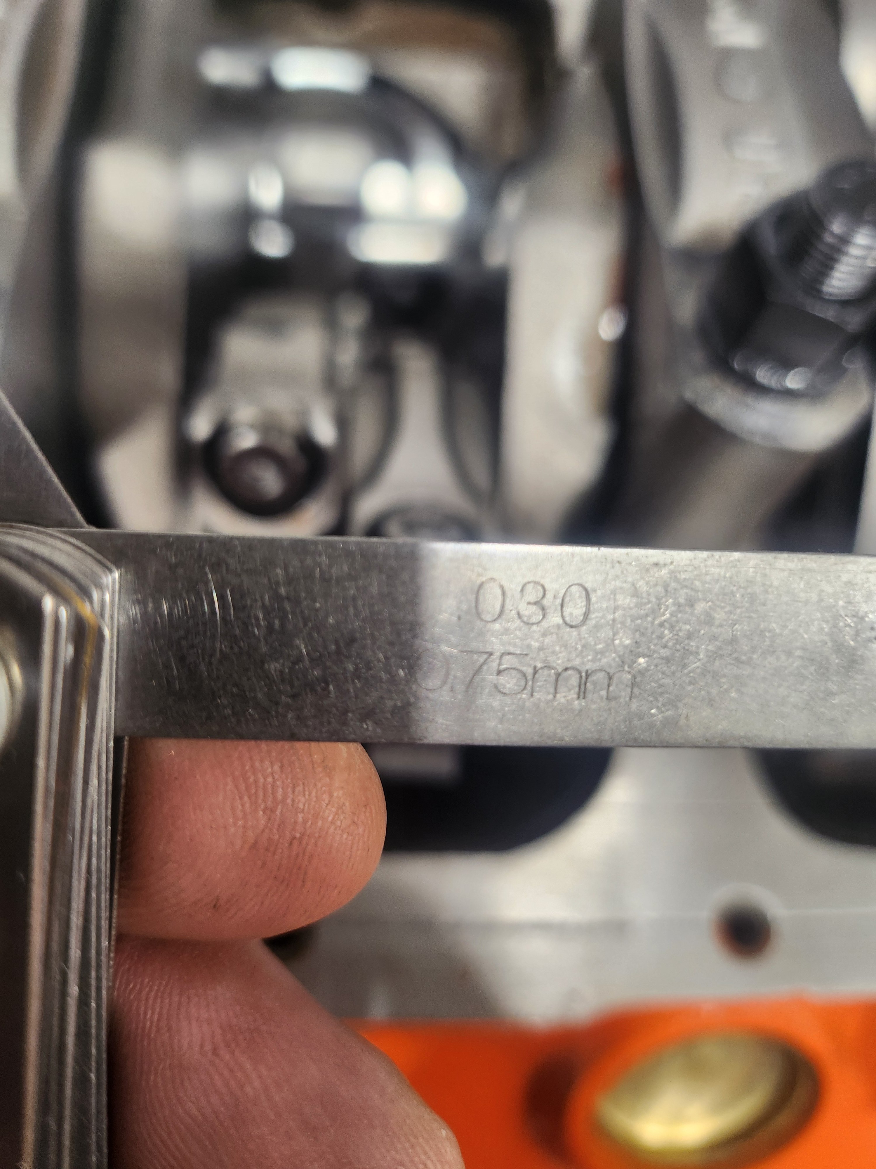

got the 4 corners in deck height is super close to flush I'd say flush on #1 and #7 maybe .010 below on #2 and # 8, gonna install all of them, before ring install, John has a straight edge he's gonna bring over later and see exactly what we have. rod clearance in between on the crank seems to be pretty tight, moves freely but doubt i could fit a feeler gauge inbetween. looks like plenty of rod clearance to the block at the bottom of the cylinders, so that should be good. Had an issue with one of the piston clips, kind of waffled one, got it in and looks like the rest but for the price of a clip its not worth the risk.
