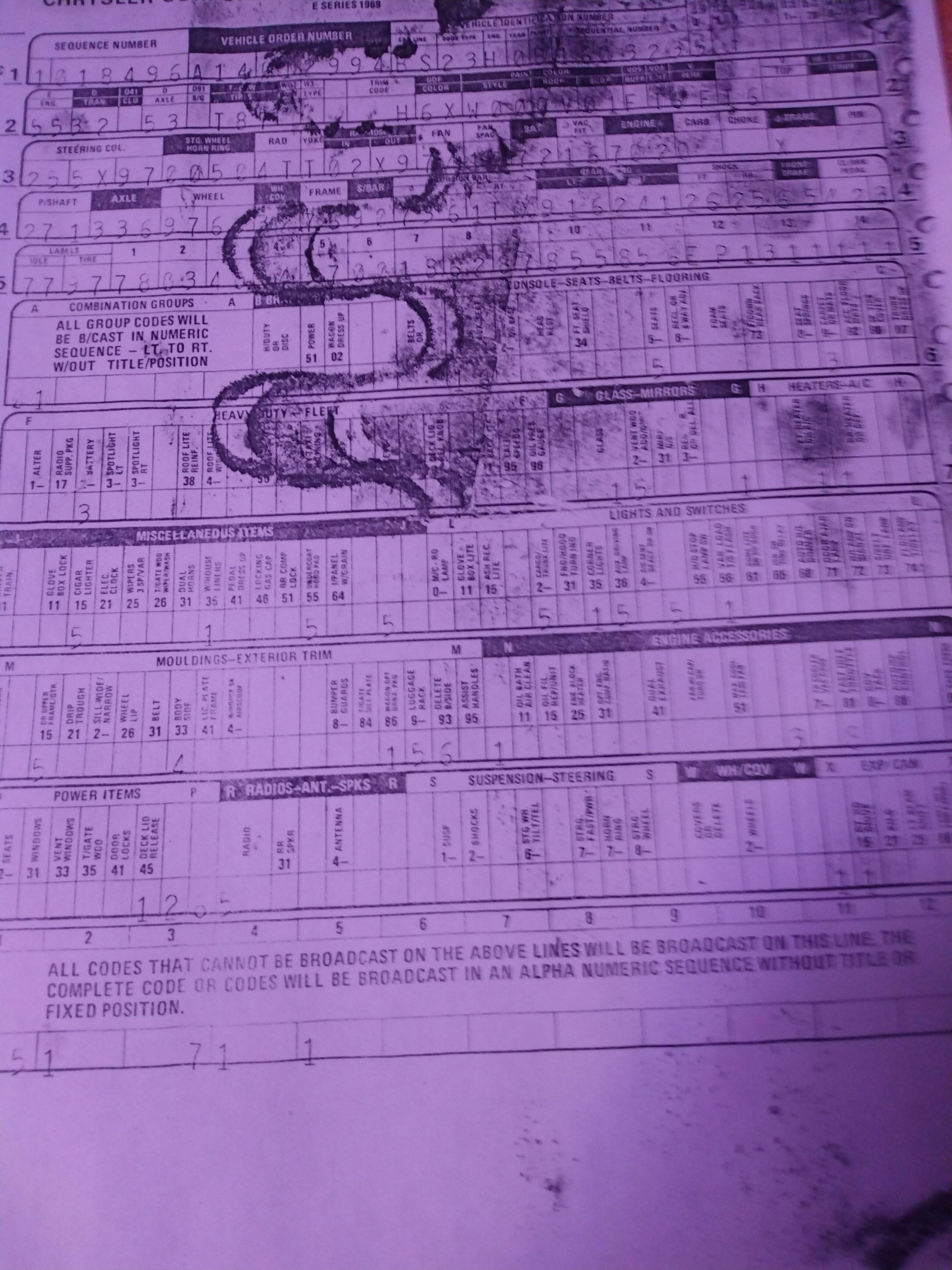

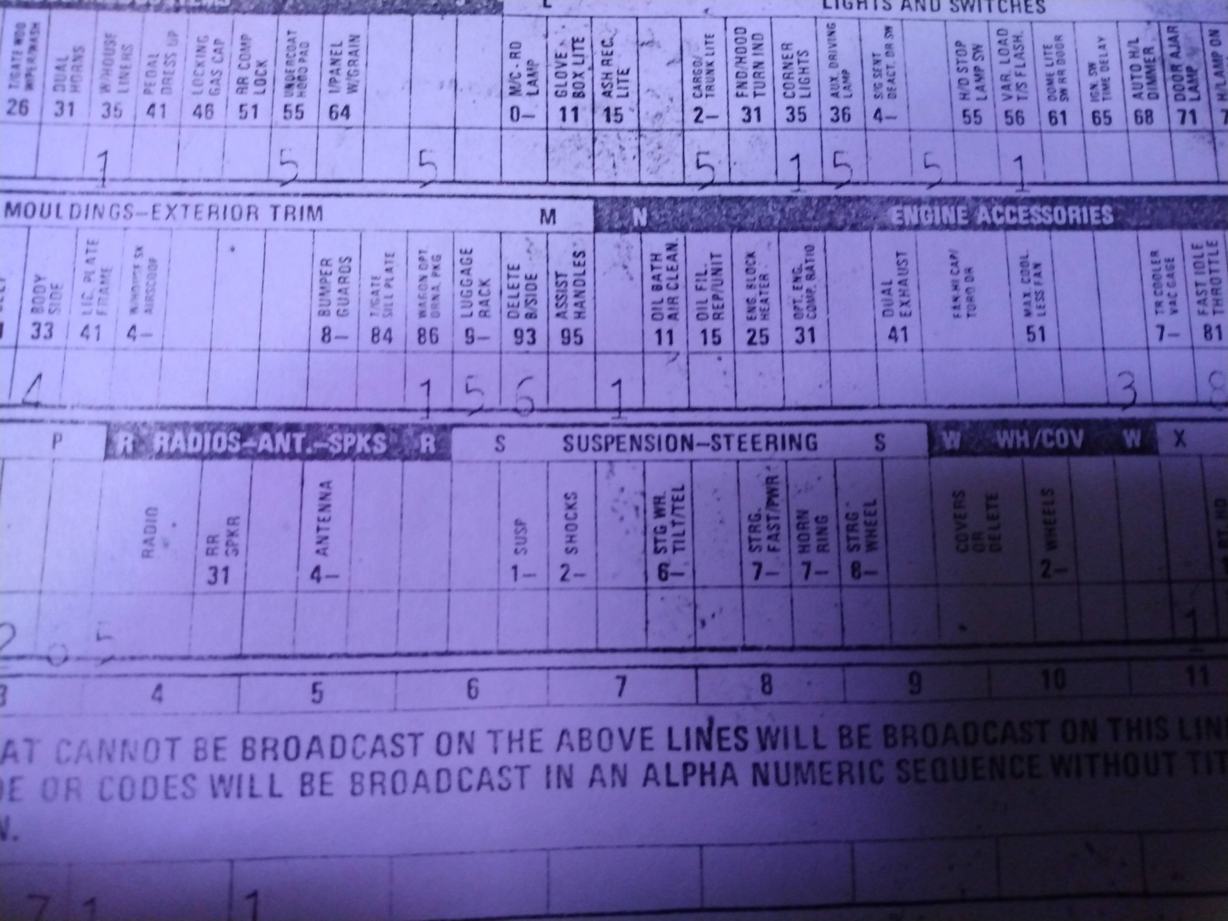

I'm just assuming/guessing, so a build sheet would be the only way to see what the car came with?
This is only information I'm curious about. I don't have any build sheets for my cars.

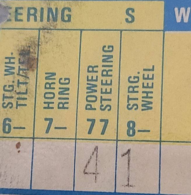

Trying to do some research and came across this post. I'm still just a bit confused. My build sheet for my AAR has a "4" typed into the box under the power steering "77" so would this be for the Quick Ratio PS or just regular PS? I do not have a TA box in my AAR so this is why i'm researching. Thanks.

I have several sheets with 7 in the power steering slot. So 77. Both 70 and 71.
Only one AAR or T/A with the 4.
Will continue to look.
@Mesmerized63 Is your build sheet anywhere on line for viewing?

I have numerous broadcast sheets for A53 Trans Am package Cudas and Challengers showing manual steering (no numeral in the S77 box), power steering (7 in the S77 box), and Power Steering Quick Ratio 12:1 (4 in the S77 box).

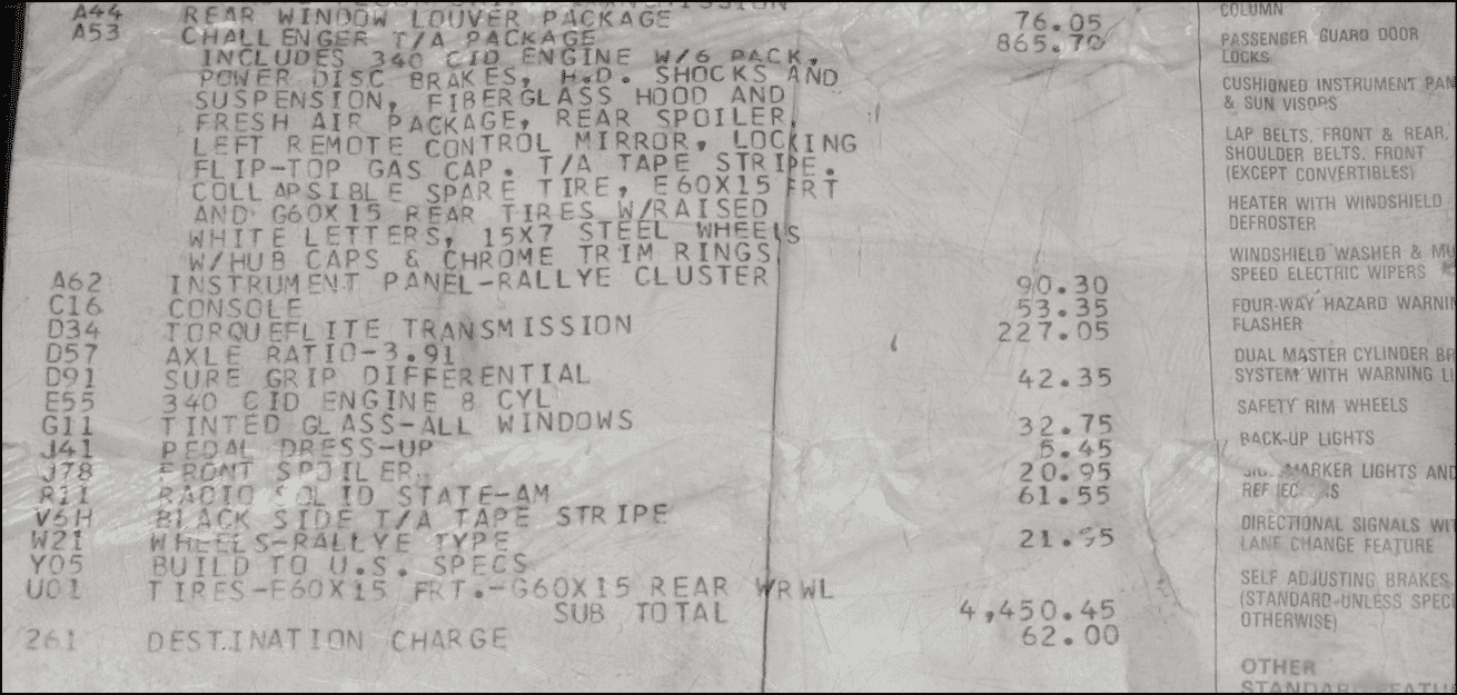

Here are two T/A window stickers. Curious enough, the Trans Am package cost $865.70 while a 426 HEMI engine cost just $778.75 in a Challenger. The A53 package was called out differently on AAR window stickers. The BS23 model became PLYMOUTH AAR CUDA-2 DOOR HARDTOP at $3,966.00 and the the A53 code showed no cost but was essentially $802.00 more than a comparable BS23 PLYMOUTH CUDA-2 DOOR HARDTOP at $3,164.00. The HemiCuda option added $871.45 to get the 426 HEMI engine.
No S77 or S74 which is standard manual steering for this Challenger T/A.

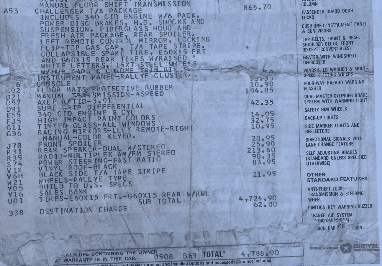

S74 code for POWER STEERING-FAST RATIO on a Challenger T/A.

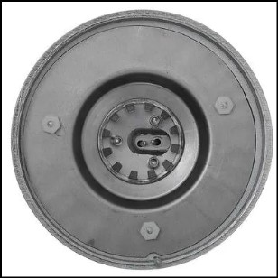

The center cap simply pops off. It has a circular portion with twelve (12) individual spring clips that retain it on the horn adapter.
Here is a video showing disassembly of the steering column.
The below center cap is for an S83 - Rim Blow steering wheel but the retention is the same for the S81 - Standard Woodgrain three-spoke steering wheel.
