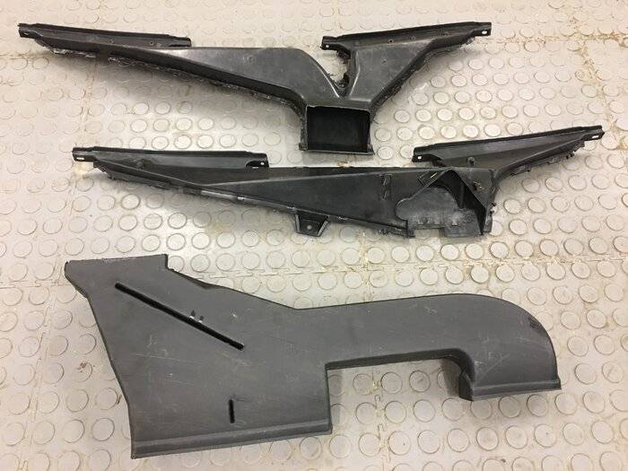

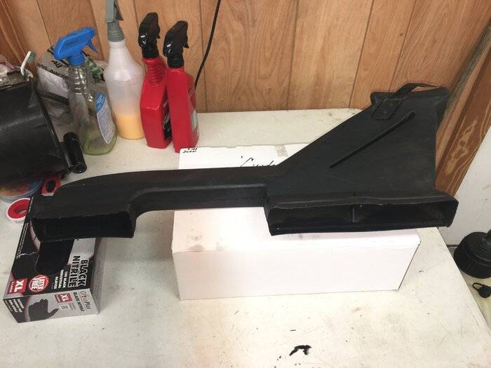

I’ll get the trim boxes down and see what I have left. It may be tomorrow evening ok.
fasjac
Dec 27, 2019
2,466
1,241
Arkansas
Here’s what I have that’s pretty good stuff. I thought I had a couple more but, that’s all. Anyway, see if you need anything and let me know. Cheers!
