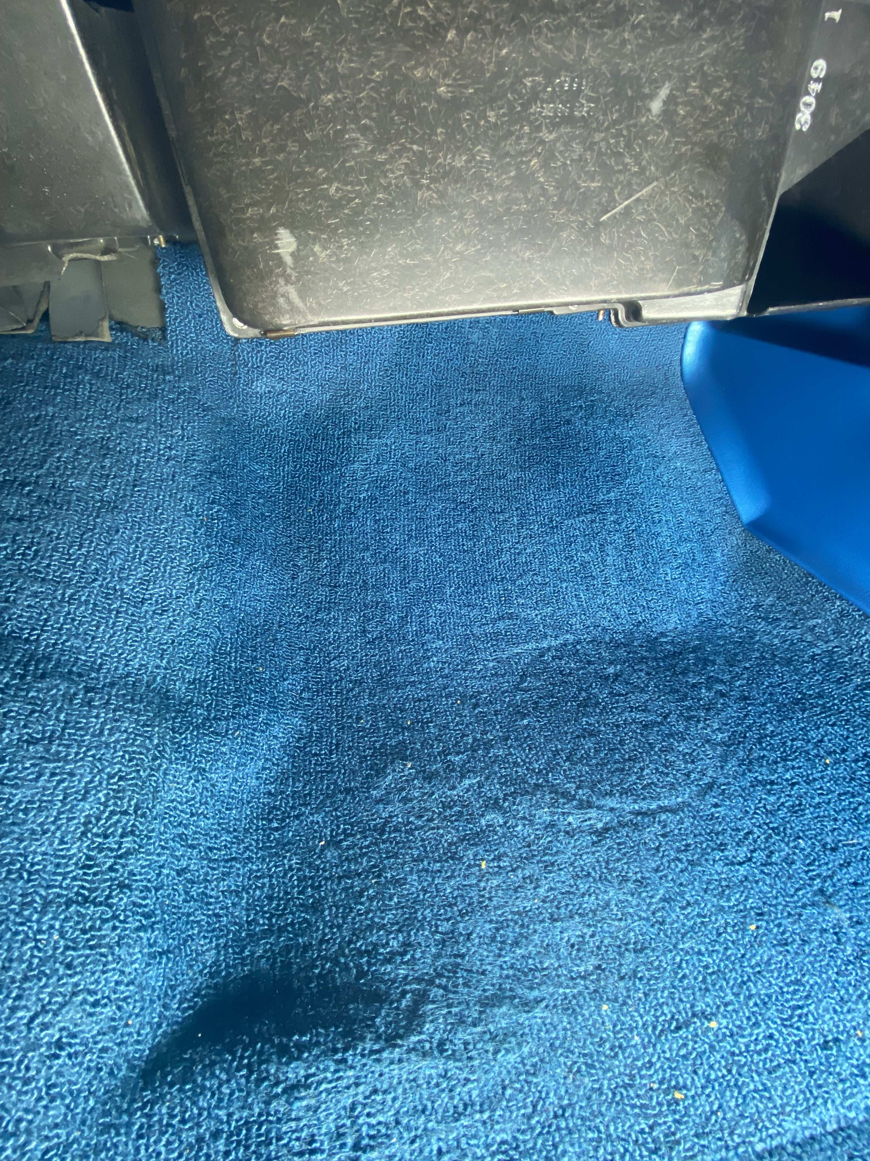

In an interesting turn of events, I found out I have to replace my heater core today in my 71 convertible. I had given you insights in posts #5 and #16. I recently had my car stored up, on my 4 post lift. I removed the 71 hardtop I had under the lift and lowered the convertible down to the floor. I looked in and I see a few papers I had on the mat on the passenger's front floorboard are wet. I look at the heater box and yes, antifreeze has been dripping. Fortunately, most was on the vinyl floor mat and absorbed by the papers. I had a spare rebuild kit for the heater box. I had to remove the cassette player and bucket seat. I will now get to do my 4th heater box rebuild. Fun. Having the lift is nice to drain the radiator and unbolt the seats. Oh well. I'm glad I caught it before it became more serious.

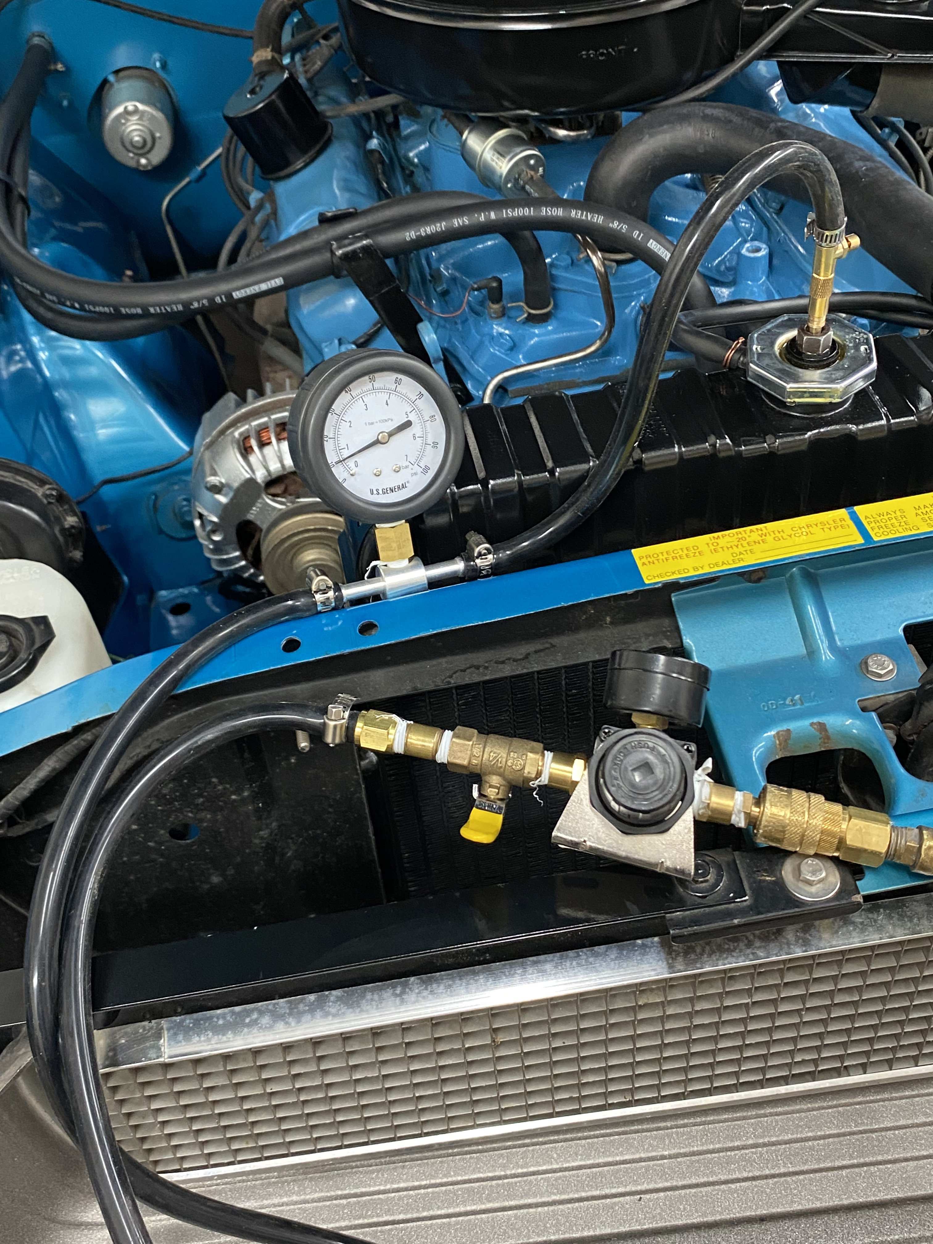

Yeah. glad you caught it early and while the car was stored. Nothing like getting 16psi behind the coolant and watching it spew out all over the passenger side while you're rushing to get home.

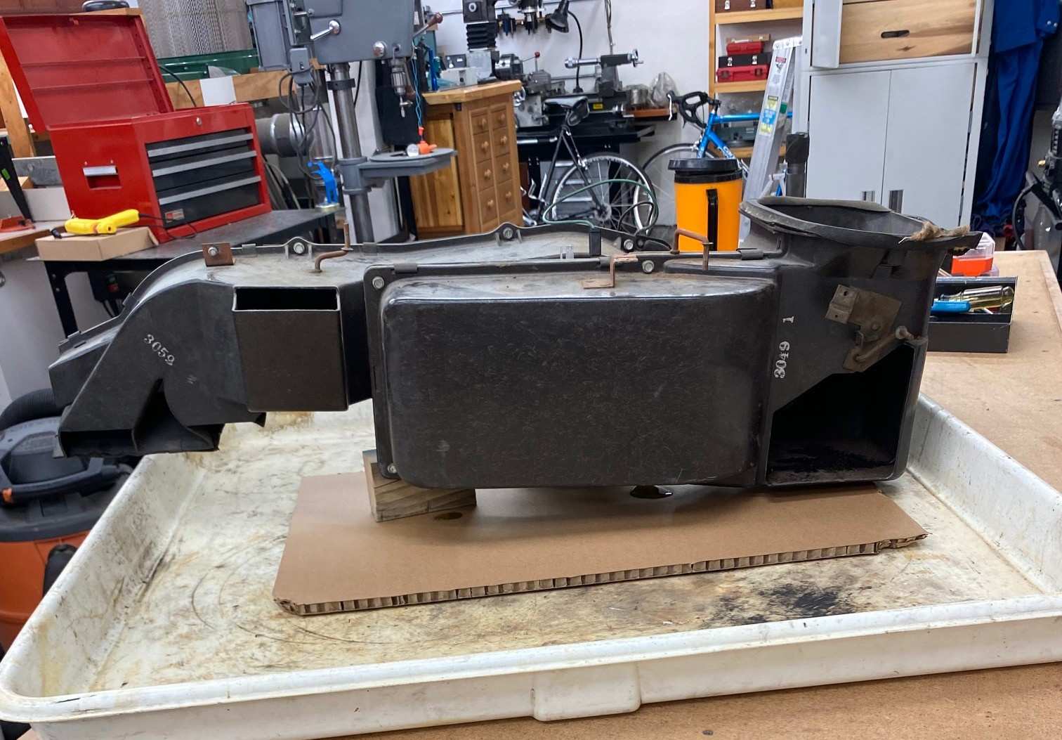

I didn't realize until last night that my heater box had been out before. I found that the heater core in there was an aftermarket core - it didn't fit well or wasn't lined up in the case properly. I have owned the car since 1972 but my parents stored it and occasionally used it from 1975 until 1980. It seems during this time there was a heater problem. The car was in a cold climate (Ohio and northern Utah). Anyway, whoever took the front case cover off to replace the core didn't know how to remove the clips holding the front case cover to the back half and broke a couple of small pieces from the cover which I'll have to repair. I've tried different brands of brass/copper heater cores before and didn't have problems. I'll let people know the one I install and how it works. I usually get them to fit well with some trimming. I saw your other post of getting one to fit. I'll answer over there. Here's a photo taken today of the 71 heater box taken apart and the one from my 72 Challenger in front which I'm working on.
Terry W.
