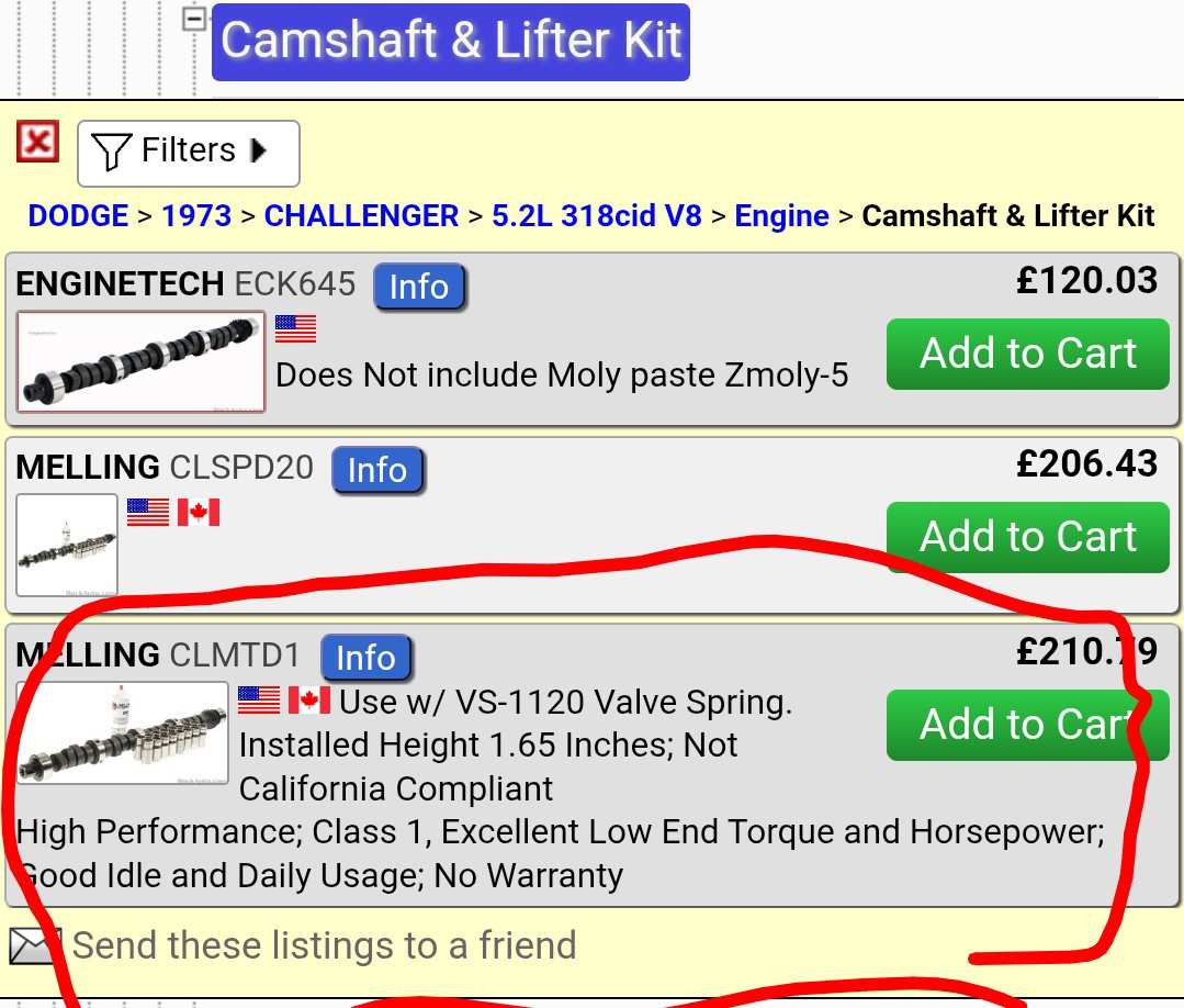

Hi all, I want to replace the whole lot cam/lifter/rods.
I'm considering this Melling since it says it brings a bit of performance. The engine is standard with 4 barrel.
The reason I'm considering items from Rockauto only is because they are very straightforward to send items to the UK. I can consider other places but it's usually more expensive and more hassle to get it here.
Well, here's the question: It mentions "use with VS-1120 valve spring", does that mean I'll have to replace the springs if I go ahead with this cam?
Also, would I need any other rod length or just standard ones?
Thanks for your help. As mentioned, it's easier for me if we can stick to Rockauto options, but happy to consider others places/brands.
Thank you.
Most manufacturers will recommend a matching valve spring to your camshaft depending on lift and duration when more than your stock springs will handle. Some machining may even be required in some cases as well.

So it doesn't matter which one I buy, I'll have to check the whole lot regardless?
Might just replace lifters and rods of the cam is fine.
Why are you replacing the push rods? Or just the lifters?
Lifters in particular have been very hit and miss in quality for years now. LOTS of cam failures due to poor quality lifters. Even the major cam grinders have had problems finding good quality lifters. Personally, I only use the tool steel lifters, but they are EXPENSIVE. The only real reason that I use them is because they are consistently good quality pieces with the correct face that contacts the cam.
The proper pre fire-up preparations and break-in are absolute musts. There are procedures that significantly reduce the chance of a failure. DO NOT just drop lifters on the cam and fire it up!
And if the cam manufacturer recommends a spring change, I would follow their directions unless you have reason to believe that your springs already meet their specs. The springs can typically be changed with the heads still on the engine. I doubt that springs this mild would need additional machining to install.
