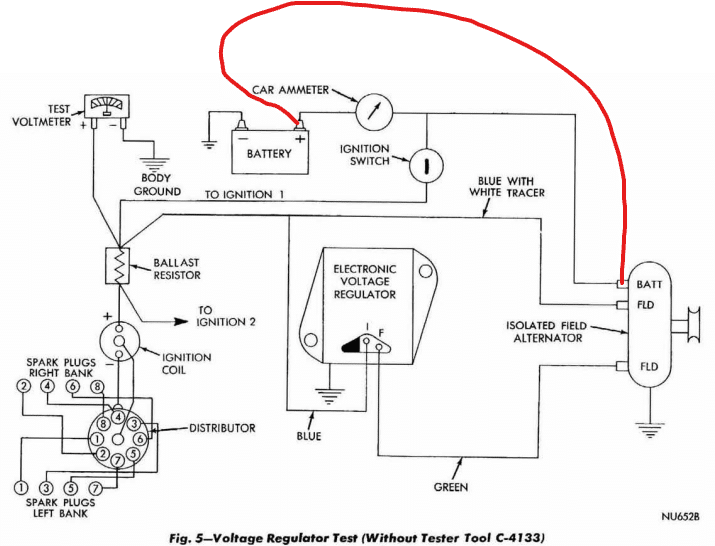

This is too much work for me to understand. I really want to help you not fry your wiring and/or other elements of your car. If you could show me a wiring diagram of what you connected, it will be easier for me to understand.
I think you are saying you left the charging wire (shown in RED in the image below) from the alternator BATT still connected to the battery POS, but also connected the ammeter to the BAT, is that correct?
Sorry it may be difficult to understand me because I am French.
Yes, This is what I did for the first test.
After that, I just disconnected the black and red wire behind the Ammeter, and tied them together (to avoid burning the ammeter), but it didn't charge like that.

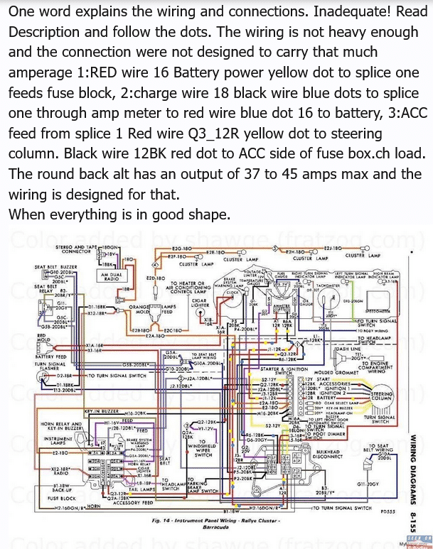

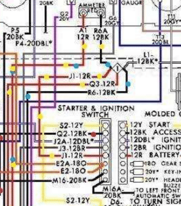

When doing an alternat Alternator feed to the amp meter.
It would be advisable to abandon the feed from the alternator R6 12BK, ( Bulkhead connector 18 ) and use an alternative way of feeding it. That being the feed to Splice 1 from where all loads are feed from the alternator feed.
An alternative feed can connect to the back of the Amp gauge. R6A stud. The original wire in the dash harness can be left in place providing 2 things. 1 The wire is in good condition and didn't melt any other wires in the harness. ( disconnect from amp meter and heat shrink) 2 The original feed from the alternator needs to be disconnected at the alternator or bulkhead connector.
In theory this would be electrically the same as stock, feeding the loads from the alternator to spice one. Just not going through the bulkhead connector.
The alternator feed was never fused. As said before the diodes would blow. But why take a chance. Place a fuse on the back of alternator or elsewhere.

As for the A1 12R circuit, Bulkhead connecter 16. Feed for maintaining state of charge of the battery and feeds loads when motor not running.
It can be bypassed in the same manner. connecting A1 12R side of the amp gauge to Keeping the provisions in mind from above. Bypassing the bulkhead connector.
(disconnect A1 12R from amp meter and heat shrink)
