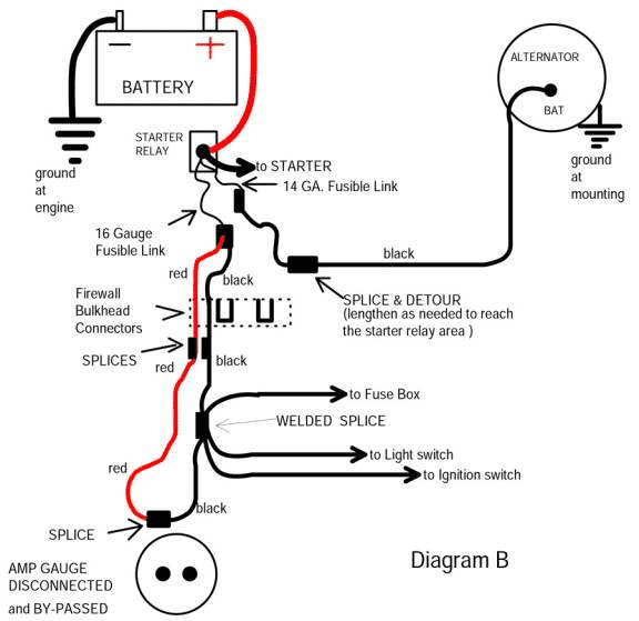

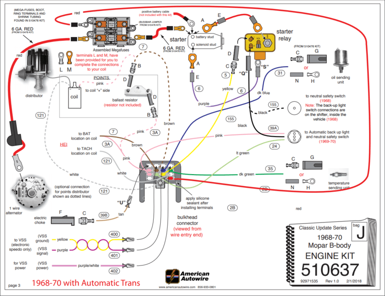

If you are going to do amp meter bypass.
Bulkhead and amp meter bypass.

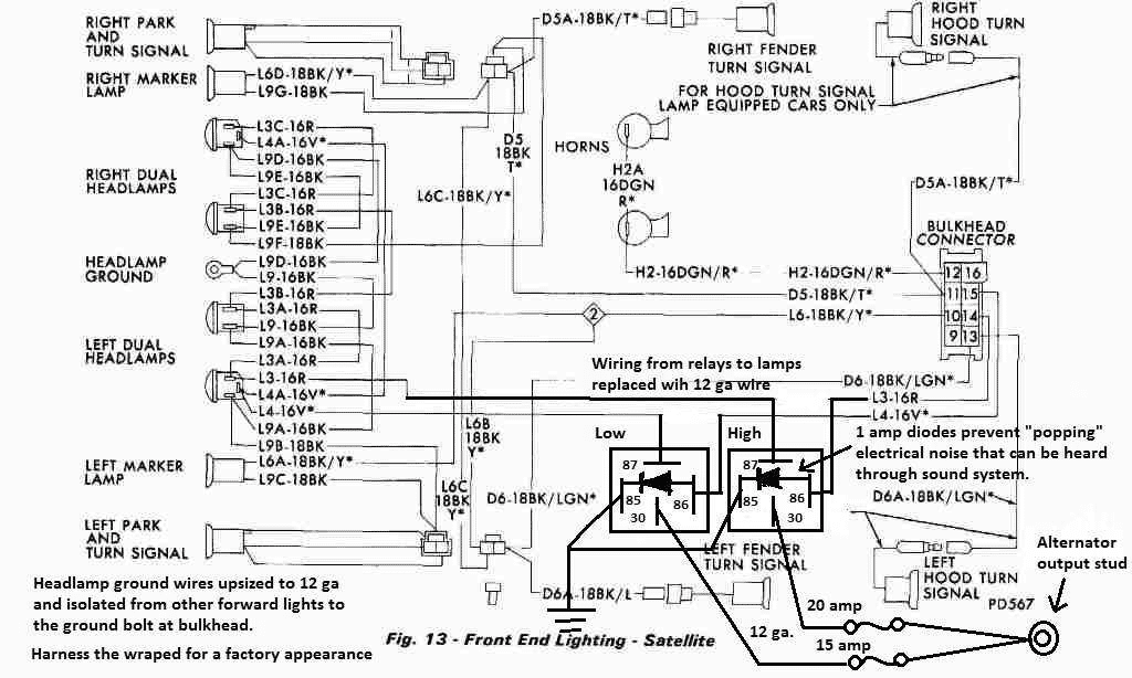

Here are some examples of what can be done. Not saying what is correct for your application. Connecting to the starter relay circuit is electrically the same in this manner. But the the gauge of wire from the relay is not adequate. That's why it should be connected to the starter feed or directly to the battery.

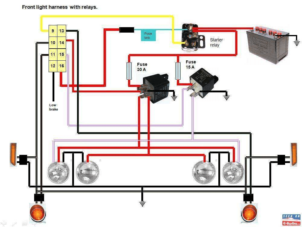

Also a headlight relay circuit would be advisable. The main point of it is that the load is electrically connected to the alternator. That being said. Splice one also has to be feed from the alternator. The alternator never was a on a fusible link that feed splice one. It would be advisable to place one there. As it was said before the the diodes would or might blow before any damage . But why take a chance.

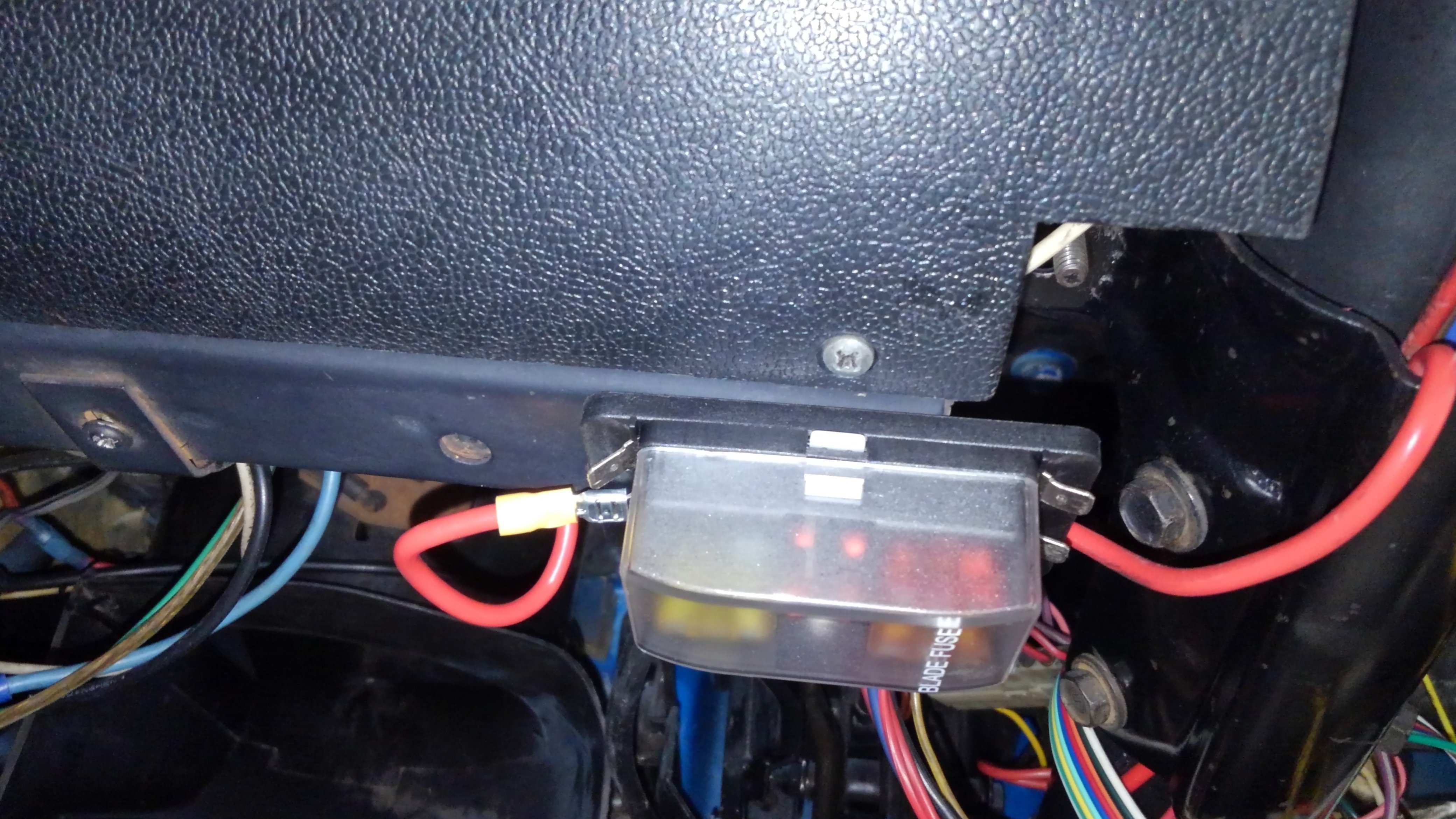

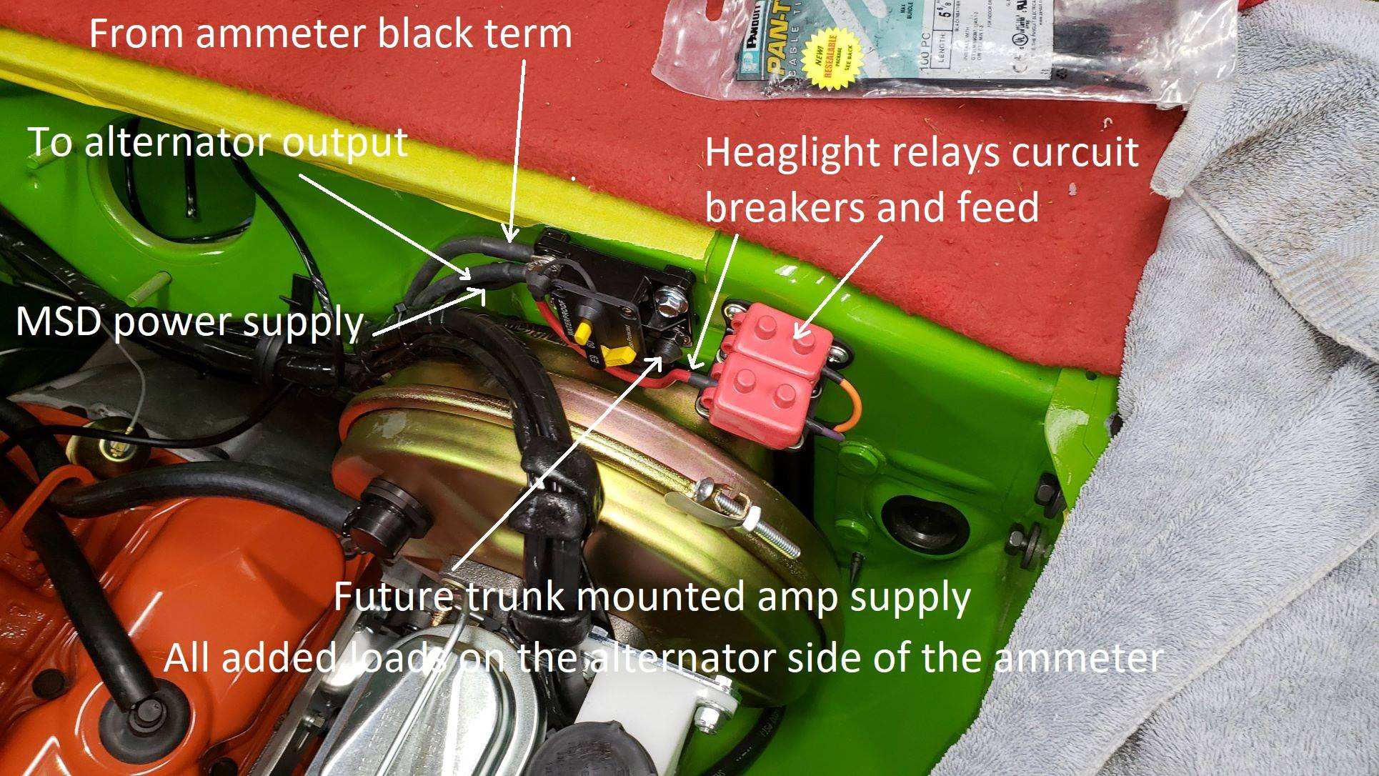

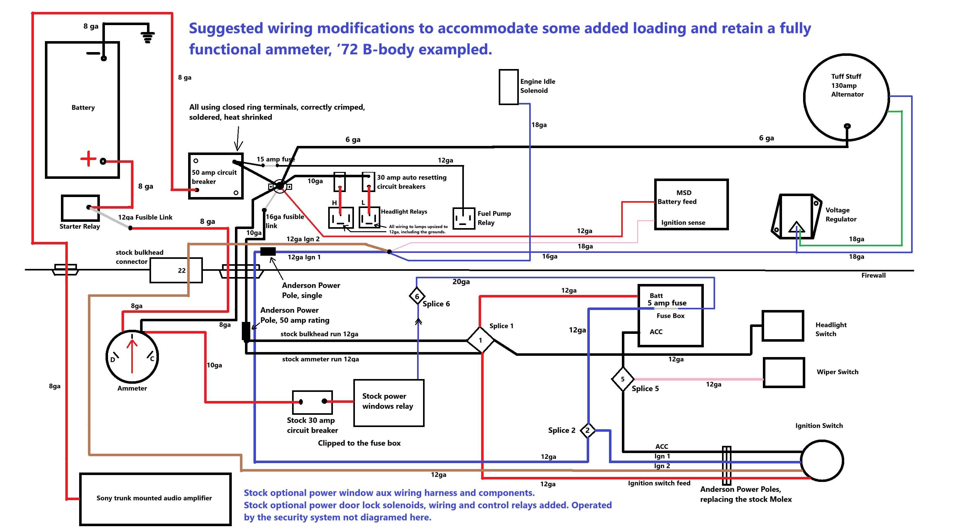

Yes, that is the current Challenger project, now in the final stages of completion. Not so much a proponent of the ammeter, more that I understand it is purpose and why it’s there, as well, understand how to maintain/service it to continue to operate within its design limits and all while running all the loading I need/want. Don’t buy into to all the fear mongering and misinformation circulating for years relating to the Chrysler passenger car ammeter.
Example of my approach to electrical for these cars these days.

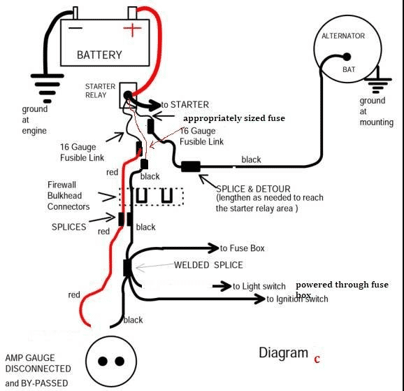

Some additional information. Take note of the wire from the alt stud to fuse and then feeds to the starters feed. It can also go to the battery when doing a complete alt bypass. This is just a generic diagram. Don't get confused by the other wiring in photo.
The stud for the red battery wire is what not to connect to. The gauge is not heavy enough. It has been done for convenance. That doesn't make it right.
