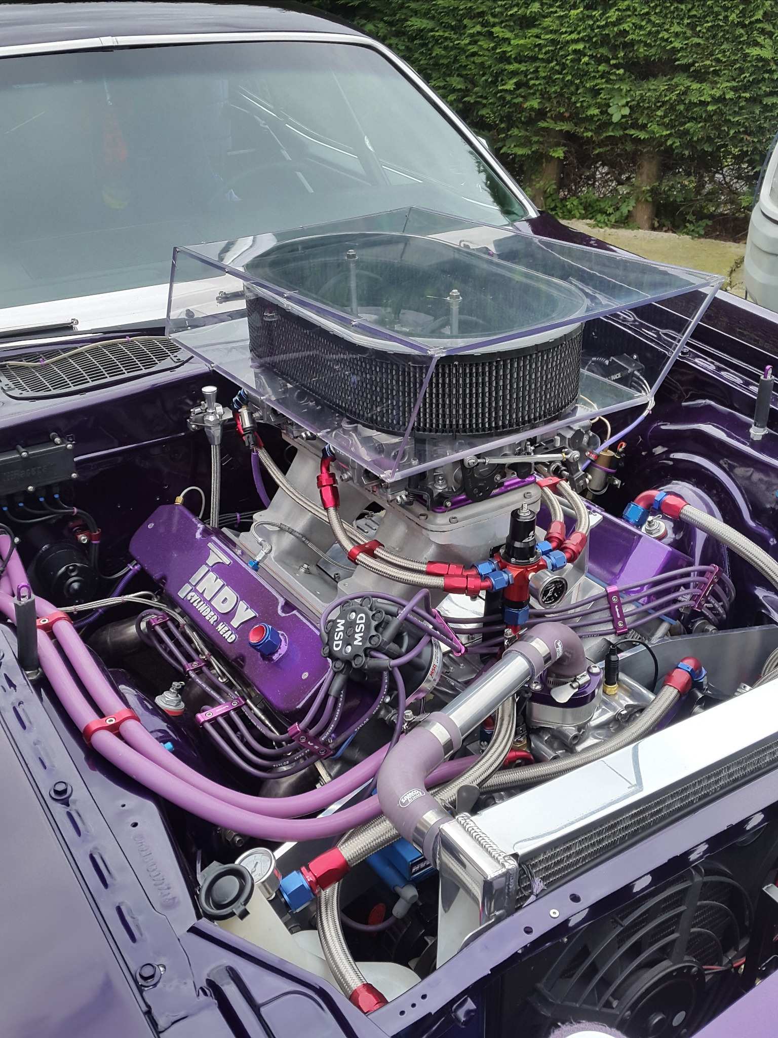

Do you know the model # for the carb ? Holley make 2 cct 3 cct, T/R and blower specific dominator carbs. TBH I think your engine would be happier with a 950. We had a similar combo and it ran best with a 950 after trying a 750 and an 850 (all D/P btw).
A point of note is the 950 D/P Holley does not flow 950cfm, it uses the same size venturi as a 750 and the baseplate of an 850 but it worked really well in that 440 combo.
You can get that 1150 carb to work but it will be a lot of trail and error reading plugs and / or fitting an O2 sensor to help. You will need to check the mixture (AFR) at different points of differing driving styles to cover all the fueling circuits. I have a T/R with 2 1150 dominators on a 580ci engine. We got them to work really well after some main jet, emulsion and bleed changes. No disrespect intended but you have to have a good understanding of how a carb works to tune one at this level, reading plugs and an O2 sensor will help.
In the scheme of things the car has only been .06 faster (at the same 142.5mph) with the T/R compared to a single worked 1050. The T/R came off our 655 race engine which we have recently rebuilt but I / we just like to set up stuff so it was fitted to a our old mule 580 engine :D
