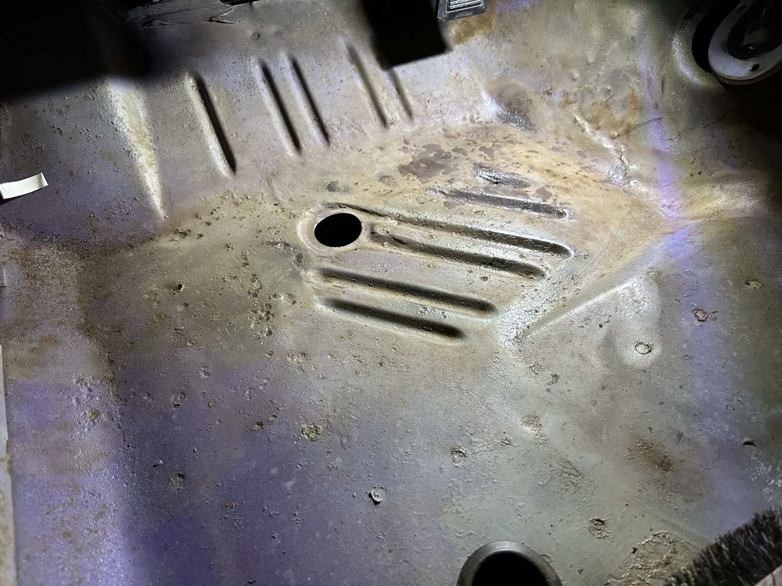

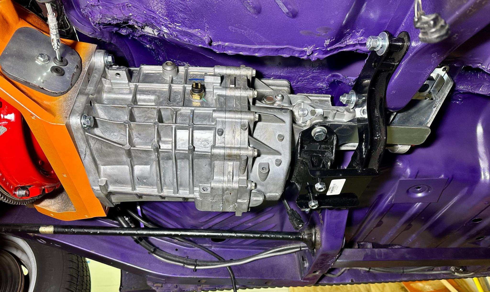

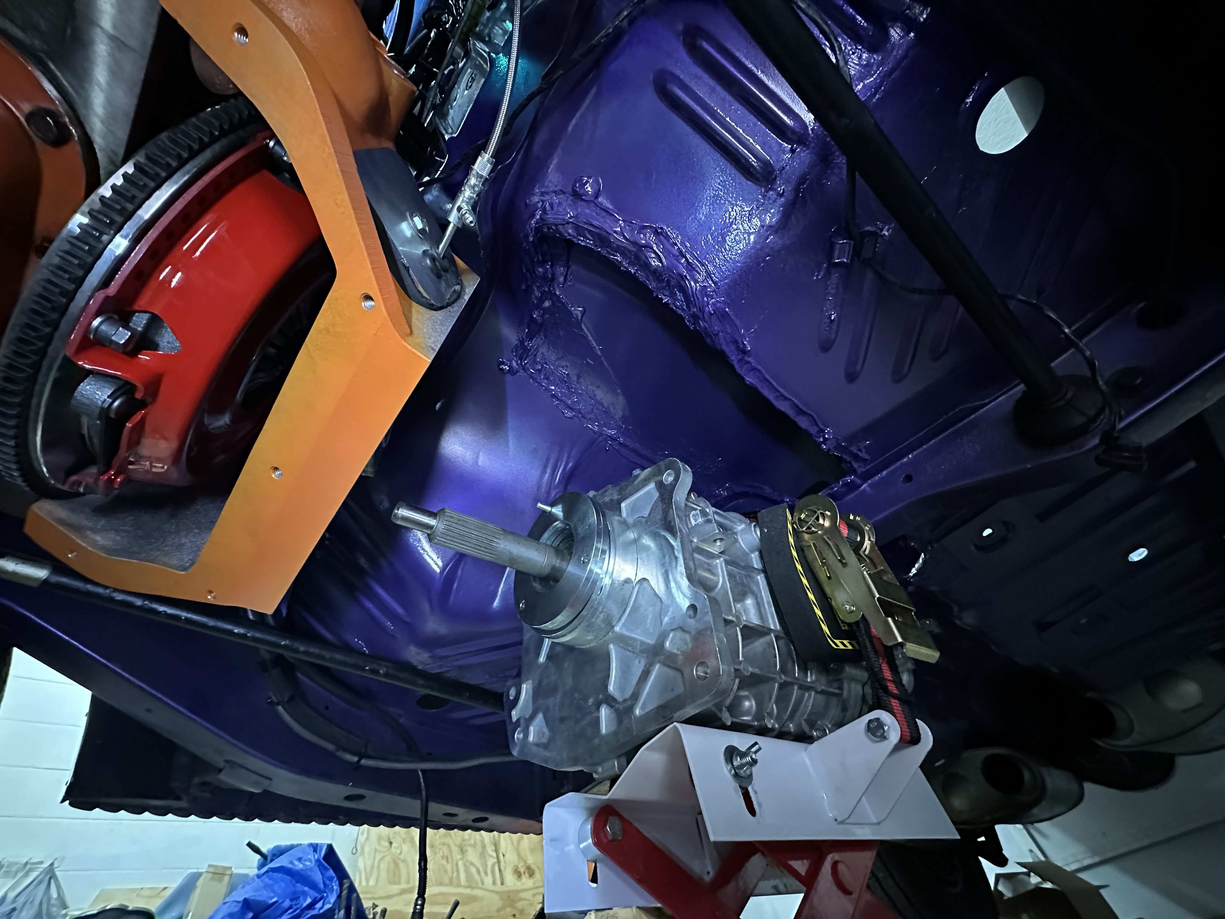

I have already finished the conversion. The TTI 3” exhaust has been on the car since 1999. TTI discussed the fitment with me before the start of this project and told me they have not changed their systems since they began selling them. I had no exhaust issues and the TTI headers fit extremely well.Word of caution on exhaust selection. I found severity of angle plus length of the Tremec on a lowered Challenger left my long tube TTIs with only 2.5 inches of ground clearance at the flange. Mid car placement left it very vulnerable to speed bumps so I changed to TTI shorties. Even then the head pipes off the shorties barely got me over speed bumps. Next step would be custom bent head pipes as there is plenty of room upwards. Might not be a problem with stock height suspensions. This is not TTIs fault but rather a trans issue that could only be solved by cutting out the crossmember that crosses over from the torsion bars. They do this on the 6spd but it’s not part of the 5 speed process.
The thread will continue but here are a couple of header/exhaust photos.
